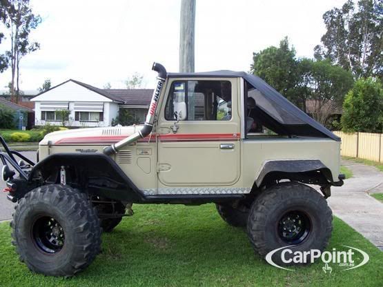

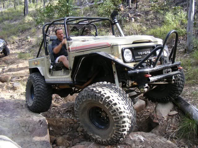

The Hilux one will look good once extended but I would definately not use it for the safety aspect (has none !!) plus I doubt any legit roady would pass it.
I have a legit rollbar & matching soft top that fits a 40, it is off mine. I no longer have an use for it as I am extending my tub.
I haven't got any pics of it with the side windows in but it also fits inside a hardtop.

That shiny one isn't a roll bar, it's a sports bar. It would offer no protection in a rollover, especially with cut and extension. If you want protection then you need a roll cage that securely mounts to the chassis in some manner. Personally I, d be taking upbrooksy offer

if yours was a pre 1979 i'd have bought it in a heartbeat, shipping costs and all. that's pretty much exactly the cage i want.
