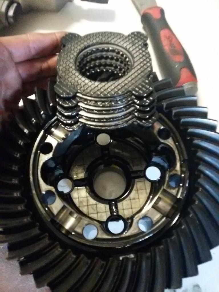

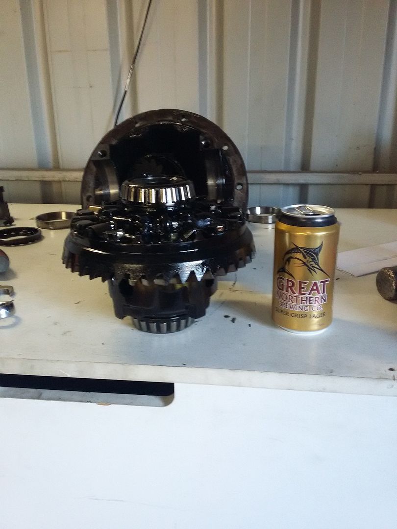

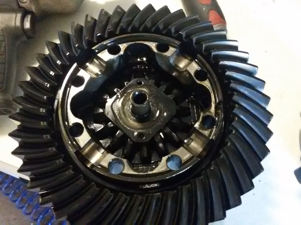

Unread post by turtl3tim » June 5th, 2016, 9:38 pm

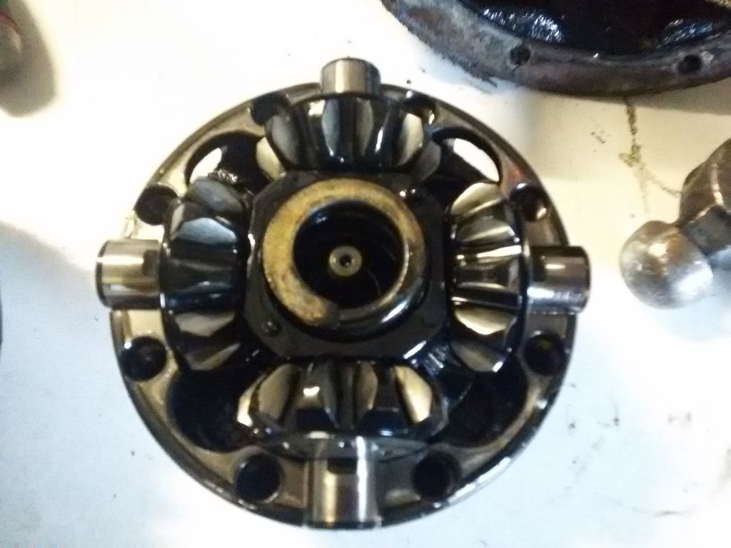

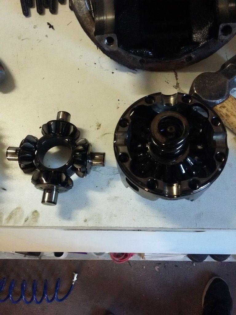

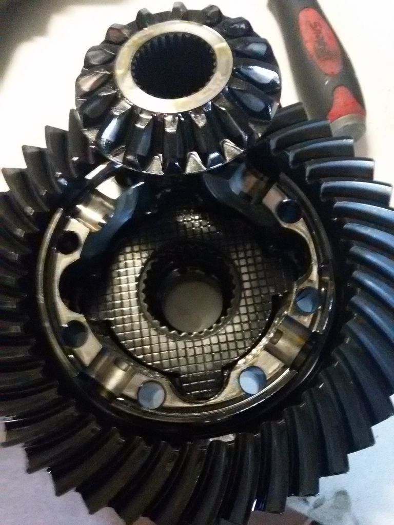

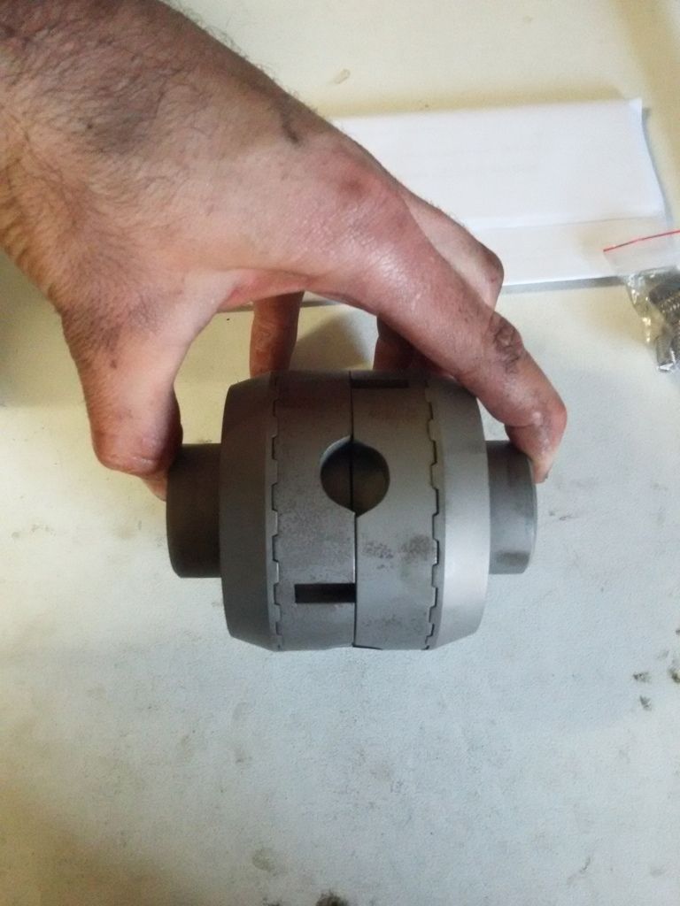

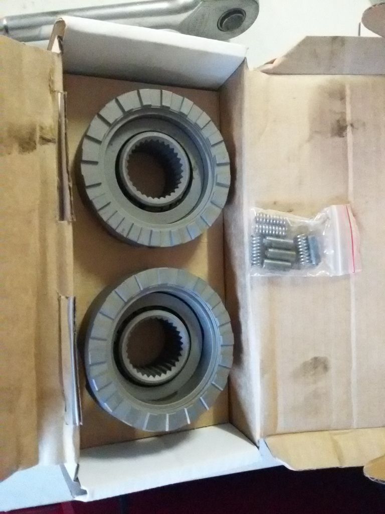

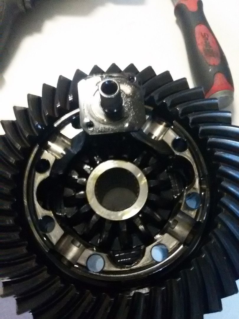

well i finally got around to getting the diff out and fitting the lokka. so heres some pics
92' 4runner, 3.0Loser manual. Custom DIYPVC snorkel. ISR mod. Hurricane headers with 2.5" exhaust, stainless 200cpsi cat and turbo muffler. TJM bullbar with hella spotties, LED indicators. 2" body lift. 15x10's 0 offset chromies, 31x10.5 a/t's. FlameThrower injectors, 7mge vafm upgrade with modified cressida airbox for snorkel, 7mge coil upgrade. Plugs gapped to 7mge specs (1.1mm). Eagle 7mm spark leads. Aftermarket a-pillar oil pressure and water temp gauges, rear Aussie Lokka

Unread post by turtl3tim » June 20th, 2016, 7:34 pm
we must be due for an update on this topic!!!. so i finally got to take my car for its maiden voyage since completing all of my upgrades and general maintenance today.
good news. the lokka works a treat. i put 85-140 penrite oil in it and it is extremely quiet. with the radio off and my window down, it was barely audible in the parking lot. a few little clicks that let u know its unlocking as it should under no load. but i really had to listen carefully to pick up on it. it locks as it should aswell, AWESOME!
now...back to the topic of whether the 3vze does infact have an issue with the efi...
it makes me sad to say yes...it does :irked: . but its bareable, it will just require me to change my driving style, rolling through corners instead of powering through them. it does exactly what the retailer advised me it would do. it kind of jumps and surges on sealed surfaces. no biggy though :thumb:
