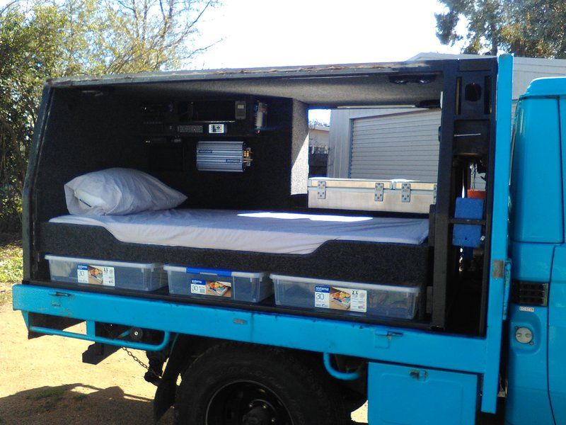

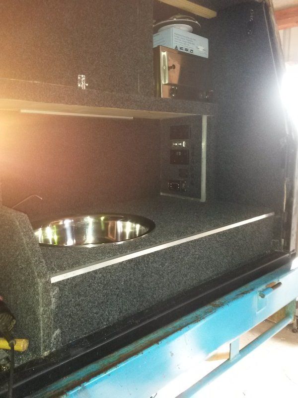

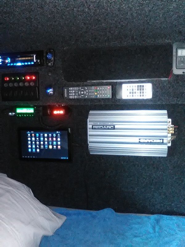

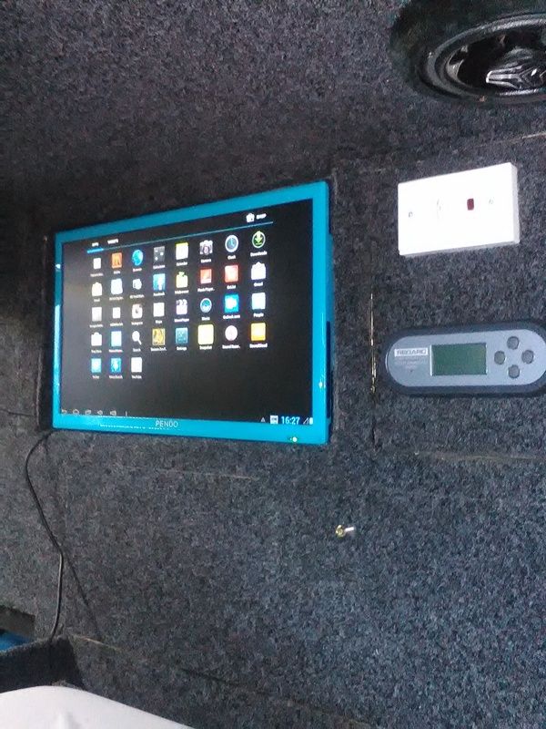

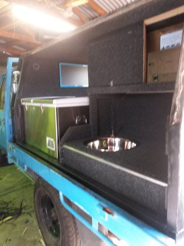

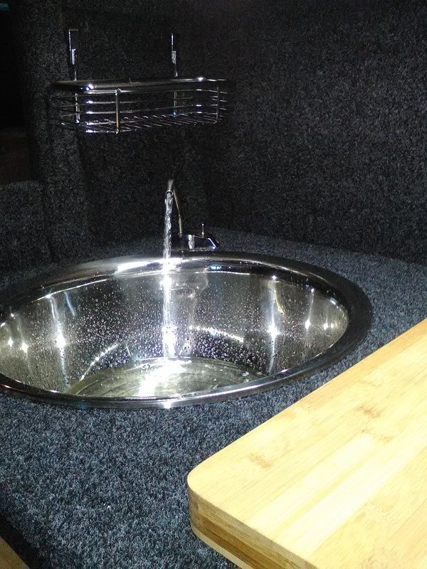

I brought a cheap canopy off ebay for $460 then pulled it apart, extended it 150mm & am about halfway through fitting it out & putting it back together, i have just been pretty much making it up as i go, originally i was going to mount all the battery management system in the rear behind the rear opening door, but when i extended the canopy i removed the rear door & turned the box around so now the headboard end of the canopy houses the 2 x 120 ah batteries, the compressor, the 240 inlet & circuit breaker the inveter the TV & the high lift jack with storage for recovery gear & tools ect, that all fits in the extra 150mm cavity where i extended the canopy, then down the right side i have a king single bed with 5 x 130 liter storage tubs underneath & above the storage bins there is a 100mm storage area built into the bed frame under the mattress the length and width of the bed, above the bed i have a cupboard that houses the 12 circuit narva fuse box, a Bluetooth stereo, 6 circuit switch panel with circuit breakers, a twin usb charge station, a merit power socket, the remote control box for the 1000 watt inverter, & a UHF radio, under the cupboard my tablet mounts using velcro & can be placed anywhere on the carpet areas, all the remotes have velcro on them as well and can be stuck anywhere throughout the canopy :) under the cuboard i have the Redarc BMS 1215s2 battery management system. all wiring throughout the canopy runs through conduce hidden in behind walls cupboards ect, down the left side i have a 100 liter fridge freezer some cupboards the 4 burner gas stove stored under the bench area, a removable lift out sink (large stainless dog bowl) electric faucet & pump, a travel buddy oven, above oven i have a solar powered exhaust fan, waiting until i re clad the canopy to install it, a switchboard to control the 8 LED's throughout the canopy with master switches for pump & bilge blower which is also mounted under bed behind fridge to give the compressor a little extra air flow, there are also another twin USB charge station, 2 merit & one gig power socket a double power point for the inverter, another double power point for direct 240 power for when on powered sites, also one in behind the TV and inside the cupboard above the bed :) in each top corner of the canopy there is a 240 v LED light for use on powered sites, that's all i can think of atm :) i will also be mounting a solar panel on the canopy roof that will run into the bms,
anyway here are a couple of pics of where i am upto with it.
cheers barnsey.
