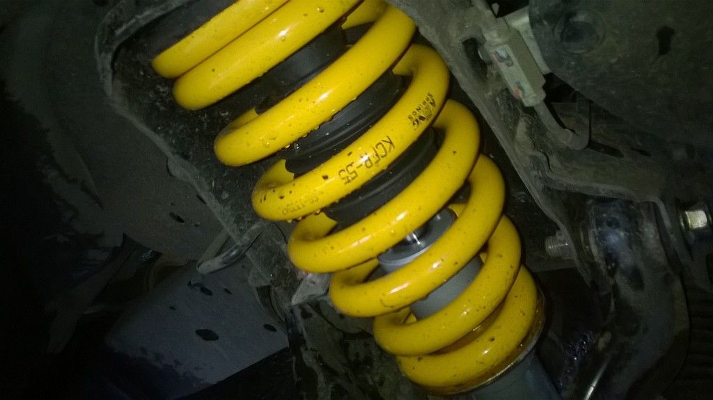

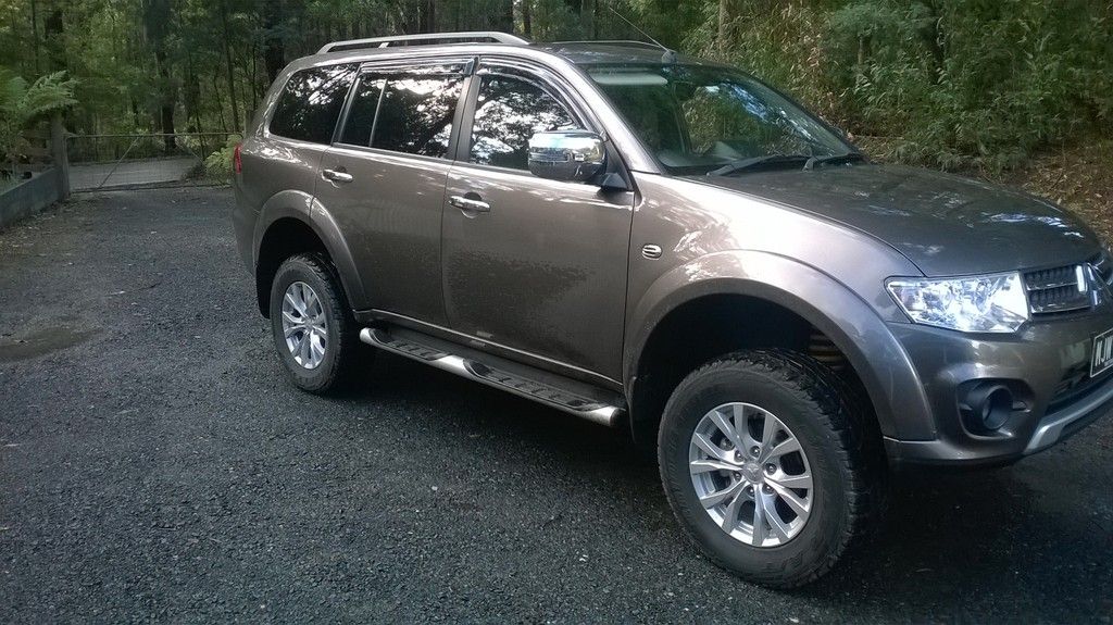

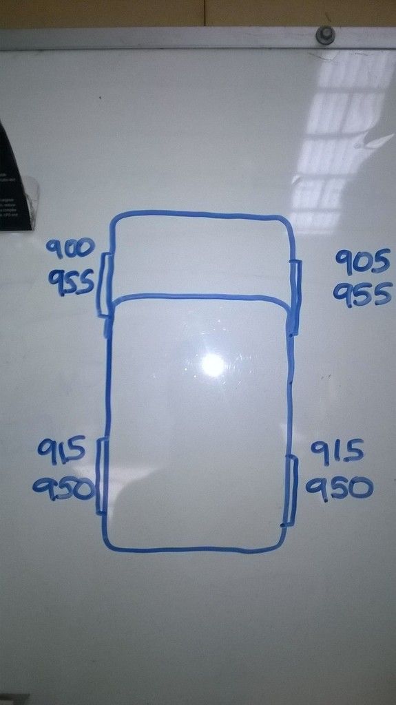

I finally installed my new suspension, it is a Kings/Ultimate combo that appears nice and tight but not overly stiff as a board unladen. It will settle and soften up a bit i know but very happy with the ride and handling. This is the first of many mods i plan on doing to it so i will post them here as i go. :lolImageImageImage
So to date i have replaced the H/Ts with Bridgy A/Ts and the suspension along with fitting all 4 doors with wind deflectors, next will be the EGR block off and catch can.

Challenger looks good mate. Where did you take your suspension measurments from and to?

I measured from the concrete floor to the lip of the flare at the centre of the rim, the whiteboard pic is the before and after measurements. Pretty happy that it measures all square after the lift.

Had a wheel alignment check after installing the suspension, only the toe in was a little out. Rest was good.
