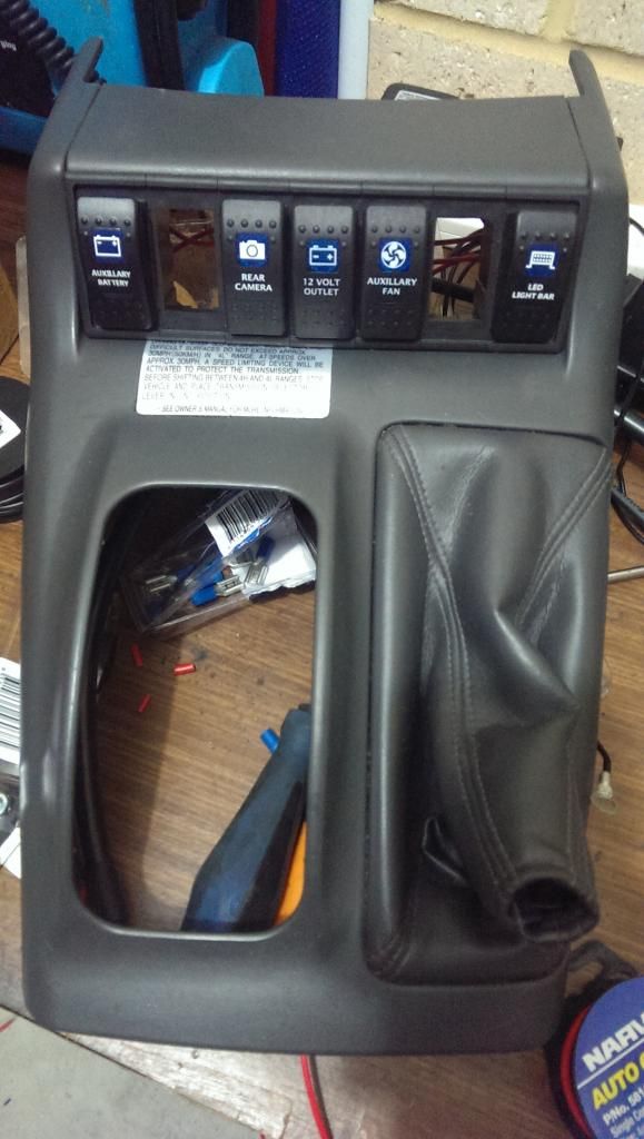

Started grinding the storage box section untill i realised it can be removed. Once so the switch holder fit perectly, coincidence? not sure, but another win for Mitsubishi in my book...

At around $25 per switch, running out of money is a possibility!
At last count I've got 15 of them in the dash/console, 6 in the rear drawers and 10 of them in the camper trailer. Adds up pretty quickly.

I was more referring to the accesories they're controlling ;-)
But you are right, the switches themselves are not cheap. My idea was to bulk buy and save, got each switch for 12 bucks with $8 total postage (ebay), now to get the accessories. Only have the light bar and dual battery set up so far.
Your dash/console must be very lit up at night! Great rig btw.

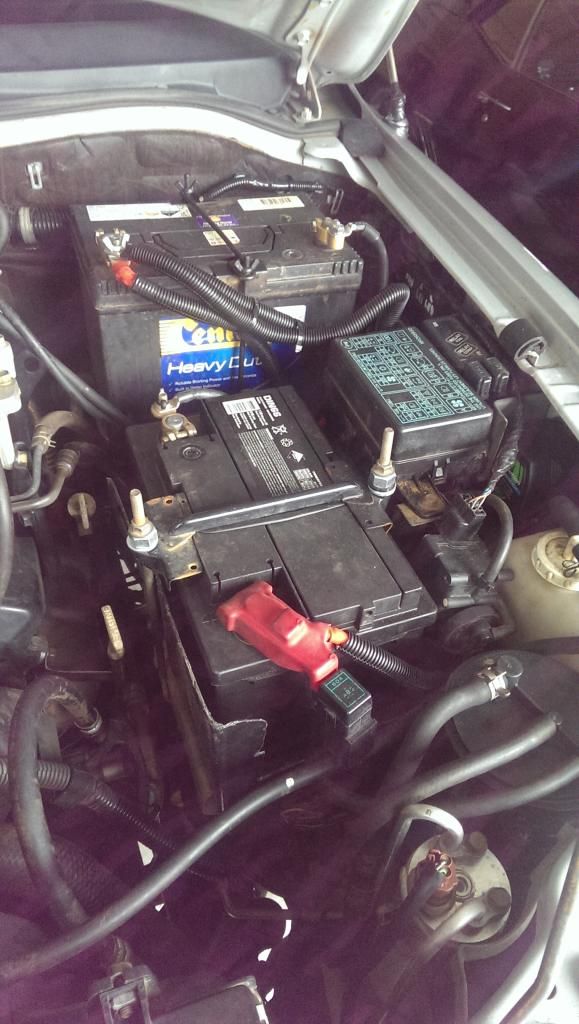

Finished my Dual battery set up on the weekend. Definitely took a lot longer than I was expecting. But then again I did all the wiring for the current accessories plus prep for the future stuff. So I'm sure I'll thank myself later! :drink:
Items:
Second hand battery tray, already custom made for a PA. $60.
Second hand battery, $70.
140Amp Dual battery kit off eBay, $100.
8 80A relays and connectors off eBay, $25
Probably $50 on connectors, wiring, fuses and cable protection.

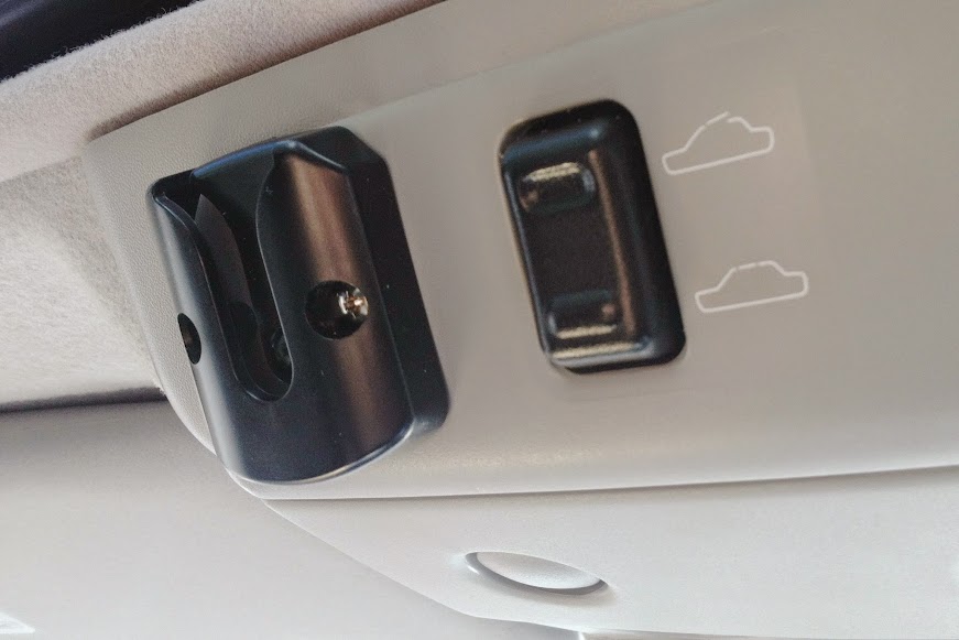

Today I started installing my Christmas present.
So far I've got the hanger attached and a hole cut for the RJ45 socket. Since this is my daily drive, most of the time the mic will be disconnected and sitting in the glove box, or left at home.
The hanger, held on with supplied screws and nuts. Most of the time this will be the only visible part of the install. Just the way I like it.
Next step is the glue the RJ45 socket to the back of the overhead console. At the moment it is just sitting there, but the cable has been run through the headlining to the driver's side A pillar, and down into the dashboard.
I'd like to add either a gpsXo (http://www.inawise.com.au/gpsxo.html) or an Audio Interrupt (http://www.audiointerrupt.com/Content/CBMU4.html) which will mute the stereo when a transmission comes in, and will route the UHF audio through the front stereo speakers. Nice, neat solution.
