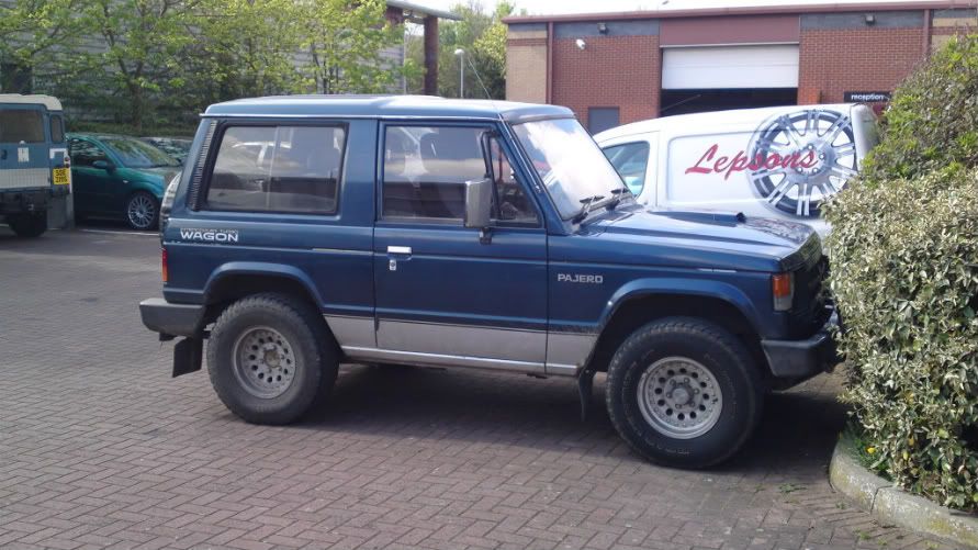

Alright guys!
New to the Forum, am from the uk.
Thought i would show you my 89 2.5td intercooled.
How it was when i bought it

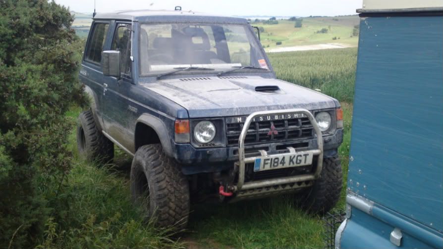

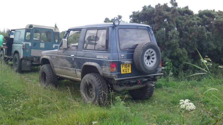

How it is now
Mods so far...
2" Body lift
Roughly 2" suspention lift, using Mk2 LWB rear springs and front torsion bar reset round one spline and cranked up.
Wheels are 10x15 modular black steels, with -38 offset i do believe. Its a big offset, but looks ace! And also spreads the weight better too.
Tyres are Maxxis Buckshot Mudders, 33x12.50 R15. Great tyres, on and off the road.
Arch extensions
Clear lense Headlamps. Highly recommend these, only 30 notes, and with some philips extreme vision bulbs they are fantastic!! So much better than the original ones.
Front bumper removal, along with some slight body panel adjustment to the rounded blue bits just below the headlight/front corners, that used to sit behind the bumper. Just so the tyres don't catch whell on full lock etc.
Custom rear bumper, old one junked.
I also now have a cb, with ariel mount top right corner on the rear, and a work lamp on the top left corner.
Upped the turbo boost, via an adjustable boost valve, to 14/15psi on full boost. Goes a lot better now!
Removed egr and put blanking plates in.
Voltmeter and boost gauges in the centre 3-gauge pod to keep an eye on things!
Got a big Lucus deep cycle battery in there too, as the old one was knackered.
Hope you like!
Rob.

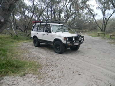

Hey guys just posting some pics of my Pajero
ImageIts a 1989 3.0L v6 . Its got a 2inch suspension lift from ironman, 32inch maxxis bighorns on dynamica steel rims, a bullbar from the wreckers with 2 lightforce spotties( need a winch ), um tigers 2 roofrack and a homemade high lift jack and shovel holder, awning. A uniden uhf with a broken antenna, sony stereo.On the wish list is a rear bar and sliders, either airbags or a 1 or 2 inch body lift or both, gotta fit the dual battery sittin in the shed homemade drawers and definatly a snorkle.Pics were taken at moreton but found out that the car dosent float at the keyholes.(north straddie)

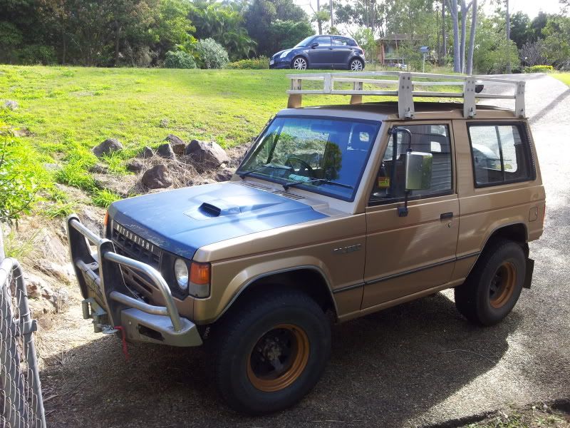

Hey guys this is my 89 Pajero Shorty, I only just bought it so it isn't much.

gotta love a white superwagon :D very nice!
