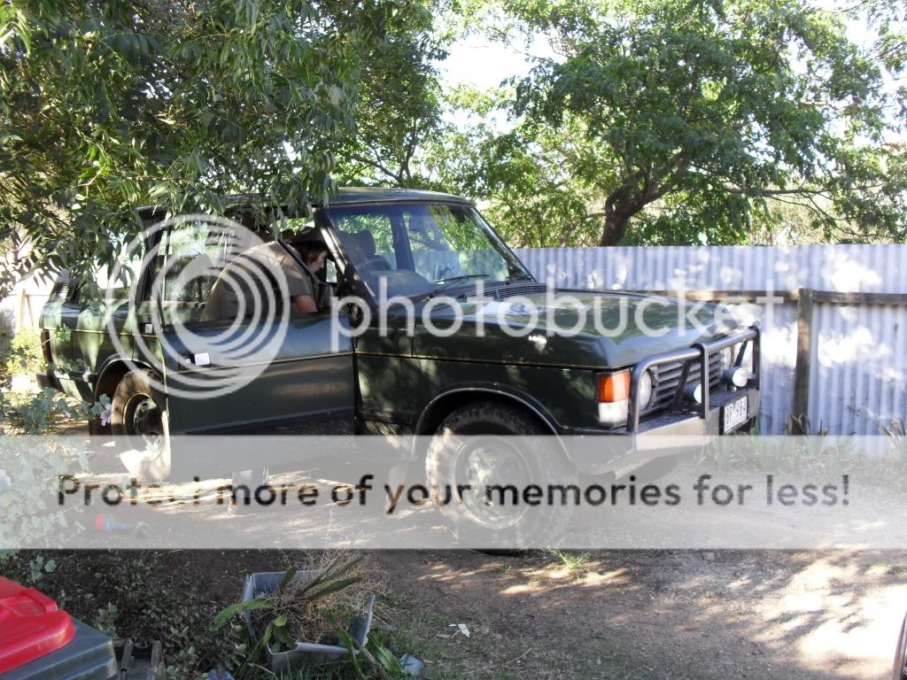

you can see why as soon as i saw the pics it was sold. was so hard to keep a straight face. hahaImage

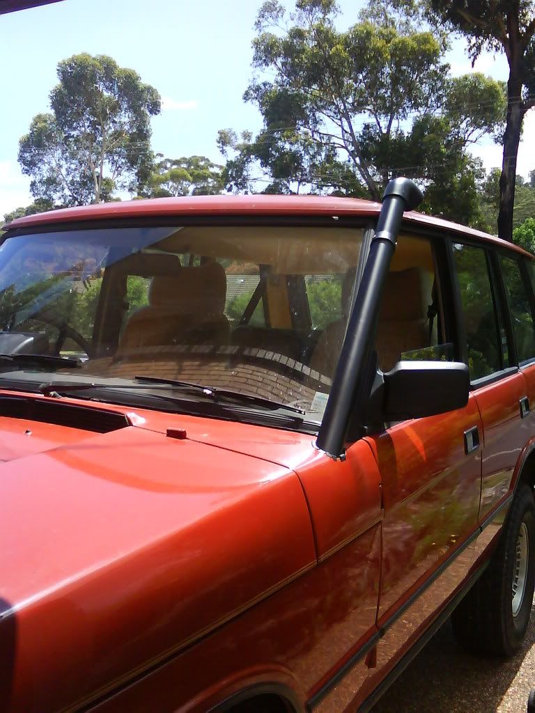

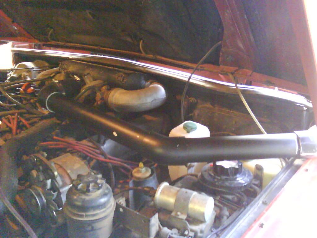

she also scored a home made snorkle made from pressure pipe. cost me 90 bux.

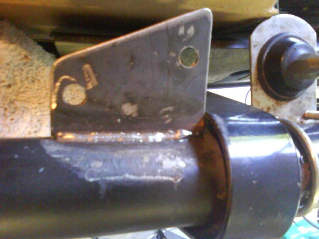

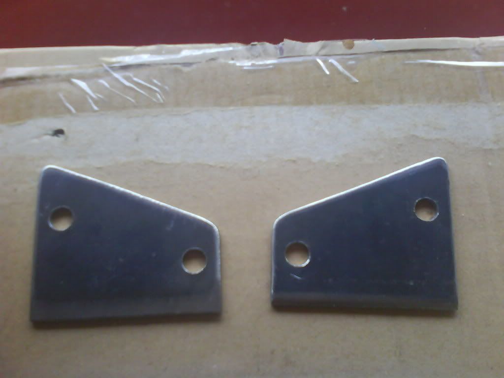

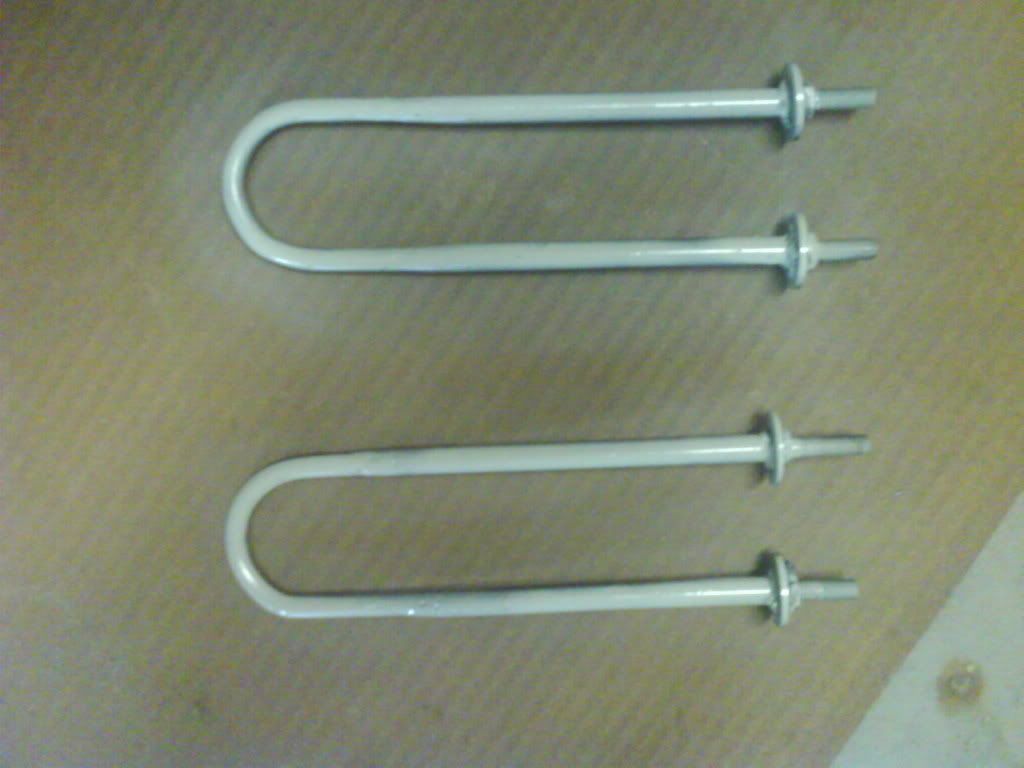

and also i got bored one night at work and made some snatch holders for the bull bar. the bueaty of them is there detachable. so cops dont get to windge at me. hehehe.
these brackets were really easy to make. if you can weld, use an anlge grinder, and use an oxy, then you can make em. or if you ask really really nicely i might be able to make you some.

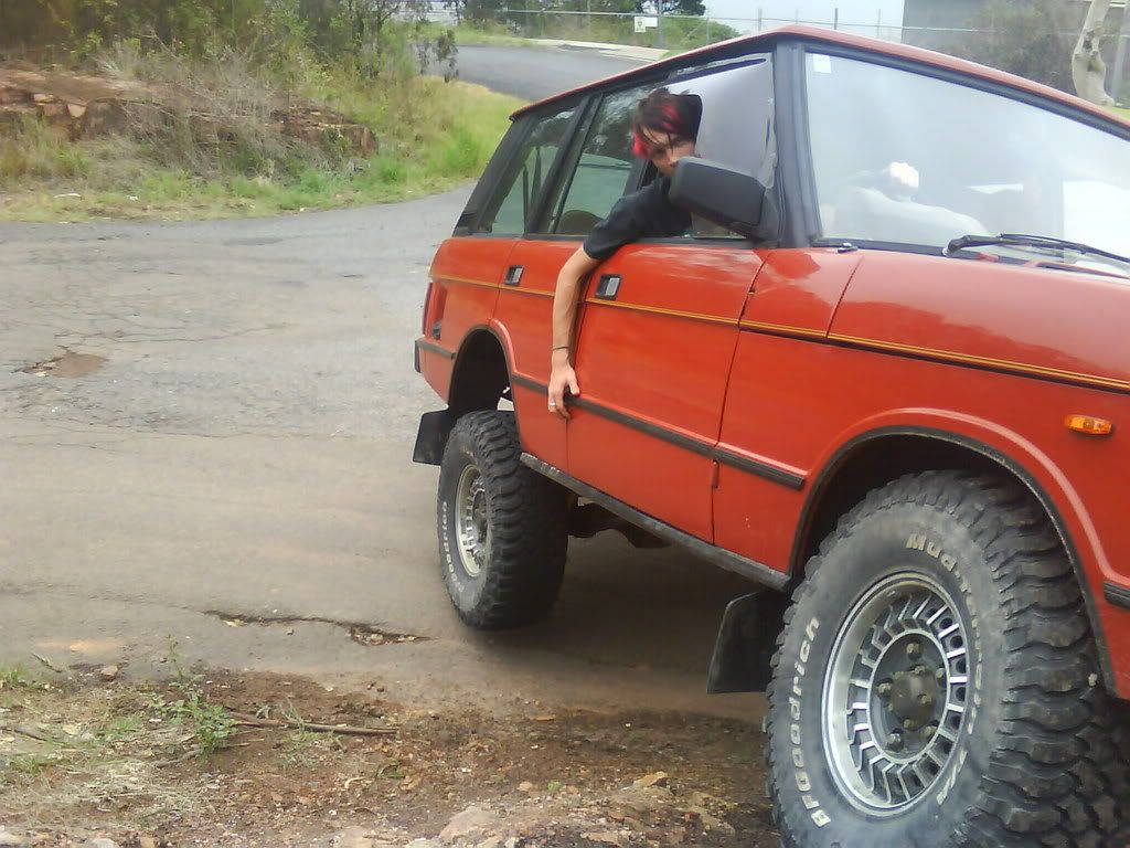

i scored i pretty good bargain after walkin out of work.
said hi to a bloke and ended up swopping tyres with him.
he had a full set of 32x11.5x15 BFGoodrich MT's. the spaire hasnt even seen tar yet.
got em fit and balanced for 40bux too. cheering.

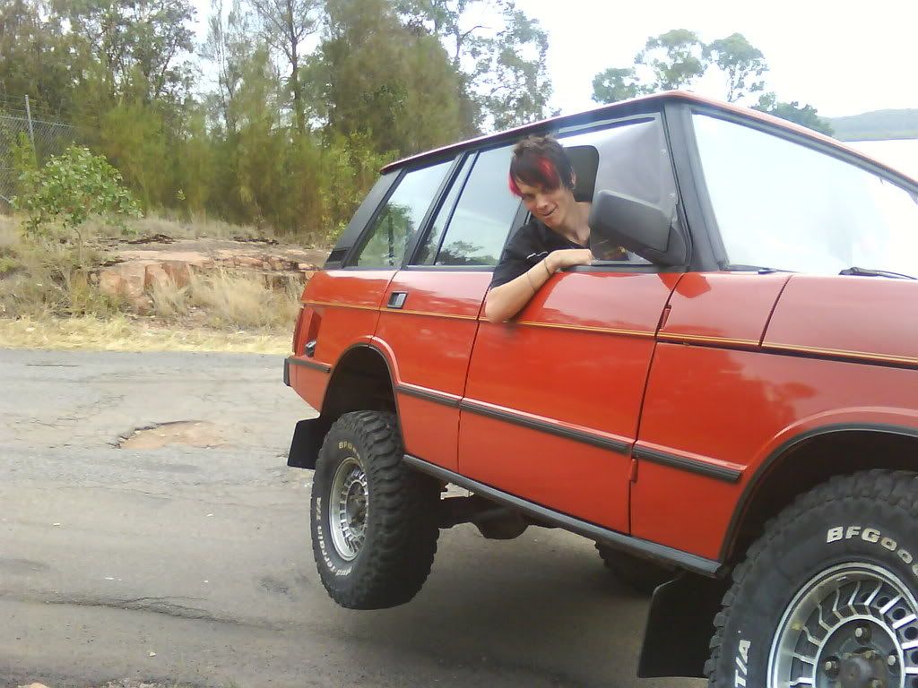

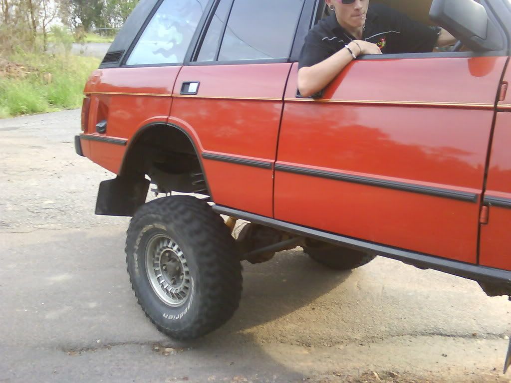

when the lift was done by, i have no idea. some dumb bugger has put the wrong length shocks in the rear. so i basically have the same amount of flex as a shopping cart. something had to be done.
at first i just changed over the rubbers on the bottom shock mounts. that made a noticable difference. but it wasnt enough.
whilst at a metal place gettin some stuff for work, i managed to grab some 5mm 50x50 blocks. very simple mod, drill 2 holes in the block, mount the shock to the block, then the block to the mount. massive improvement. taking out the poly air bags has helped a bit too. the next problem now is coz i dont have a nice offset in the rims, when the coil leaves the housing at the top, on up travel the tyre rubs ever so nastly on the coil. will solve problem soon.
heres some before and after pics of the rear suspension in progress.
all at same spot too.
