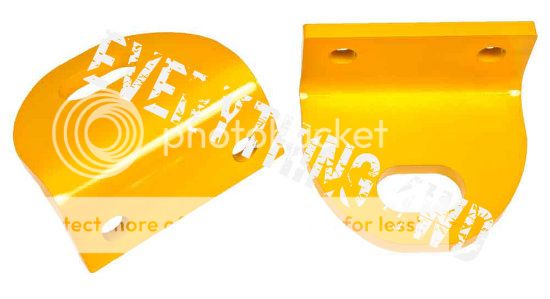

3.2 ton rated shackles are all you need as they are tested to about 3 times that. 4.2 is probably overkill. Don't use the tie down loops as they aren't made for it. If you don't have the hook, try a wrecker and see if you can get one off a Navara. Failing that, get some 50mm x 6 mm angle iron and drill it to fit the hole spacing on the chassis (both left and right) so you get something like this... or just buy one:
http://everything4wd.com.au/ProductDeta ... e=RP-NAV40
