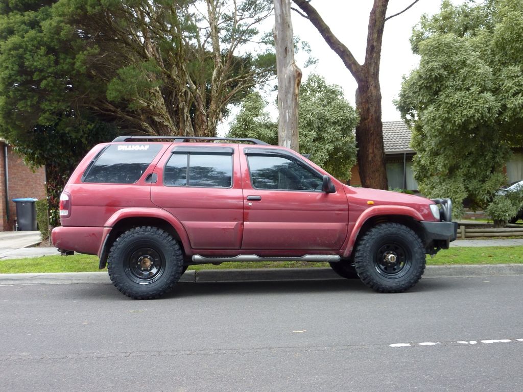

Hey all

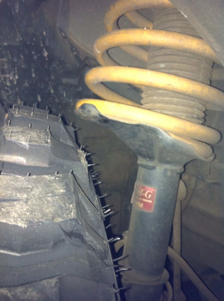

Here is some pics of my pathfinder with Federal Couragia MT 265/75/16 and rims are black dynamic 16x7 with a +7 offset.
Here's how far away the tyre is from the strut:

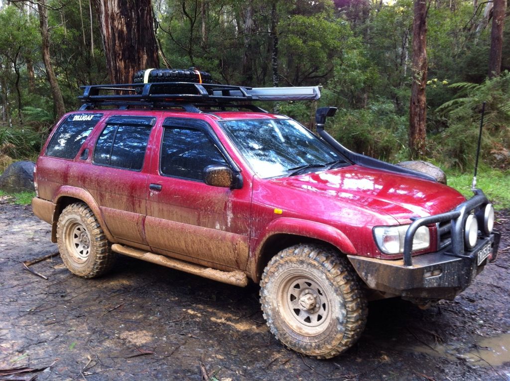

Nice looking pathfinder you got there mate,is that the ARB roof basket ? i have been looking around for something that would fit my 2000 pathfinder.
