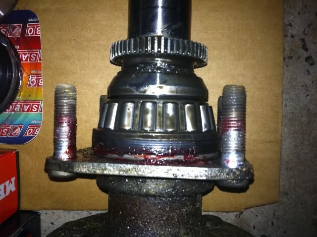

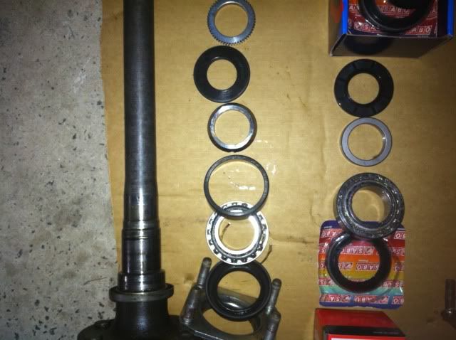

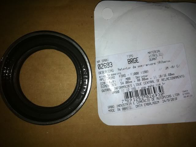

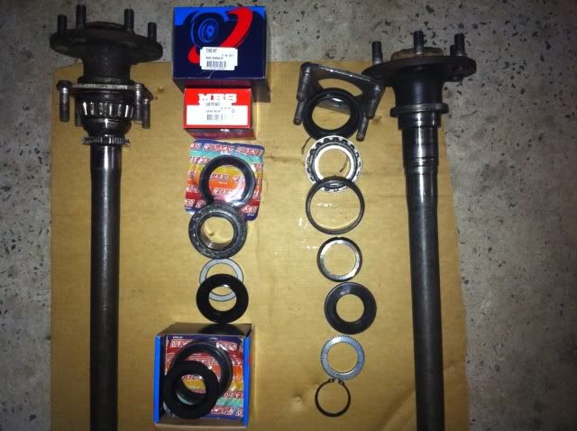

Lunch time today i recieved a phone call letting me know that the kits i ordered were in ! That was quick i only ordered them friday arvo, so i turned my work phone off and took a drive to pick them up.
looks like good quallity, i like seeing made in japan on bearings.(not brazil like standard)
the seals look to be made by the original manufacturer as they are exactly the same in every way.
the lock ring is slightly different Which could possibly affect the pickup of the abs tone ring.
Tomorrow i will fit the seals and bearing to the axles.
fingers crossed i can pickup new brake shoes tommorow aswell.
outer seal must be the same as others

Ok all fitted up and done about 160ks so far
The locking collar was fine abs works with no issues

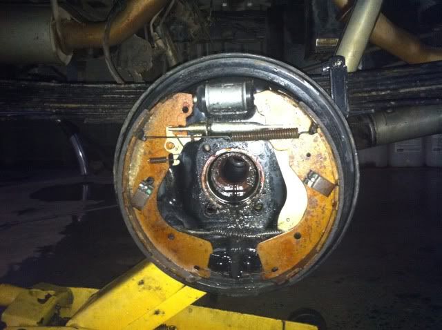

What makes my blood boil tho,is that after buying my Nav used at only 27,000k's and finding the rear seals leaking,I thought it unbelievable for such a newish car.I then found out that Nissan had a recall or fixed this prob under warranty.So I decided to check if mine was to be fixed,rang the local dealership and they checked with Nissan and said mine had already been replaced with previous owner??????? What a load of crap! So in my thinking,Nissan has had 2 goes at this trying to seal the axle?Once from new when first manufactured,then under warranty/recall,and NOW I'm supposed to be responsible to fix it? Yeah good one Nissan.
