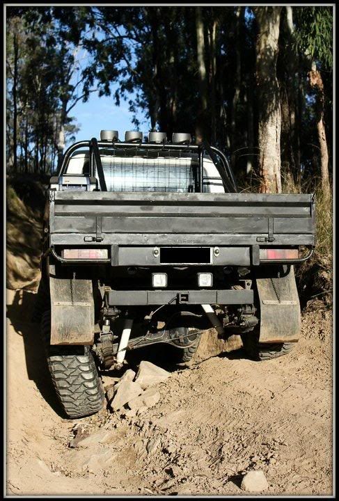

i run just over 2 inch of lift with some other tampering and fit 35s flexs alright too

Hey Lynch, you have set yours up perfectly by the look. Not many utes can go bendy like that !
Well done mate.
Ahh on a closer look....you cheated !! I see the disconnects LOL.
