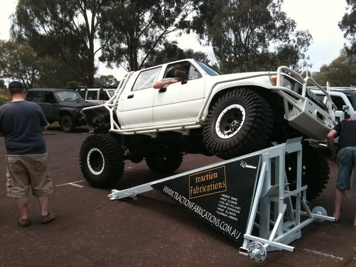

2" body lift, 2" suspension lift. 33x11" tyres on cruiser offset rims. No rubbing on the rear, scrub hard on the front
Same with 32x11.5 on cruiser rims
Same as above with 33x12.5" tyres. Cruiser offset rim. Rub hard on the chassis on the rear limiting flex, rub hard on the front again
2" body lift, prob around 4" suspension lift, cross over steering. 35x12.5" on 15x10 cruiser rims.
Still rubbed front guard, also did the same with 4" body lift very lightly
Now 2" body lift, I think 2" spring lift. 37x12.5" tyre on patrol offset rims with GU front diff. Front diff forward 4-5". Guards cut at front. Still grabs the front of the guard. If it was on lux diffs it might tuck tho, and maybe not have as much up travel.
