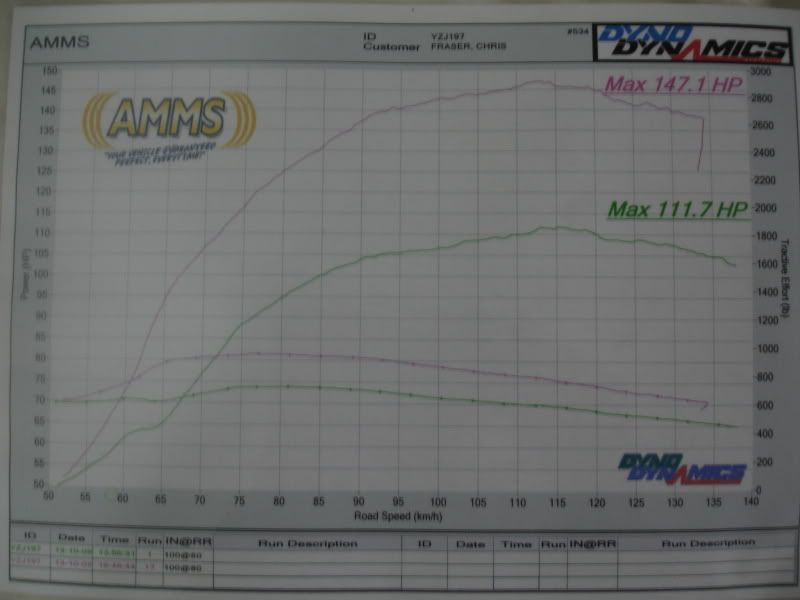

In the insane quest for power I ended up with a hybrid engine thingy from both the 1HDT and 1HZ engines
From the 1HDT
Block,
big end,
rods,
cam,
and sump
From the 1HZ
1HZ Fuel pump (cost $$$ to get modified),
pistons,
larger injectors with a different spray pattern,
head (filled with heavier springs, valves, guides and it also had all the burrs etc removed and exhaust/inlet manifolds matched)
We used a Safari turbo setup which is a Garrett GT3271 turbo (twin scroll) and an A2A Front mount intercooler
At 15psi and only 480 post turbo EGT's we ended up with this at the wheels (the lower tune was a break in tune of 8psi)
but it cost $$$
yet to find out about the reliability bit (only has 10,000km on the new engine)
I would reccomend to fit a 1HD FTE, intercool and chip it and forget it
