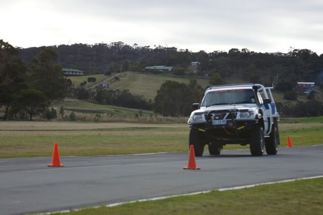

Seriously don't be scared off by the prospect of a lane change test, it's a walk in the park! Tassie has adopted the NCOP. My GU ute is engineered and mod plated for 3" ultra flexy coils, remote res shocks, Superior control arms and steering arms, Superior Superflex radius arms, aftermarket seating and 295/75/16 tyres ( Just under 34") It completed the test at 100km/hr with ease. Total cost of engineering was under $900 including the costs involved in the lane change test. (Track hire, CAMS driver, split amongst the 4 of us who did the test on the same day)
Doing the test.
The results
100 Series: Ute chopped, Locked and Rolled
GU Coil Cab: Work in progress!
My Ute Chopped Hunjy/GU Ute
