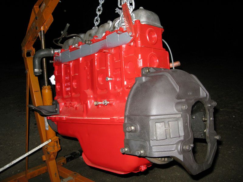

starter motor out, then from memory 2 bolts bottom left, 2 bolts bottom right, then 2 at the top one left and one right of centre. Bell housing comes off connected to gearbox

So you have had the housing off on a 2f? Coz it really looks to bolt from the inside bottom or the block. It's stupid as. Never seen anything like this bloody thing.

Sorry I was thinking 3F
For the 2f the clutch and flywheel have to be removed before the bellhousing can be unbolted from the engine block.Get the pressure plate off, then the bolts on the flywheel and remove it and then the 6 bolts on the bellhousing, two outside the bellhousing and 4 inside. You probably don't need to remove the bellhousing as flywheel and clutch are out before then.
