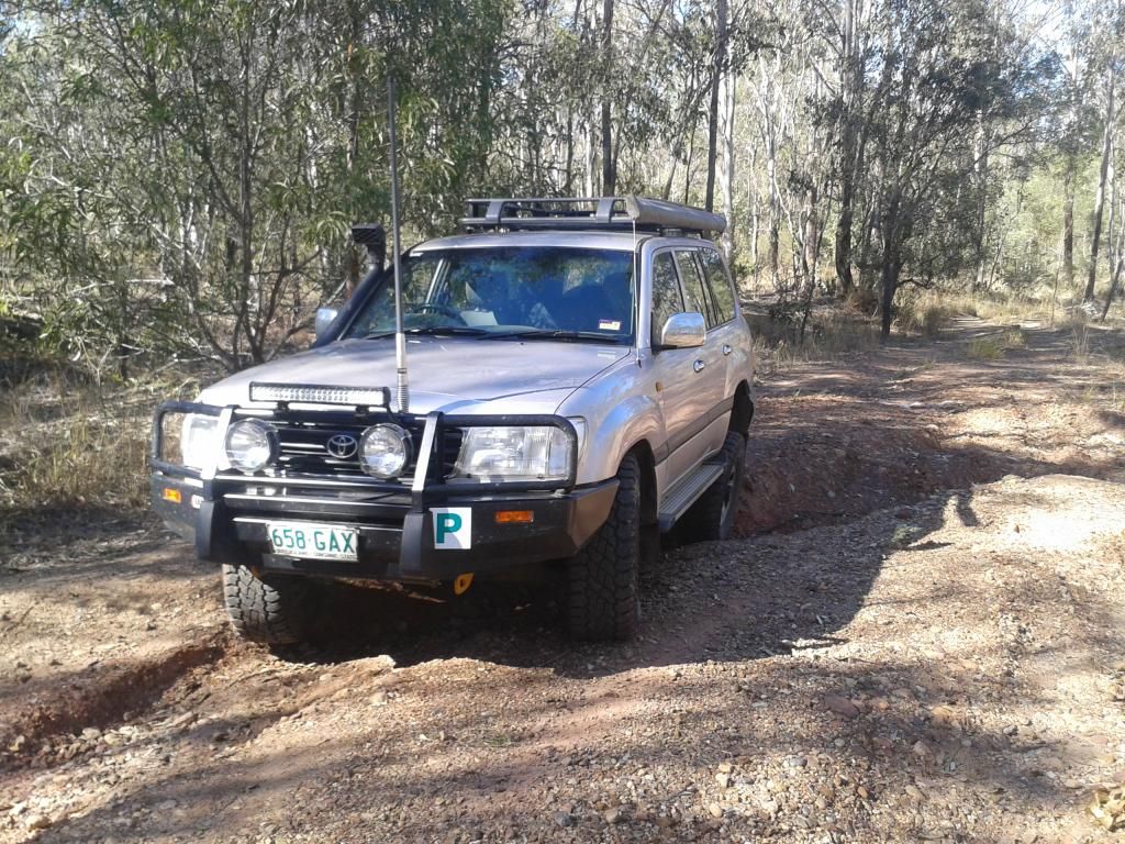

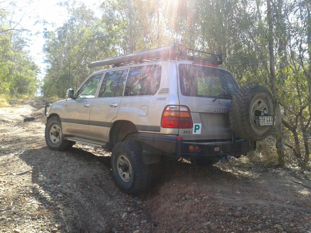

I disagree there sick i love the 100 series but love my 60 Pics are of my old mans 100 With the 1HD-FTE power house :twisted:

horses for courses i guess if we all liked the same thing it would be a pretty boring thing
