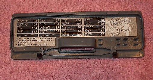

Does anyone know where the fuse is for the power windows and the sun roof on a 1989 Sahara HJ61. Both stopped working today and there's no mention of power windows or sun roof in the Gregory's manual.

there is no fuse - there is a circuit breaker next to the other fuses, reset with pin.

Hi Myhj61 has just lost all power to the windows what did you do to solve your prob?

the bottom silver cylinder marked power can be reset with a paper clip, try that one. If not I'll look up the wiring diagram for you.

Hey Stockhorse thanks for the reply everything matches up to the tee I have the same cover as well the two circuit breakers heater at the top power at the bottom I can see a little hole on them both is this where I poke the paper clip? I pulled the power circuit breaker out ...

Yes mate you should here a faint click if it resets but it is easy to not hear it

Cheers Mate worked a treat, thank you for your help :)
