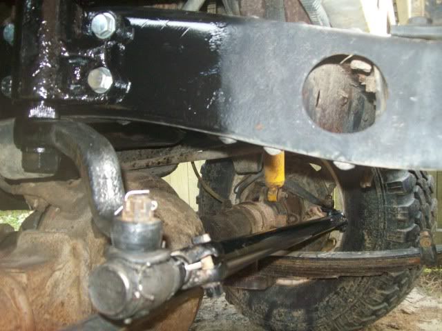

Is there a steering damper on that setup?

no, good point never thought about it :eek:

Thanks for the photos mate well i just scored a complete 1984 60 series with a 1 yr old clutch and 5 speed so im getting the 5 speed and the steering components out and will hopefully one day soon put them both in the 47 just got to find a couple more bits off a 75 series. oh and will hopefully put the disk brakes on too
