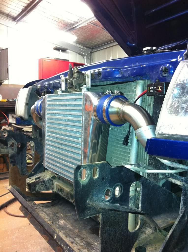

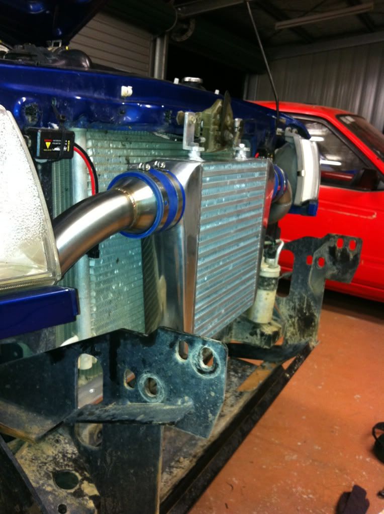

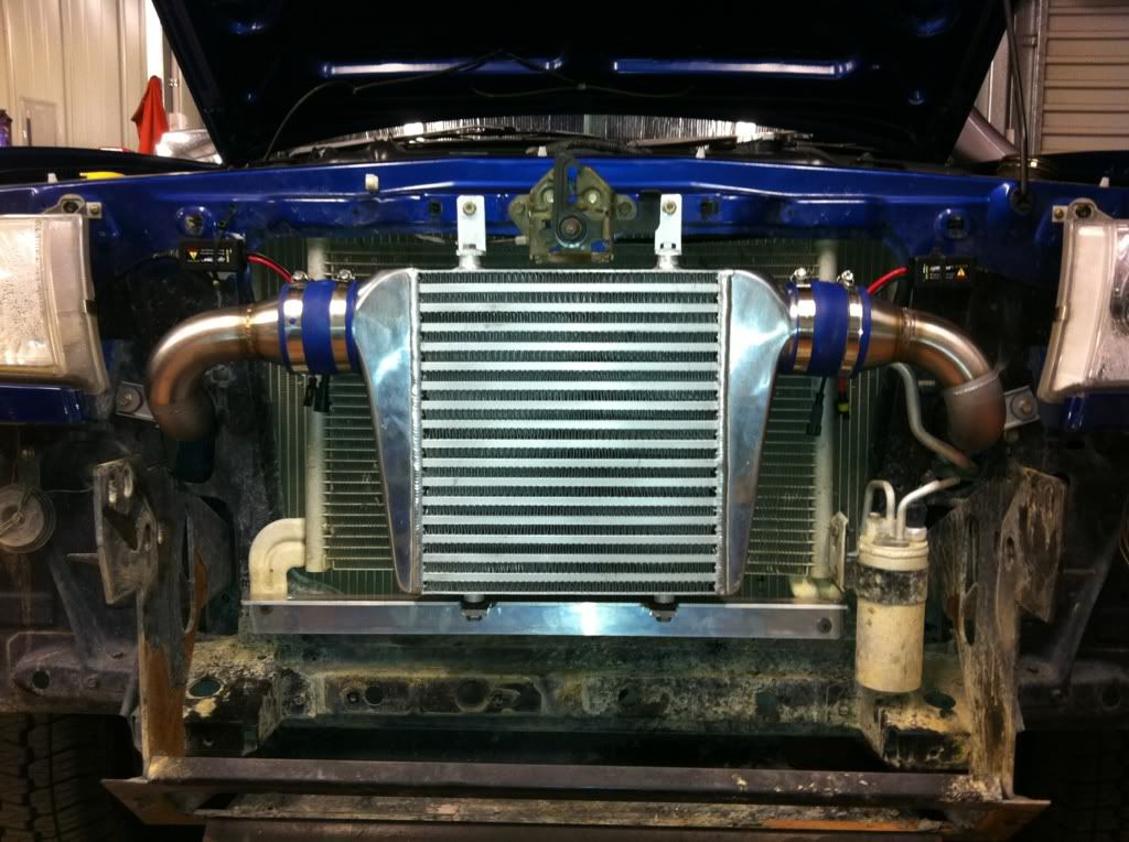

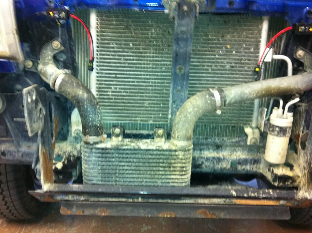

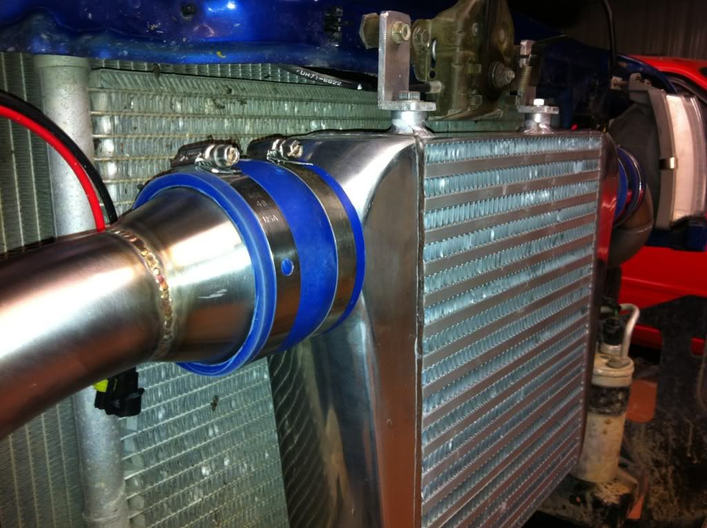

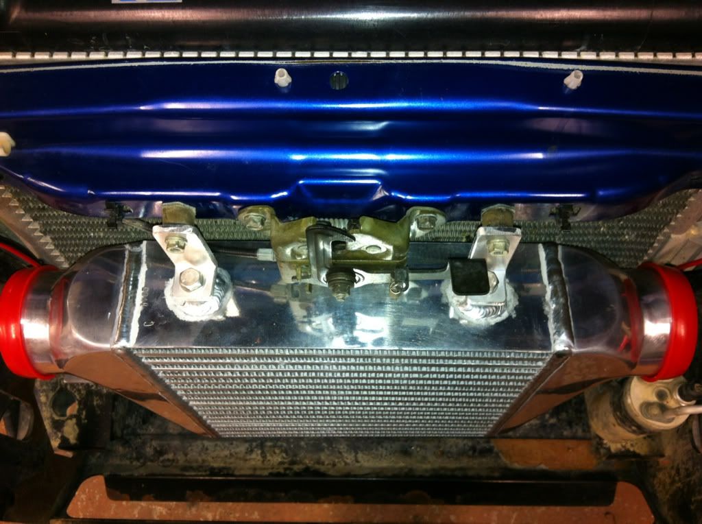

Yer mate it's one off eBay for a civic, helped with the egt temps, dropped about 50 degrees and I gained an extra pound of boost.
I just bought it and made it fit, only had to make couple brackets and cut the pipes around. I'll post some pics if I've got em mate.
Not so flexy
Matty Bravo
Posts: 64
Joined: June 1st, 2011, 5:45 pm
Re: Where are all the Courier pics?

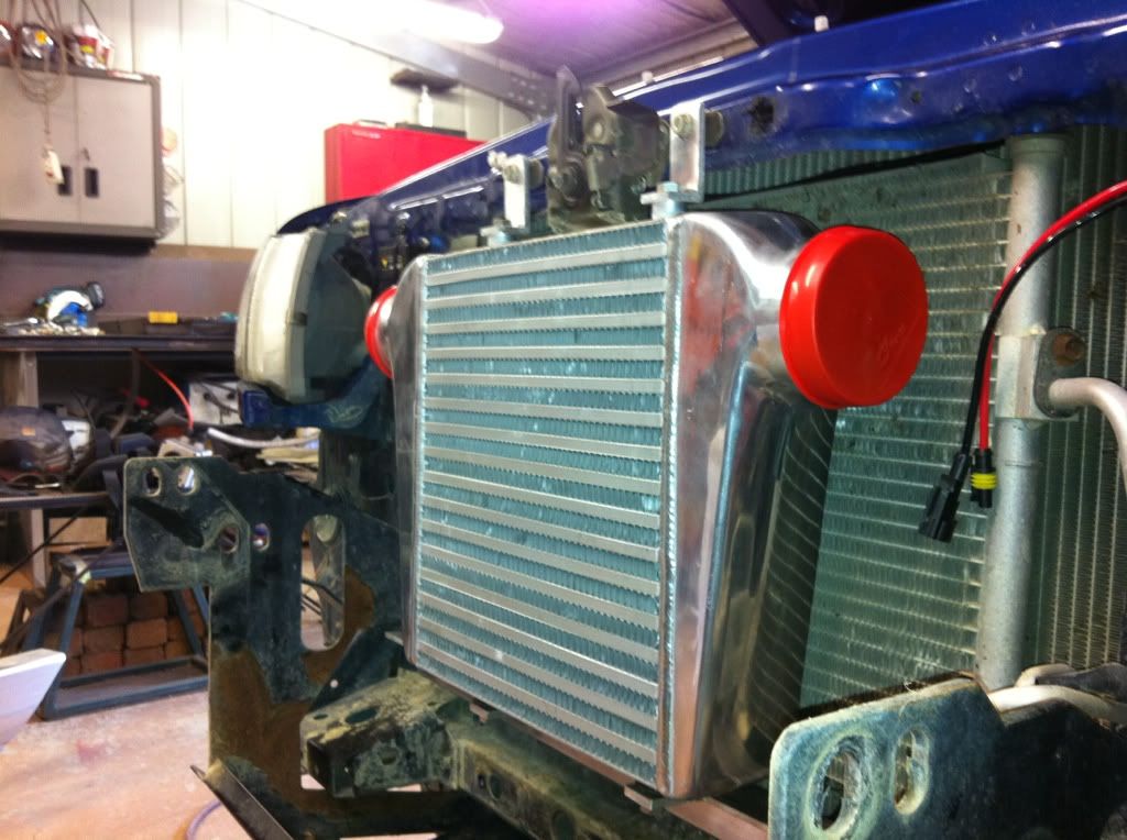

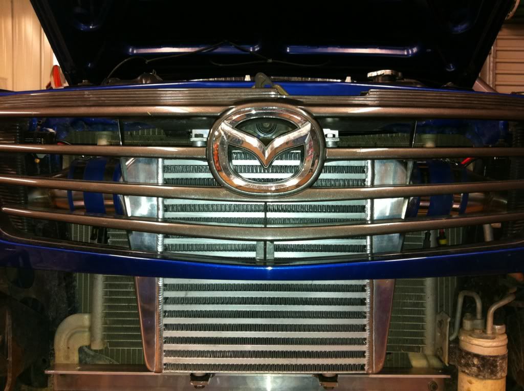

Unread post by Matty Bravo » April 20th, 2012, 2:53 pm
Standard....
To low and to small,
Brackets on top, angle on the bottom.
2 too 3inch reducer, i am thinking of making it 3 inch all the way to the motor but have to reduce it back anyway to fit onto the housing so no real point.
My favourite picture of it. Mazda POWER.
Field testing.
Anyway id do it if i were you because its only going to help get cool air to your motor, after ive been driving mine one side is hot to the touch, other is cold as. ;)

Great pic's nice job fitting the intercooler how is the performance now.
