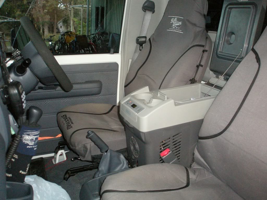

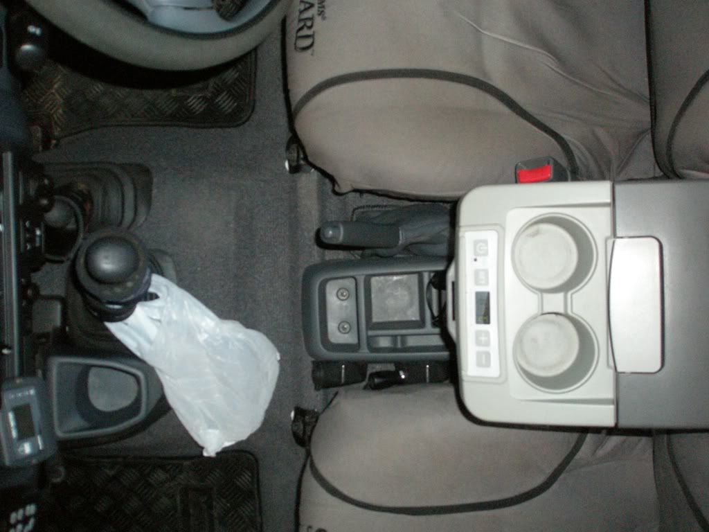

cory can you please put up a pic of the fridge in the ute ill go buy one tommorow if it fits well. I sent you a PM but havent heard back from yah Thanks mate

Here are those pics you wanted of the fridge

haha yeh she is a tight squeeze thats for sure lol ill try and get it in there. how do you go with the fan blowing onto your leg does it get it hot ?

Na my side doesnt get hot but the mrs complains every now and then that it blows a bit of hot air
Hope ya get it in ok

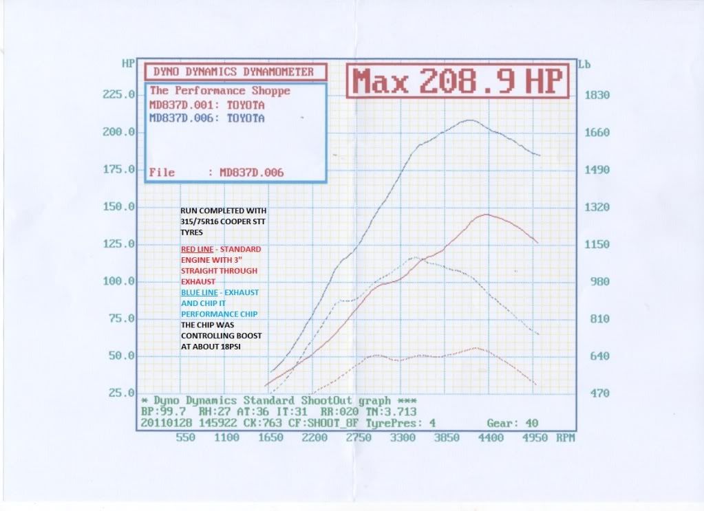

Well bought meself a chip for christmas and got the ute dyno'd today
I cant believe how much bloody power and touque you can get out of these things even with 315/75/r16s
Dont mind the tyre pressure at 4psi and tested in 40th gear haha but everything was uncompensated for so this is what she gave at the back wheels at that temperature (no cheating here by raising the intake temp on the dyno so the rear wheel figure goes up)

hey corey that chip is it just a chipit? just a rail and boost pressure plug in ? How you rate it?

yea just a chip it chip, yea just the 2 plugs (one for boost and the other for fuel rail)
I havnt driven any other forbys with other performance chips so cant compare but I just like the idea of an electronic boost controller built in to the chip, dual fuel map switch and being able to download the fual maps (whether theyre the preset ones or custom ones emailed from the dealer) from your laptop to the chip
the other mod I did (available from chipit) was put a fuel rail delimiter disc in, it just allows you to run higher tunes/fuel maps without triggering limp mode/check engine lights etc, and ill be doing the egr block when they send me the blanking disc
But overall for the features and value you get for an aussie made chip tested on aussie fuels i wouldnt hesitate to buy the same brand again
this months 4wd action also had a little article towards the back on this particular chip
hope this answers your questions any more just ask

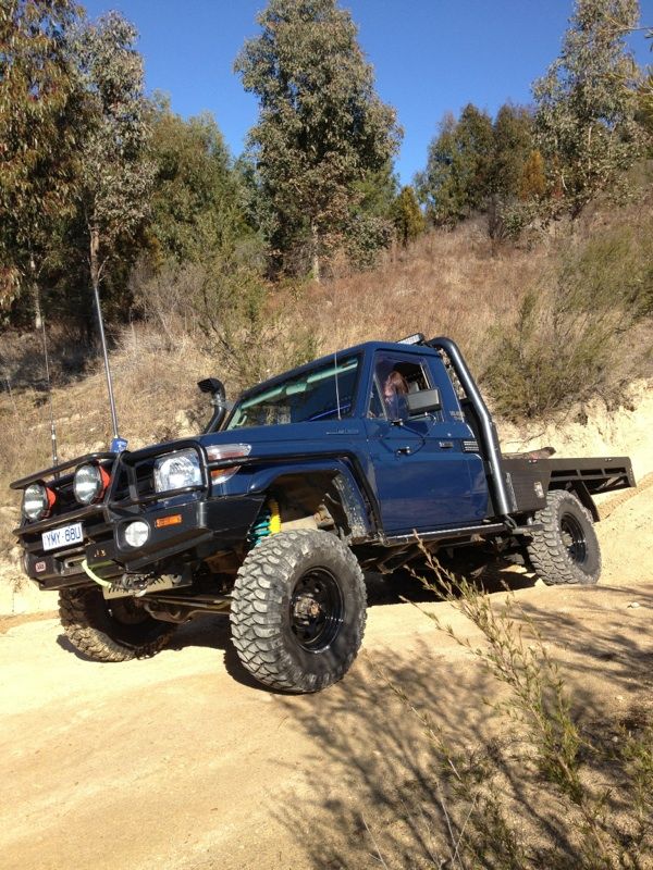

Heres my truck, took my time to get it up
i either made of fitted everything myself
4" lift with super flex arms, tough dog big bore adjustables
rancho incab wireless shock controller
6" front shocks
extended brakelines
removed swaybar
4x 80w solar panels on canopy
80l dual zone waeco
210amp agm
305 MTZs
chipit module custom tuned by my self
EGT moniter, EGR block
3" no cat, ends at passenger door
Methanol injection
hydraulic winch
hydraulic tray
50" light bar
70w hid spottys
the rest you will figure out
