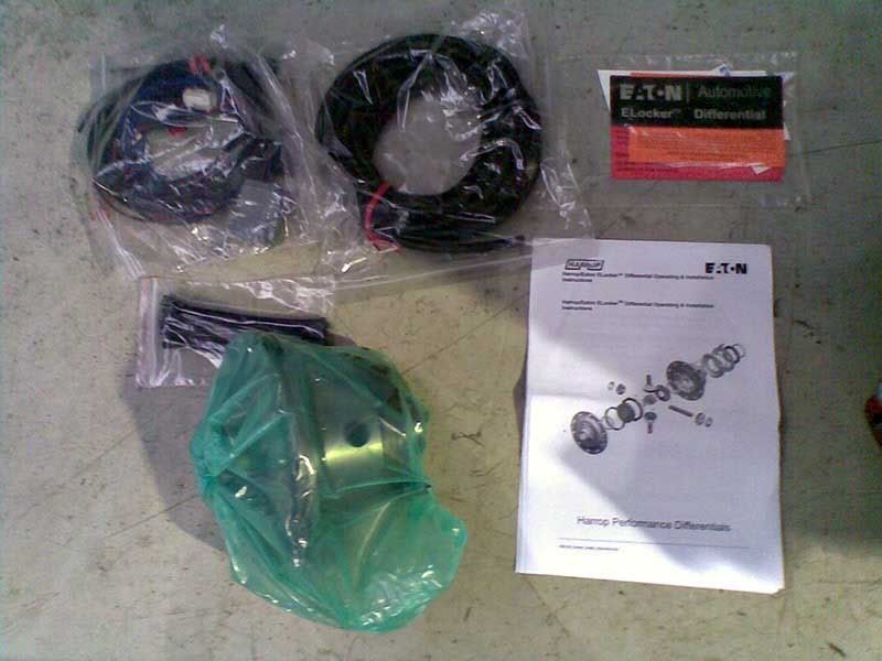

What comes in the box...ELocker, wiring loom, split tubing, cable ties, stickers/warranty cards, instructions...
