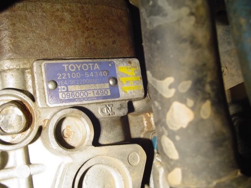

What is the pump number of your standard 2L pump, ie the 096000- ????. The 2LT pump you have is fitted to a toyota crown 2lt. There maybe a difference internally with advance rates.
Andy

Unread post by double diffa » November 12th, 2007, 8:00 pm
80s guy wrote:What is the pump number of your standard 2L pump, ie the 096000- ????. The 2LT pump you have is fitted to a toyota crown 2lt. There maybe a difference internally with advance rates.
Andy
This one, it was easier to get my camera down there than to stand on my head with a mirror :)
