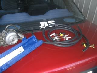

Well we fitted a turbo to a mates lux on the weekend so I thought Id do a semi detailed write up about it to second the other one on here.
Items required:
Turbo/manifold
exhaust gasket/goo
3m of heater hose
1/2m larger fuel hose, 1.2m small fuel hose
plastic/brass barbed T fittings
Hose clamps in various sizes
assortment of tools/rough knowledge of vehicle.

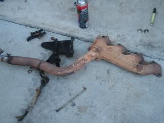

remove old manifold and exhaust

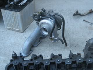

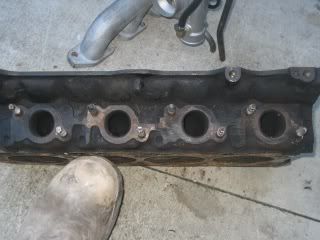

This is wat we start with a completely rebuilt oil/water cooled roller bearing garret, the manifold turned out to be off an ancient L diesel (2.2D) so had to be backyard modified to fit (seems sealed ok after testing but time will tell).
This is the little L head, far smaller then the 2-3L.

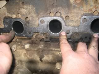

U can c here where our problems wer, the ports wer perfect but the holes wer about 3mm or so out. enlarged them with the diegrinder till the bolts cud clamp down, plenty of hightemp sealant used.

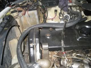

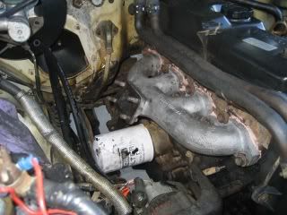

manifold finally on, not happy with how dodgy it looks but it seals fine.

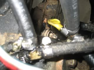

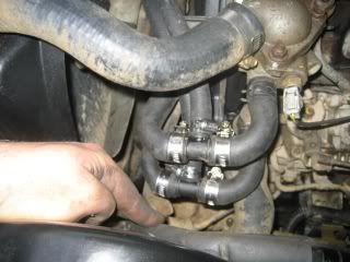

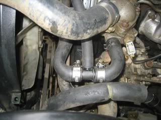

about $100 of hoses and fittings to get oil and water to the turbo.

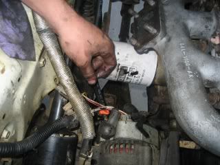

U hav to tap into the alternators feed and return oil lines, the feed is the high pressure smaller hose and the thicker one the return, we used Brass T pieces and came straight from these lines to the turbo. Ther is roughly 40psi on the high pressure line so use proper fuel hose and decent clamps.
