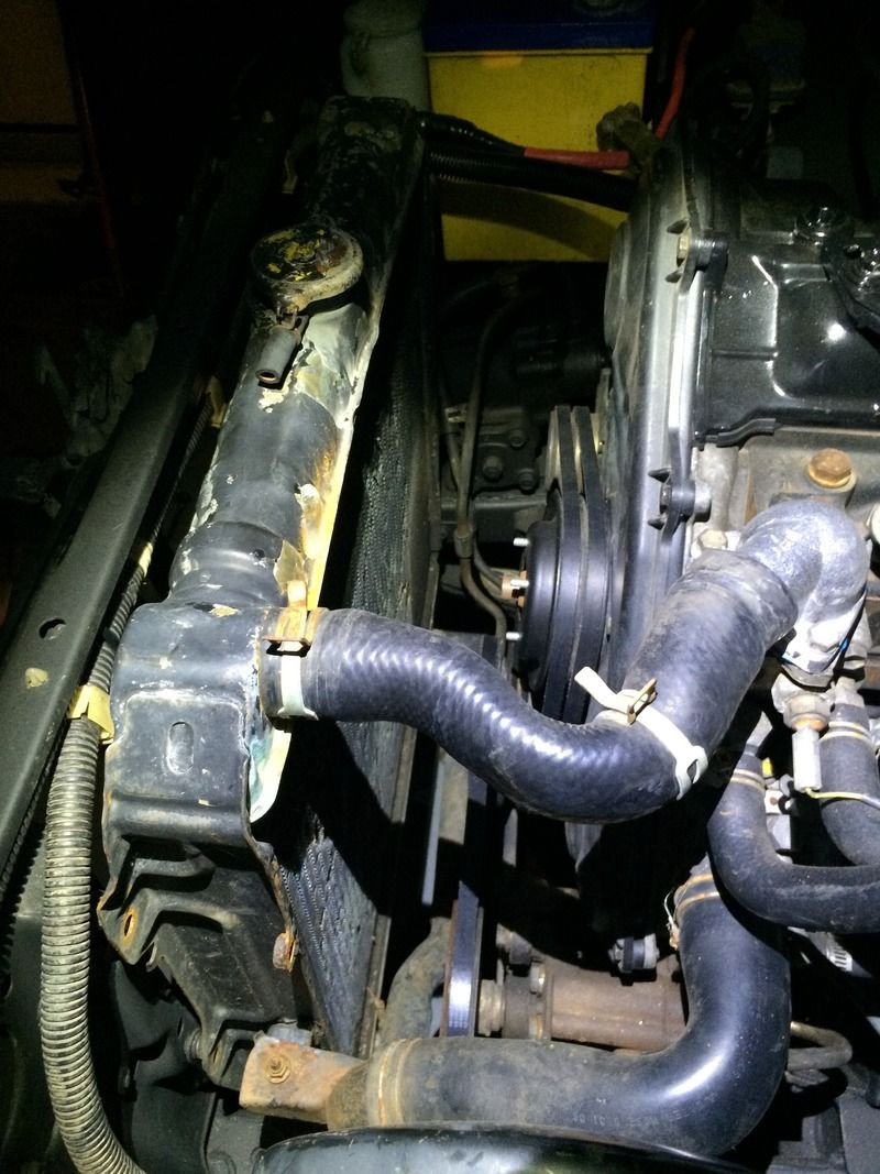

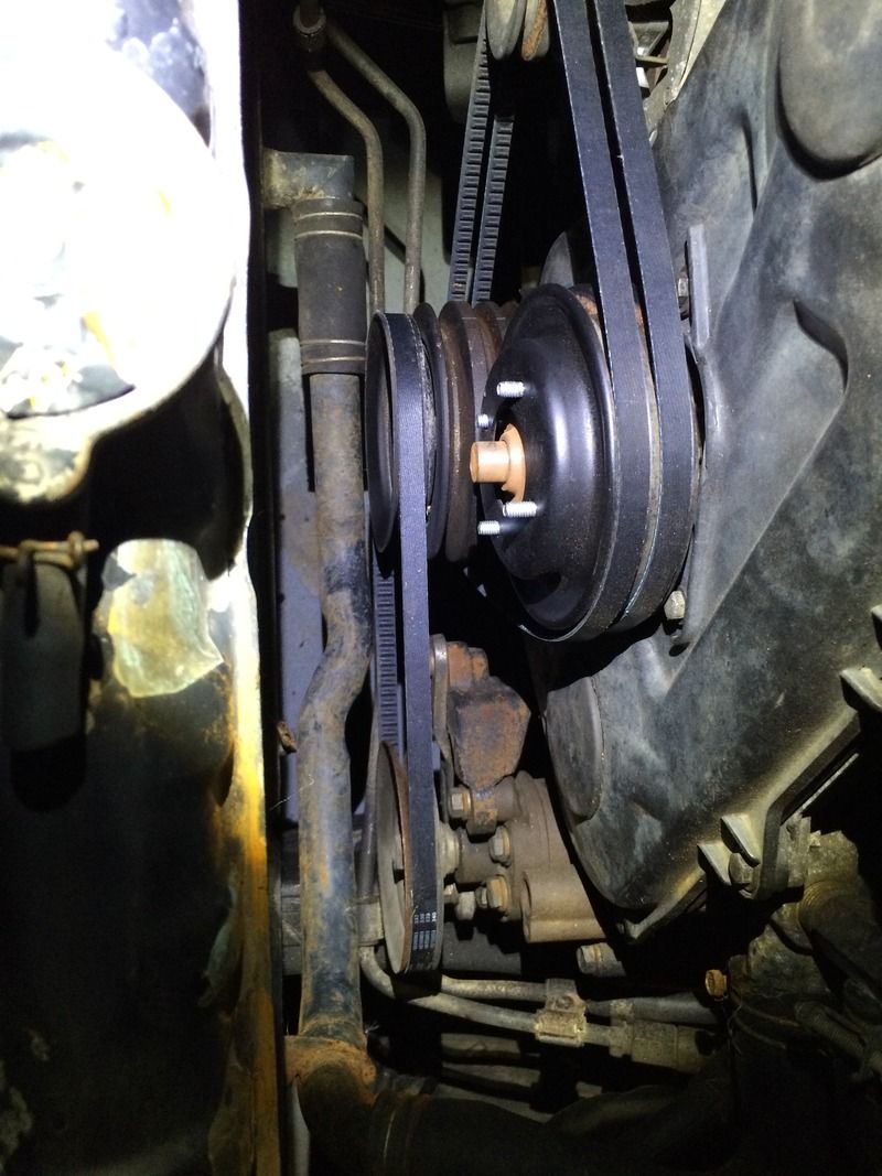

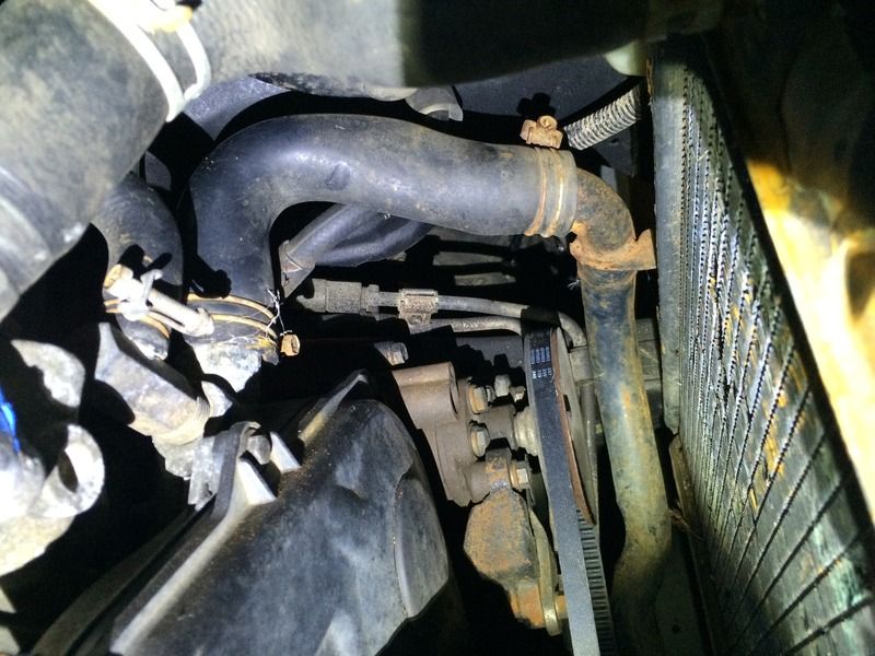

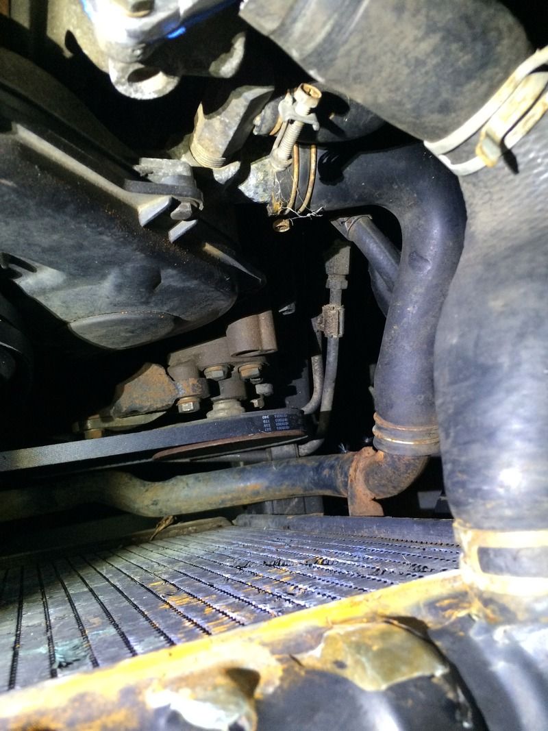

hi everyone i have a ln60 4runner with a 2.4 2l diesel engine and i need a new radiator. i have noticed there are 2 different options for radiators
1: bottom outlet with 90 degree elbow on the drivers side
2: bottom out let on passenger side
mine has the outlet on the drivers side with this dodgy looking metal pipe that runs along the bottom of the radiator and i was wondering could i buy the radiator with the outlet on the passenger side and change the bottom hose? has anyone got some pics of there standard setup so i could compare? cheers

The ones that have that metal pipe are the models that came with power steering. Its there to give clearance for the pump and hardlines. I've changed mine over when I got a radiator that was off an non power steering model and used it to replace mine that was power steer. I'll see if I have any pics.
