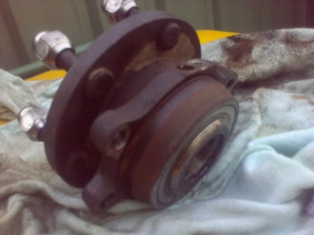

My latest problem has been the front wheel bearings which are only sold as part of the hub. Bloody pain in the a** instead of costing around $60 a wheel its going to cost $889+gst each from nissan what a joke.why did both mine fail within 2000ks of each other?
FRONT WHEEL HUB ASSY P/N 40202ZP91A
IF IT’S UNBREAKABLE IT’S UNDERPOWERED!

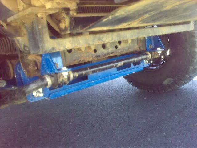

Hello d40, what have you done in regards to frontal protection for your lower radiator?
I ask, coz in the last 12 months I've seen three New model Pathy's (almost identical front end to the Navara) floral themselves when they've smacked a bit of sand on Stockton. This usually happens on adip, bottoming out on the bottom of the slope or knocking the crest off the top of a dune.
This results in the radiator copping a healthy shunt, thus breaking the mounting tabs out of the moulded radiator, thus looding coolant, and on one occasion secondary damage to the fan and fan strike to the radiator.
All three required towing out for recovery.
Just wondering If you have some sort of body armour or know of any good designs.

Hi larcie lucky for me i have some great friends who are experienced 4wders so after a few day trips they pointed out the possiblity of radiator damage so i made a brace which is strong enough to put a trolley jack under and lift both front wheels off the ground. it bolts straight to the existing threaded holes either side of the radiator looking up . you can sort of see it in this pic.
i have other pics i can post later if you like but photobucket is playing up atm.

The standard tin cover still fits on but i was planning to make a 3mm on to be sure.
as per usual i havent done it yet so the pics show the gap where it should be.
