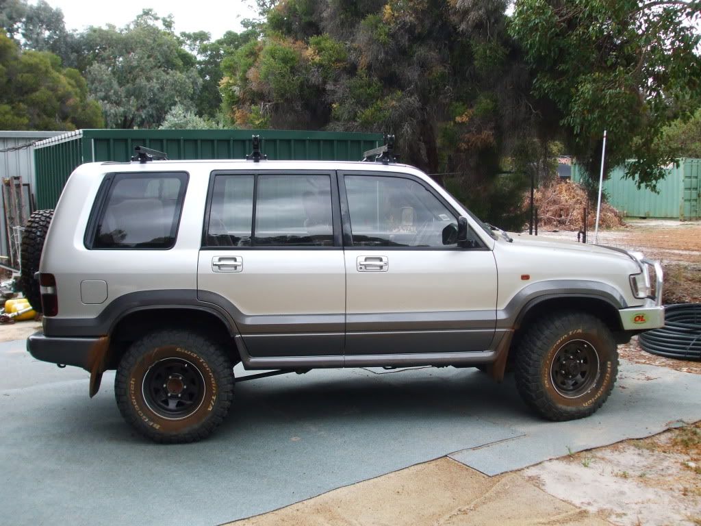

G'day all. I've finally gotten around to making up one of these for my automobile. Firstly, my names Lindsay and I'm a Bunbury local. My first car was a 1991 Jackaroo and when I decided I wanted an upgrade, I had my heart set on a latermodel (98+) diesel varient. Anyways, a friend put me onto a car a colleague of hers was selling. It was however a petrol, but upon seeing it and driving it for the first time, well lets jsut say I now own a 1998 Jackaroo SE with the 3.5L V6 engine.
When I got it in Feb last year it was pretty much stock standard (inc. factory ECB bullbar). That has slowly been changing. The interior now boasts a new Stereo (bluetooth handsfree built in), new speakers, slim-line sub + amp to match, Roof mounted centre console containing a GME TX3220 UHF radio and ARB air compressor mounted under the drivers seat.
On the outside, the 2 hella spotties have been replaced with 2 Lightforce 170 Striker's with Crystal Blue Combo Lenses, personalised bonnet protector, Rhino cargo bars and shovel holder (alloy tray is in the shed until needed), Though Dog 40mm Bore Shocks and springs all round (2" lift) and most importantly, a set of 31" BFG KM2 mud terrain tyres on black steel rims.
Got some pictures but need to get a some better ones of it actually offroading. Hopefully a trip up Mundaring will fix that.

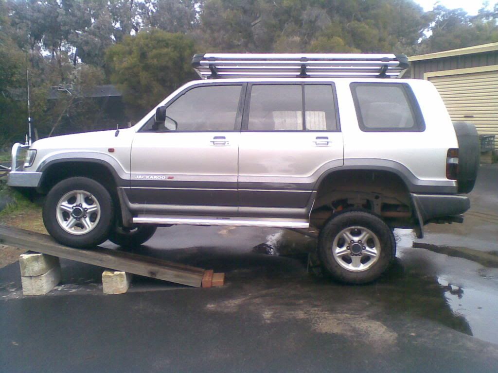

As it stands with the Rhino Rack and Lightforce spotties. The alloy tray is the perfect
size for my double swag which makes for a good place to sleep - just don't forget when
you get up in the middle of the night.
A bit of articulation testing.

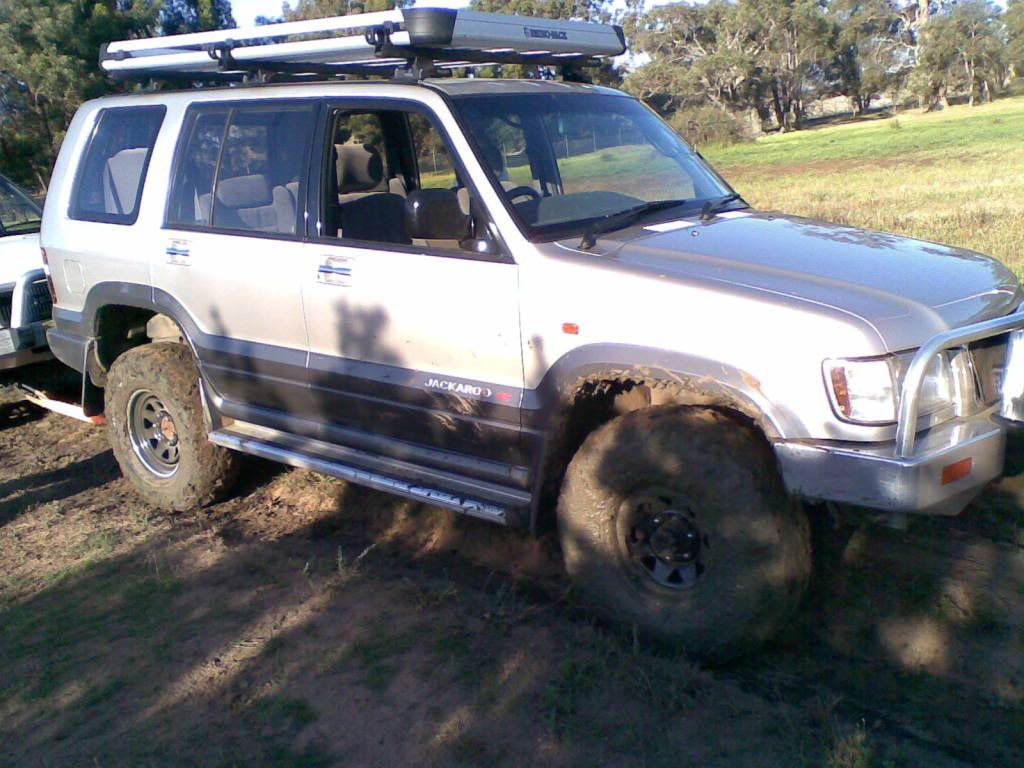

Getting the new tyres dirty

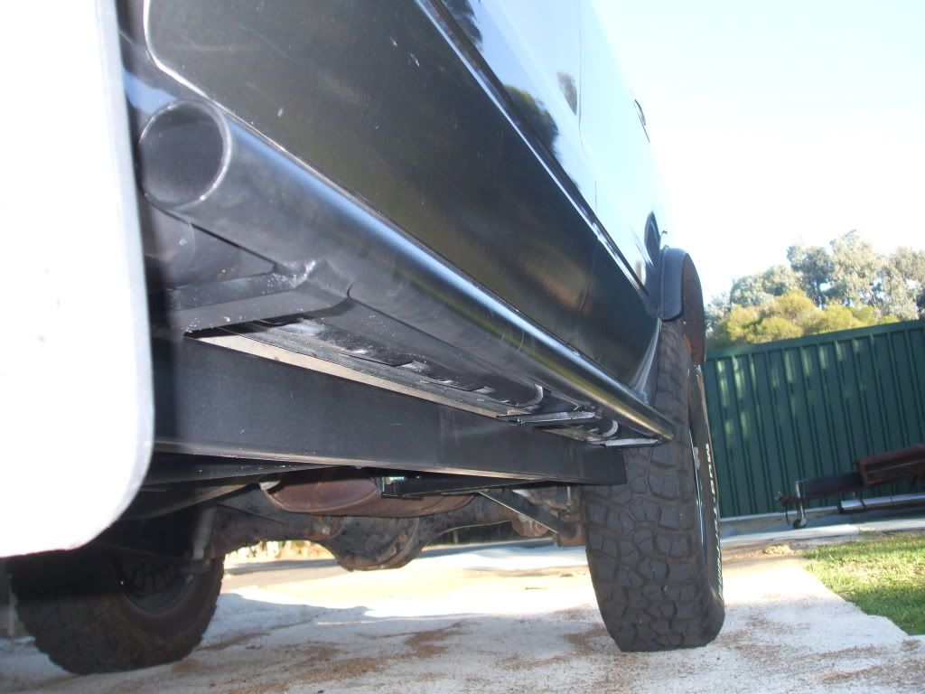

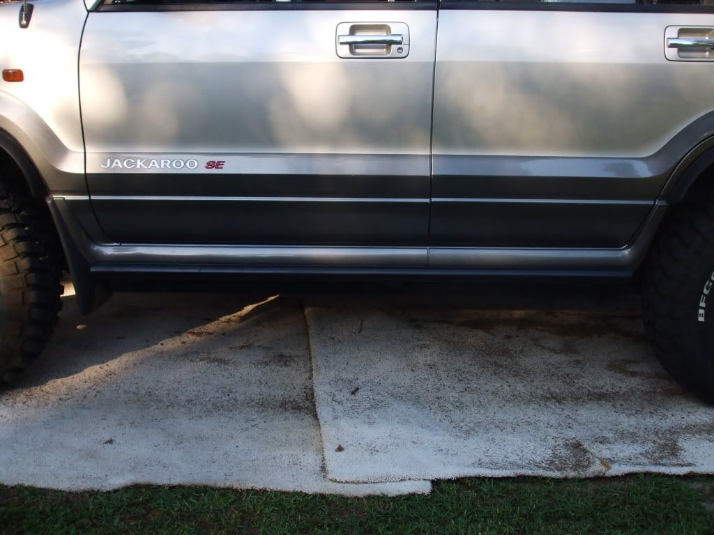

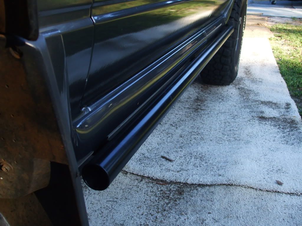

Unread post by Sir Snagger » April 19th, 2010, 7:01 pm
Well it's finally done. Took the aluminium steps after a cppl of rocks demonstrated that they
really are only for standing on, not resting your car on! So after a few hours with a local fabricator
(thanks to Surfjoy for putting us in contact Image) we came up with the below results.
Before Sliders
With Sliders
3mm Round Tube Side Slider
4mm Rectangular Tube Main Slider
10mm Steel Plate support
Steel Right Angle with brace welded under the chassis instead of vertically on the side because of limited space near rear wheels.
