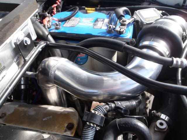

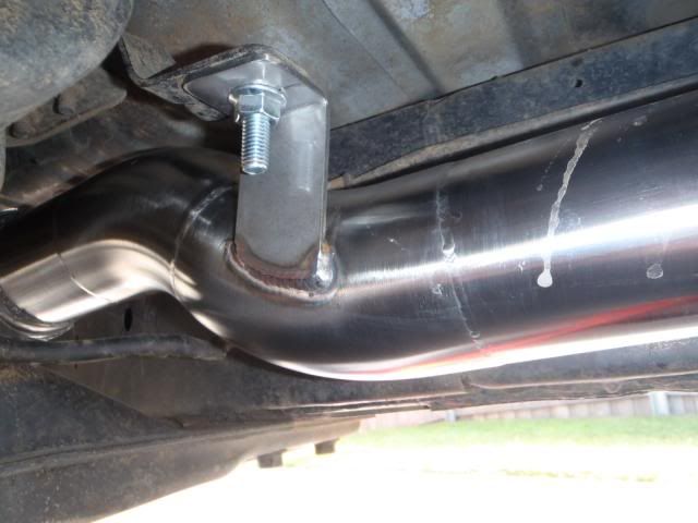

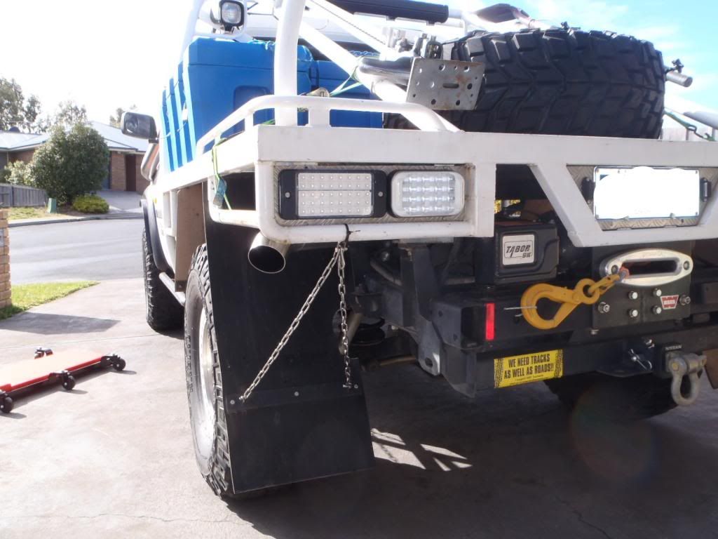

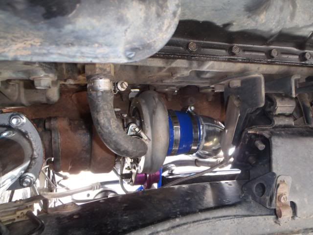

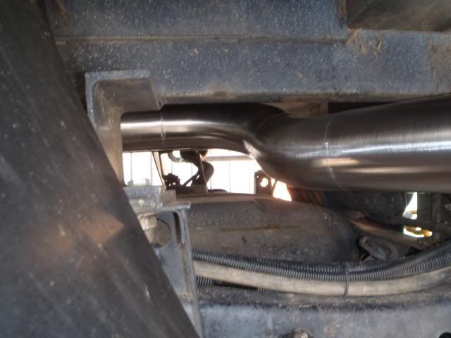

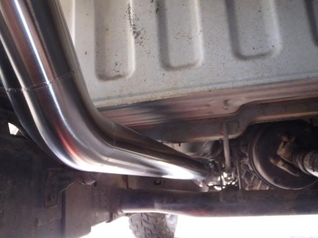

I handed the keys to the Patrol over to Pro Fab on Monday and left them to tidy up a few items. The ute had a cheap 3" exhaust on it when I bought it, none of the mounts lined up and it contacted the chassis in places, this was first on the job list. Secondly I wasn't happy with the intake plumbing between my airbox and turbo, I'd modified the factory intake and wasn't 100% confident in its watertight integrity.
Left it here Monday morning with huge expectations about the quality of their work, picked it up a couple of hours ago and they haven't disappointed me :D
Originally had planned on dumping the exhaust just over the chassis but as was pointed put to me it then tends to soot up around the tail lights and rear of the tray so went right to the edge. The idea's grown on me, can also see from the passenger mirror when it starts blowing a bit of soot on the hills.
Couldn't possibly have tucked it in any tighter to the body.
Take a look at those welds! Every bit as good as my snorkel.
Airbox to turbo pipework also turned out beautifully. plenty of clearance between exhaust manifold and the new pipework (One of my silicon bends was just touching the heat shield before)

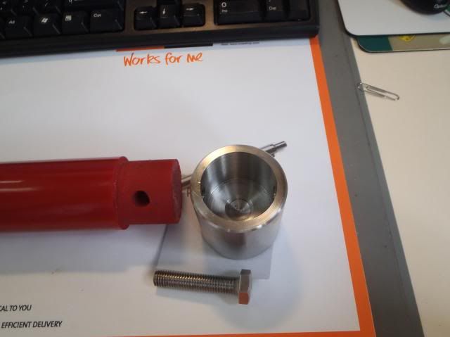

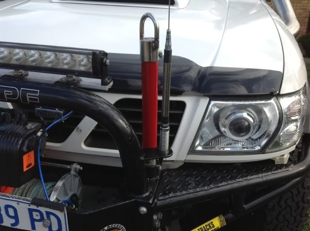

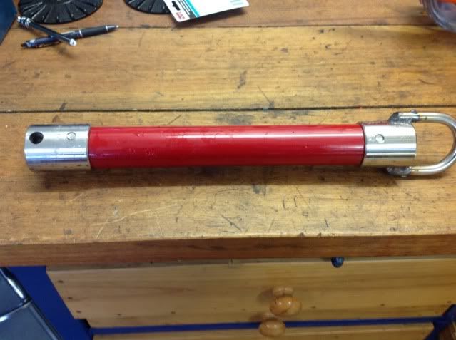

I wanted somewhere to stow my winch hook offroad, can be pretty inconvenient when it's hooked to your chassis rail and you have to start digging to retrieve it.
Machined up a couple of stainless end caps and a suitable piece of poly material at work.
Pulled out the tig to add the top hook, welds aren't the prettiest but practice makes perfect.
Mounted to the winch bar.
Just clips into place so it's not there all the time.

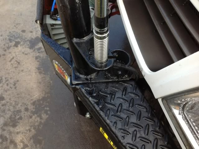

Bolted on a set of Pedes, what a difference they make!
