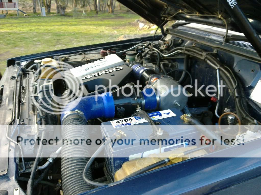

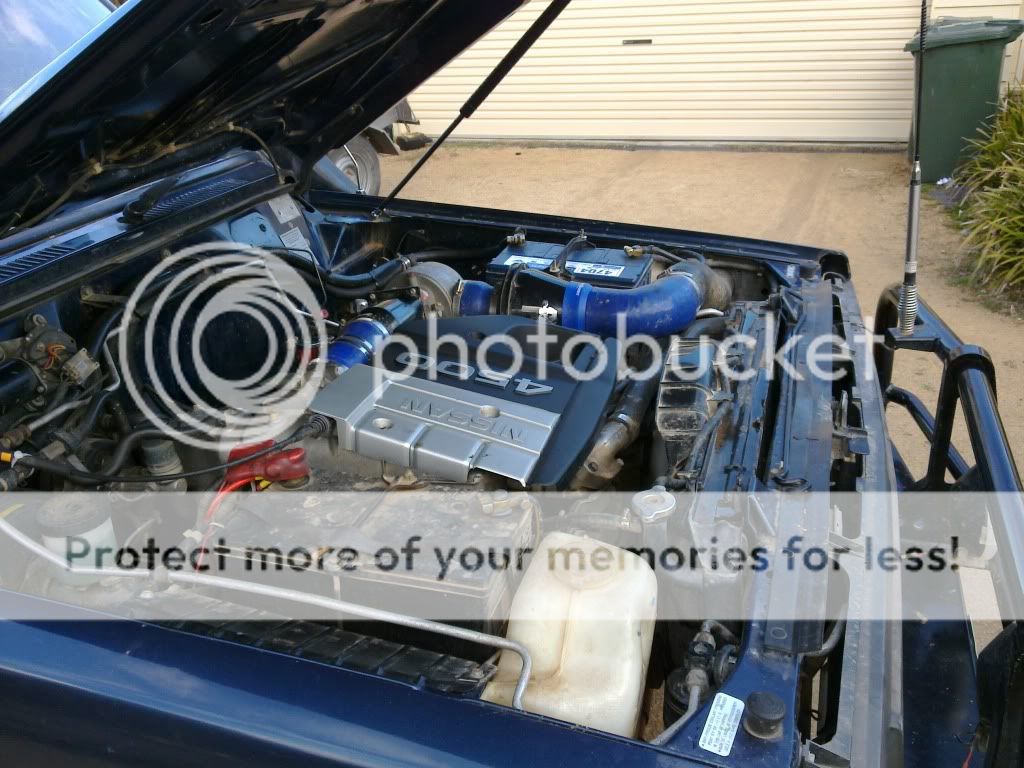

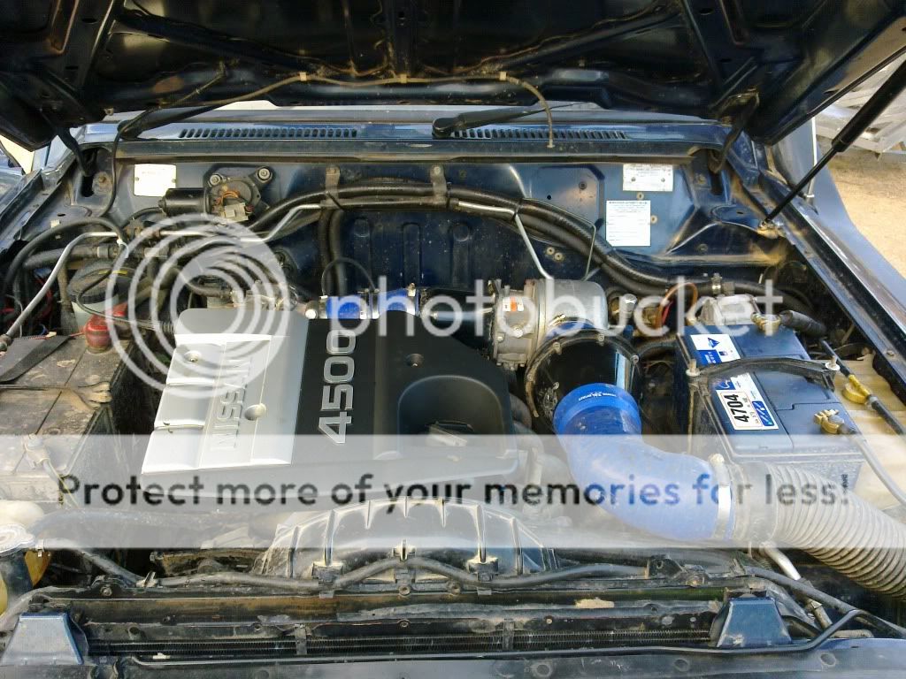

I went out wheeling just before xmas and cooked my TB42 engine in the heat. I dont think I cracked the head but it was a good excuse to change anyway. My radiator was clagged and I was pushing too hard.
This forced me to change the engine fast. I ended up putting the TB45 head on a standard TB42 block just to get the GQ running again.
I am using a TB45 stainless steel head gasket.
The engine has been in since boxing day and I have done a short trip down to Jindabyne and Mt Pinnibar. The engine is awesome. It has much better torque and power. I found I can 4wheel one gear higher than before. So a hill in 2nd low I can no do in 3rd low. The engine braking is better too it doesnt run away on a hill so much.
I have a small oil leak at the front of the head where it overlaps the timing cover. I'm not pulling the head back off to fix it. A bit of silicone will have to do for now.
I will post a pic or two when I get home tonight.

More pics from today

I've now got the engine running well. Its taken a bit of work to fix ignition gremlins and dizzy problems. I had the dizzy regraphed for total lpg. They lightened the bob weight springs to get advance sooner. The bob weights have been limited to half advance also. Vacuum advance has been removed. I replaced all spark plugs and ignition leads as the engine was breaking down under load.
I was due for rego so I went through the process of getting the engine changed on the rego papers with the RTA. I had to get a blue slip done for the engine change and also a pink slip for registration renewal. The engine passed first go with no problems. As the engine mounts were the same and I had previously upgraded to a disc brake rear end the engineer was happy.
Here's a couple of pics.
