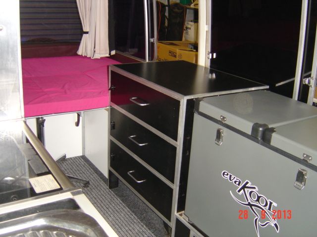

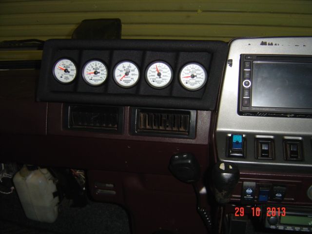

After the experience with the auto failing I've invested lots of time & money into 5 Autometer gauges;
Oil pressure
Pyrometer / EGT
Boost
Water temp
Transmission temp
couldn't get them all locally so got them all through Summit Racing in the US. Cost was 1000 inc freight and they were here in 8 days. If I could get them in Aus they would probably have costed 1400.
That of course meant I had to make my own mounting and they are all angled slightly towards driver for easier viewing.
I also decided to replace the stabiliser even though it still works fine and then thought, 'why not just fit both of them'?

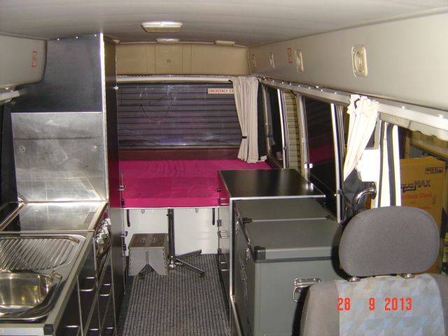

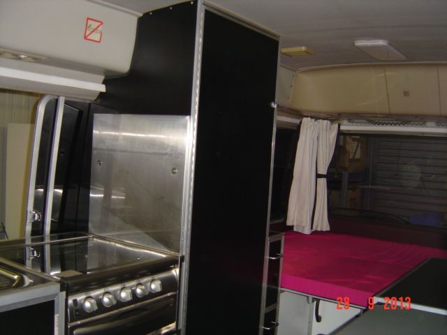

Here are some shots of the interior all finished, no more work to be done there at least!
The auto is all sorted and shifting better than ever, the Guys at DTM in Geelong do a good job and spent a lot of time getting the shifts right.
