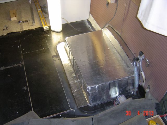

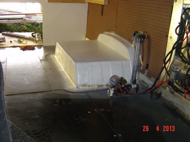

So for the last 2 months I’ve been busy working on the list!
wheel arches cut down about 110mm
Wheel arches filled in & painted
covered in Resomat insulation

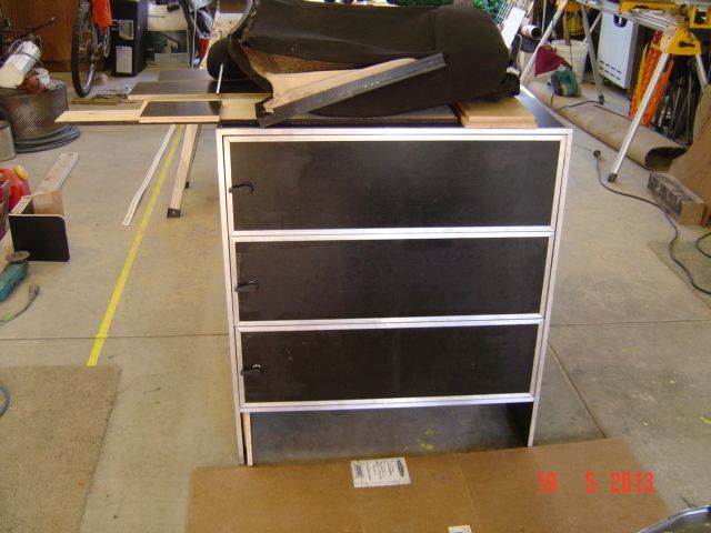

extra cupboard - 3 drawer unit

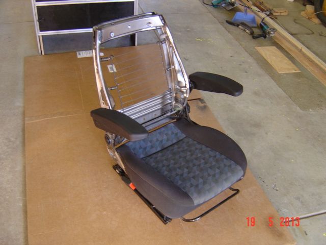

Finished fitting the armrests to passenger seat and it was easier than I thought it would be and looks like factory finish.
I used a soldering iron to burn the holes in the side fabric for the retaining bolts. This seals the edge of the hole so the fabric should stay intact. Armrests have adjustable angle via a dial under the rest as well as folding back fully of course.

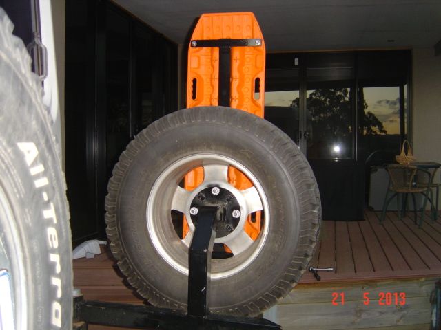

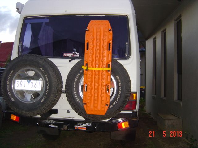

Here 's a couple of pics of the Maxtrax carrier.
The yellow strap just holds the Maxtrax to each other but isn't needed when on the carrier. I used the pins sold specifically to mount the Maxtrax, at about $26 you wouldn't bother trying to make them. They are stainless bolt & nyloc with keyhole shaped plastic lugs which rotate and lock at 90deg to hold the trax on.
I will put the strap around the trax and through the spare wheel as added security on a trip.

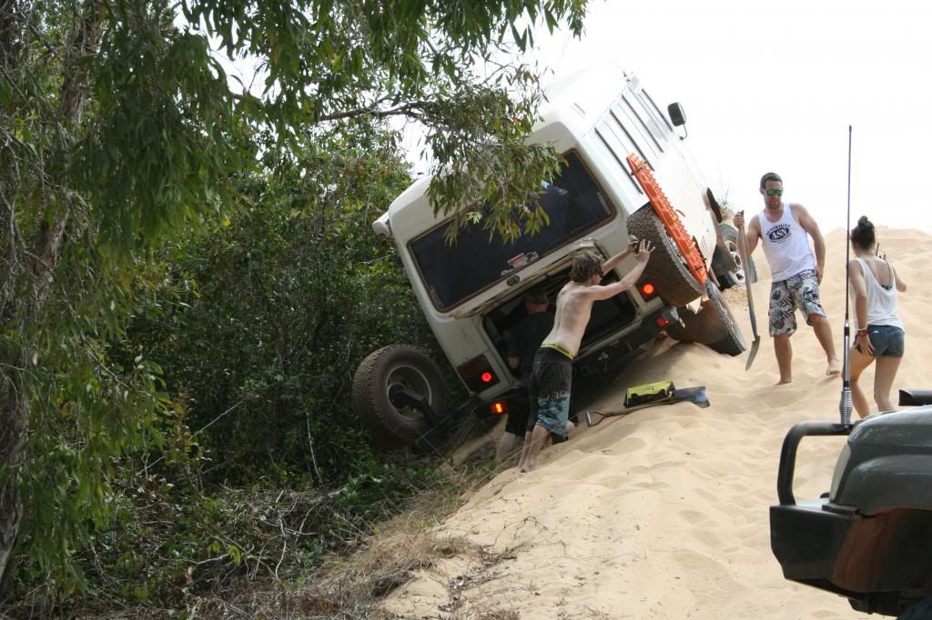

Unread post by 4x4Coaster » August 1st, 2013, 6:45 pm
I've started a thread in the Trip Report - Queensland section for details of the Cape Trip for anyone interested.
here is a teaser!
