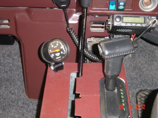

I have just finished fitting a tacho at last, it is a diesel type so it picks up a signal from a sensor strapped to the alternator, it has a range of 5000rpm which is nearly double my usable rev range.

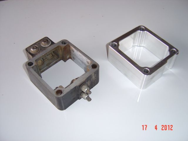

I have also replaced my heater section on the intake manifold. Originally it had a heater in it for cold climates but it’s no needed here. I had previously removed the heater core and blanked out the holes with bolts however I want to be sure there is no pressure loss and also to make it as streamlined as possible, you’ll get the idea from the pic attached!

Here is the tacho,
Here is the billet heater delete section compared to the original with element removed,

Unread post by Gojeep » April 28th, 2012, 9:40 pm
Nice delete piece. Did you draw it up and have it made on a CNC?

Unread post by stretch4x4 » April 28th, 2012, 10:51 pm
Yeah I am interested in that and cost too I have been told I should do that on my intake too..

Gojeep & stretch4x4, here is the company that made the heater delete. I bought it on ebay for about $60 and the freight was almost as much as the piece.
