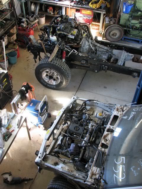

So now I'm on the hunt and shopping. Looking for a damaged Navara here in Aust. and an F250 in the US. Took awhile, but this is what I got. These pics are from the insurance auctions.
Cheers, Dave.

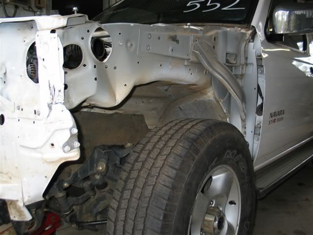

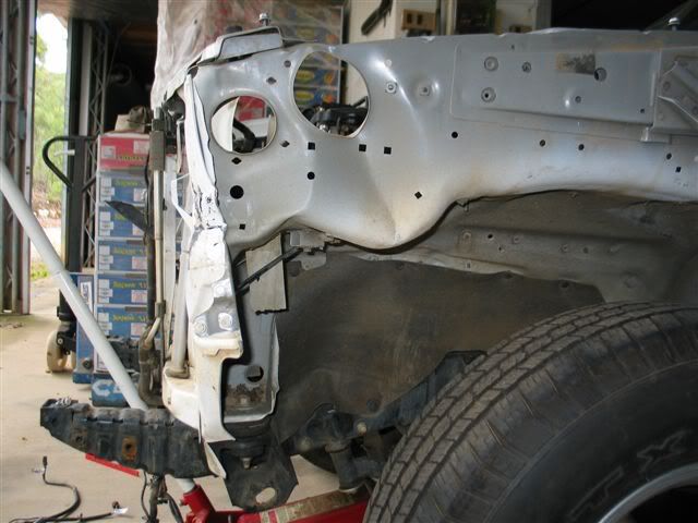

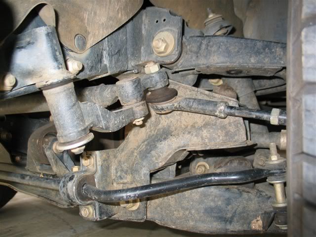

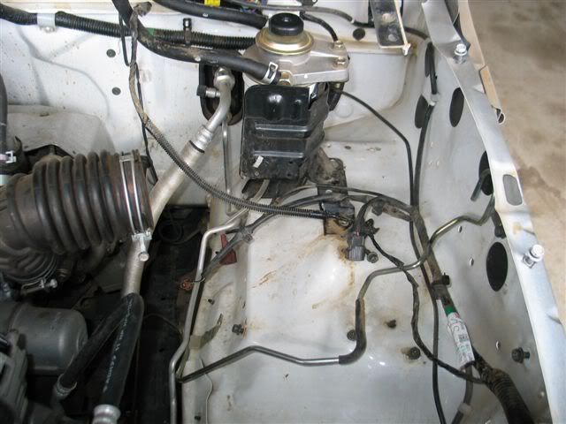

The Navara came from SA. Had, no, still has 54k km. Body looked like a likely candidate. I got it home a week before Christmas '06.
It was easy to see why it was written off. That hit on the front bent the left chassis rail a bit. The steering idler arm was hitting against a wishbone bracket. Not terribly difficult to fix, just quite a few hours. Whole body off to get portapower on to chassis. No smash repair place want to spend that sort of time on them, so they give ridiculously high repair quotes and insurance writes it off.......
Unfortunately, the body damage was also worse than I had hoped. The inner guard has crumpled a little, also moved the end of the bulkhead a bit. Not too worried because I'll be making all new inner guards anyway.

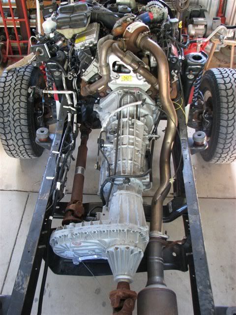

The F250 took me ages to nail. First I was just looking at getting the parts, but that risked missing too many little bits and pieces required. Wiring looms, throttle pedal, fuse panels (yes two), dash, various sensors, fuel pump etc. It was safer for me to get a whole vehicle that had been rolled or tail-ended, just to ensure I got all the parts needed.
In the meantime I found a guy on the Gold Coast that regularly imports stuff from the US. He has been great, done all the physical work in the US and dealt with customs and so on here. Just the guy I needed. Thanks Matt.:thumb:
There was two websites I was looking at:-
SALVAGE AUCTION CARS AND MOTOCYCLES FOR SALE
https://www.iaai-bid.com/login.aspx
The first one seemed to have a number of vehicles come up, but the bidding process is really a tendering scheme and not transparent enough. I really can't recommend them.
IAAI is just like Pickles or ManheimFowles here and I actually got to place a bid over the 'net, pretty cool. Which I couldn't do until I was sure about transport and so on. This was where Matt was essential.
Once I secured the F250, I shopped around and got several of the more expensive accessories from the US too. Wheels, tyres, air-lockers, hydraulic winch, adjustable shocks, heap of service filters and special atf fluid, airbags, air tank. Get this, the ARB air-lockers are made here in Aust. yet I can buy them from the US and ship them here cheaper than you can buy them locally???? Most of it was about 2/3 price even after paying shipping, gst and customs. What is with our retailers????????
So I got all this stuff sent to Matt's mate's place, where he works from in the US. Here he stripped the F250 down to just what I needed. This allowed him to get another vehicle in the container.
Here's a pic of the F250 ready to shoehorn into the container......
Cheers, Dave.
