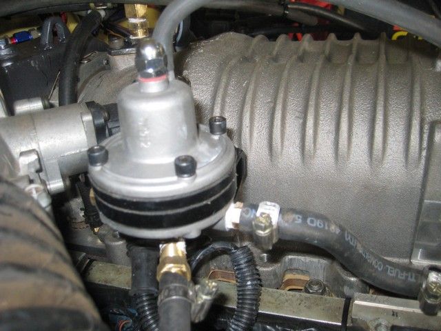

I now have to look at the tuning though, it is leaning off under load. I think the after market fuel regulator is not up to the job, I have just refitted the factory regulator on and I will see if it is better.
I think I need a 1/1.9 not 1/1.1 ratio fuel regulator.

I am finding that when the boost is around 3lbs and the engine is under load it appears to be running lean. I have fitted a new double diaphragm fuel regulator
(which gave me some grief, as it had been assembled wrong in the factory)
on to the engine, but this has not helped a lot.
I don't think it is rising the fuel pressure enough to over come boost, as it is only rising an extra 4lbs above standard.
After doing a lot of reading on the 1uzfe engine with a supercharger, this has surprised me a little as most people run 6lbs of boost and don't have a problem. I think I am having the problem due to the weight difference from the cars compared to my Nissan, around 1ton at a guess.

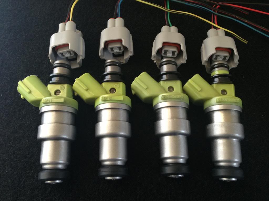

I have been taking some advice, and I think the best way is to now upgrade the fuel injectors, from 255cc to 315cc, this is often done when using a higher boost than I am running.
I can buy refurbished injectors out of the states for around $250 delivered so this may be what I need to do.
Not my photo, but these are the type of injectors I need, Denso 23250-70080 as they are a direct fit.

My new injectors arrived while I was in Townsville, I decided as I was fitting them I would remove the cold start injector as I thought that it would become irrelevant with the bigger injectors.
The grey units are the standard ones, the new units arrived with all the rubbers to fit so I was not a big job.
Once fitted I found no difference once the ecu had a couple of restarts and test drives, although I thought on start up if might have been richer, but I am not convinced this is a good fix with my current setup.
