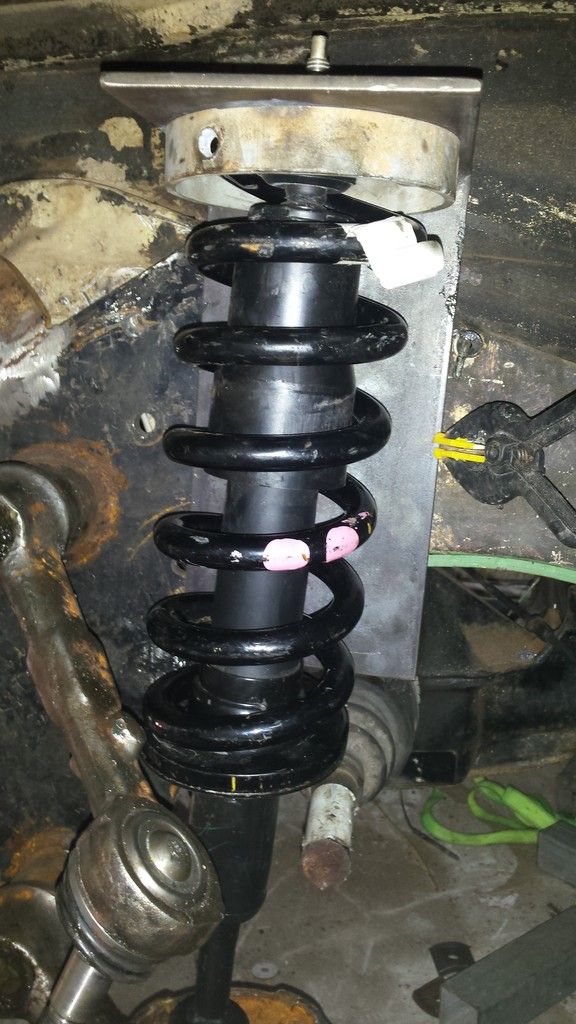

Good evening all. been doing some mods on the kombi front suspension I redrilled the holes that mount the beam to the body to give it an extra 6cms of body lift. the VW uses flat spring plates as torsion bars in the front tubes these are weak from age * new ones don't help much to maintain the height I want. After some time researching 4wd front coilovers I came upon a set out of a late model Ford Ranger with a piece of 6mm thick plate I have been able to mount them to the front end. this will make the front a lot firmer. The existing bars will rotate free in the tubes & retain the control arms
This is the template to strengthen the top mount point
this is approx lift may have about another 3cm.

G'day all. A week of jacking up & letting down to set up the front end.
this is the front end sitting on original VW torsion spring plates
with the Ranger coilovers fitted
After posting pics of the coilovers sitting on the lower shock stud in the lower arm some of the VW blokes questioned the strength of the stud. After a lot of thinking & cutting out patterns I cam up with a part that will relocate the mount to the top of the stud & provide a sound base for it
This is the pattern formed to see how it would work.
these are the 4mm thick plates prior to assembly
Assembled unit it has a 25mm x 50mm tube inside that the stud fits into It also bolts up through the original swaybar hole & has a 25mm x 1.5 strip welded down 1 side for strength
This is how the coilover will sit on top of the arm.
