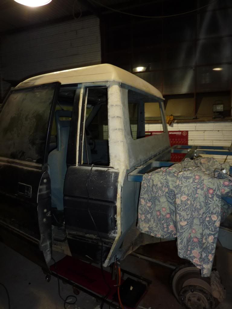

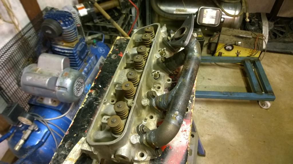

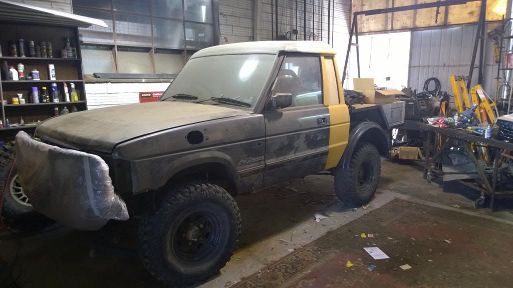

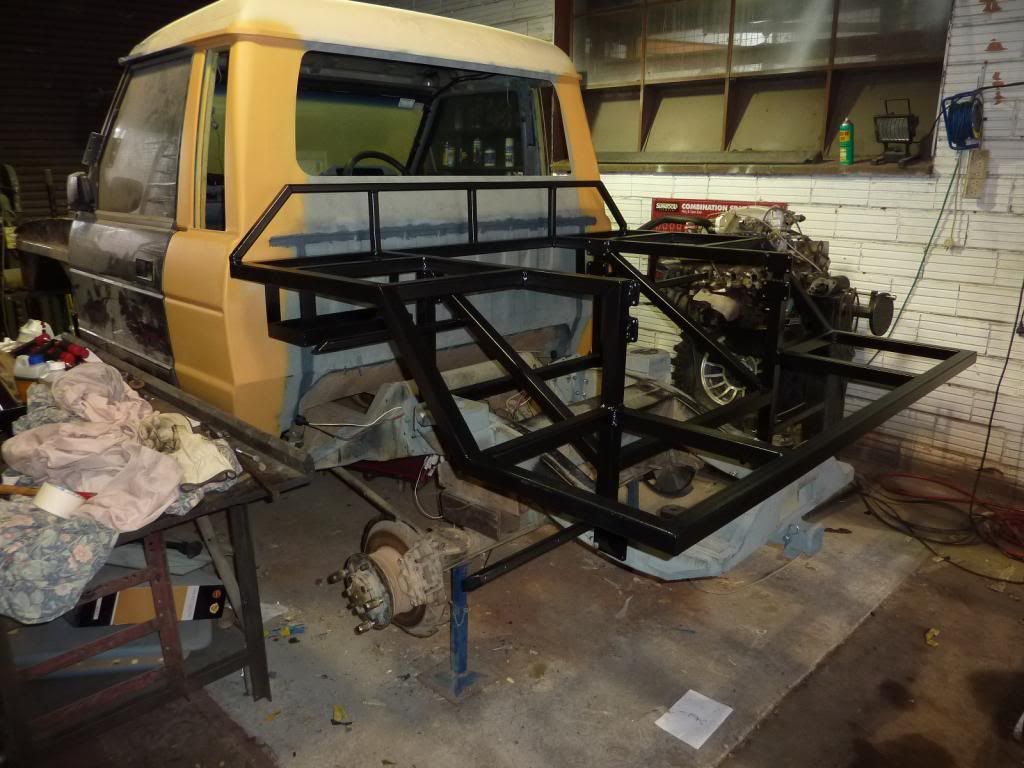

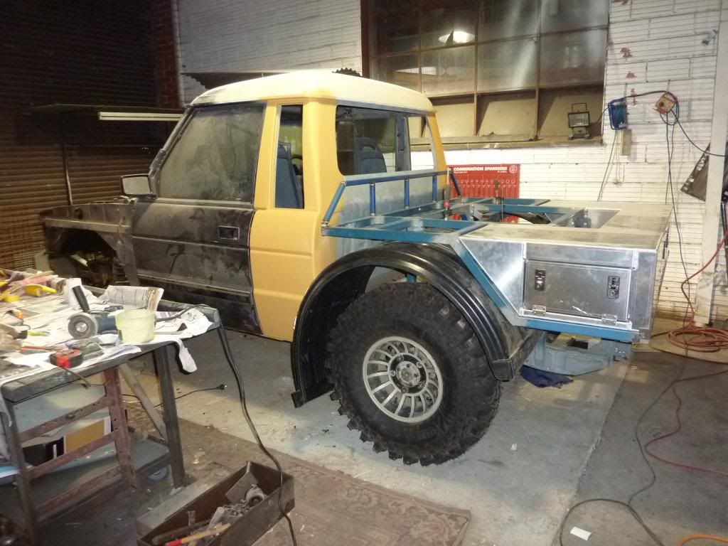

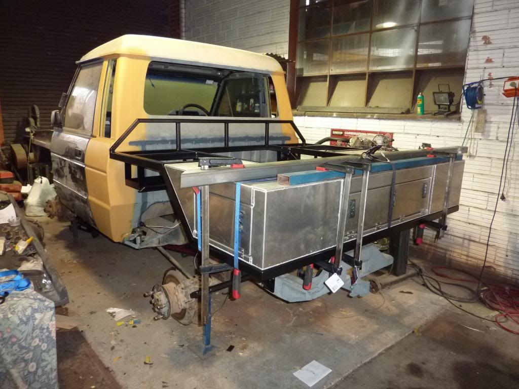

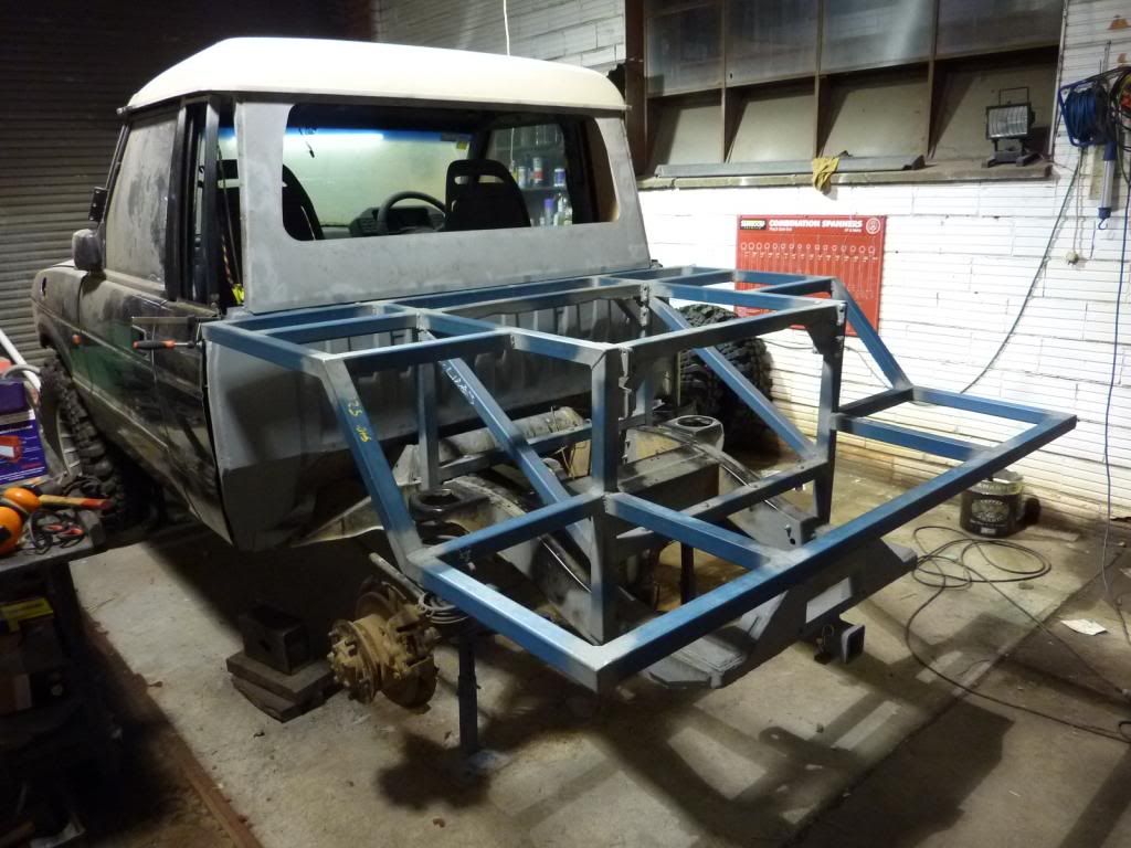

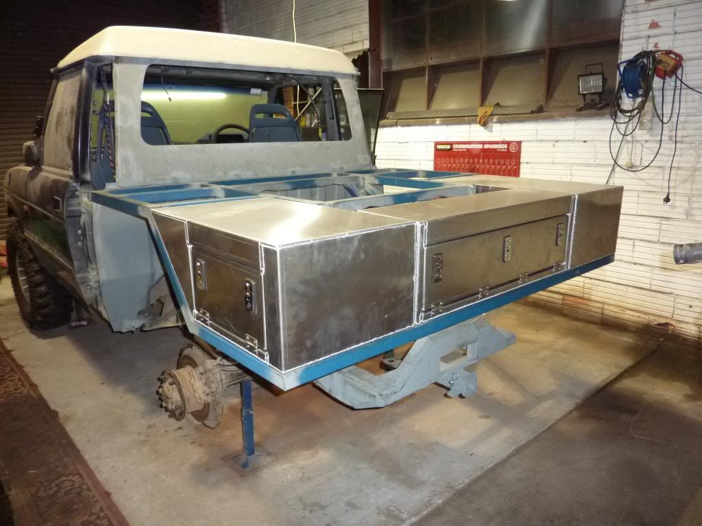

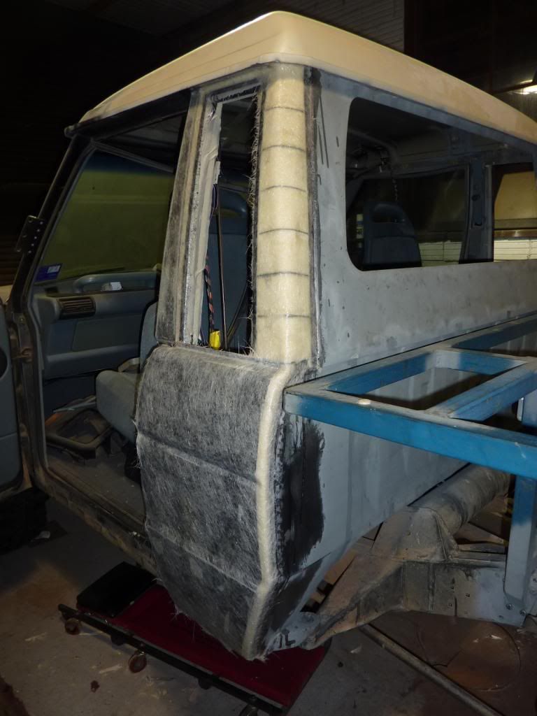

Here are a small selection of photos from the build.

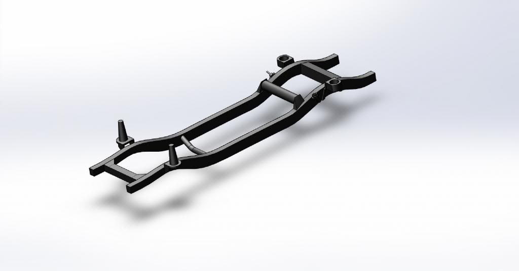

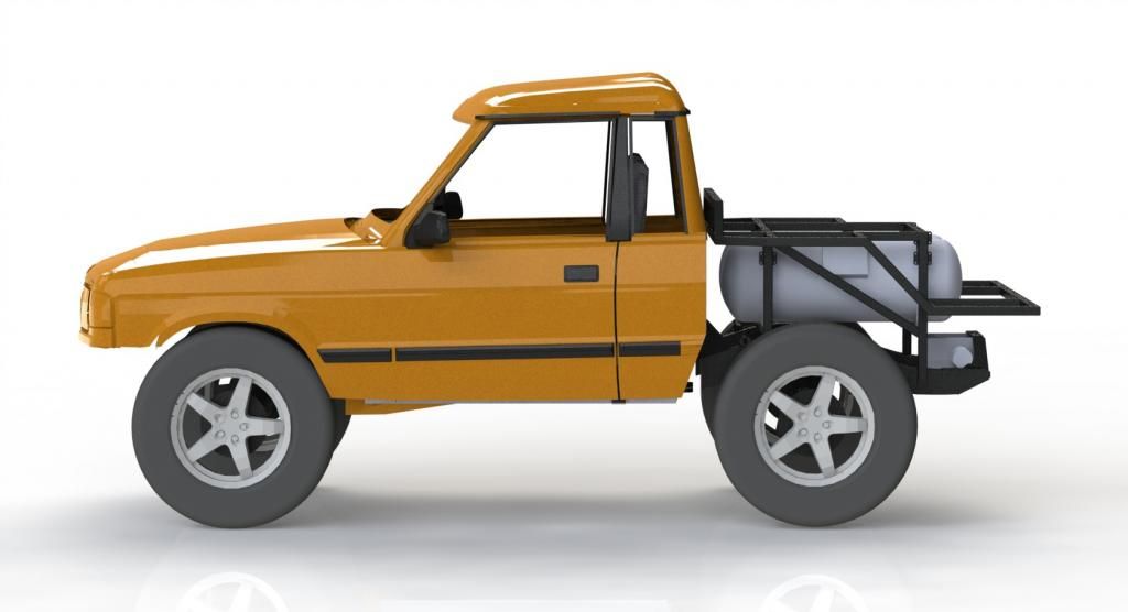

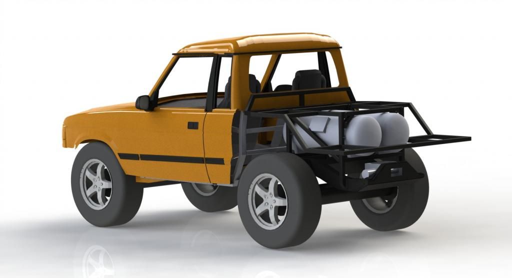

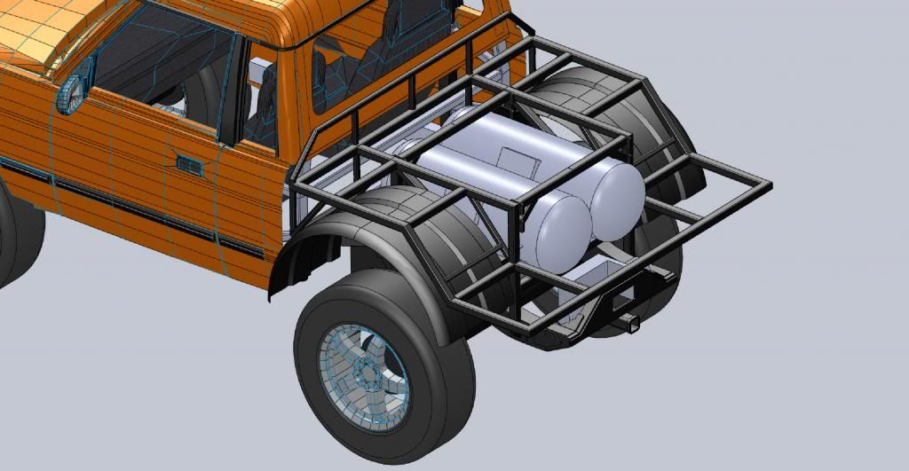

Thanks for the comments everyone! Being able to draw the car up in 3D before doing any of the major work was a major benefit, having drawings of parts I needed to build made the process of ordering materials and cutting parts a lot more accurate! Plus, I could have a head start in checking to see if anything would foul.

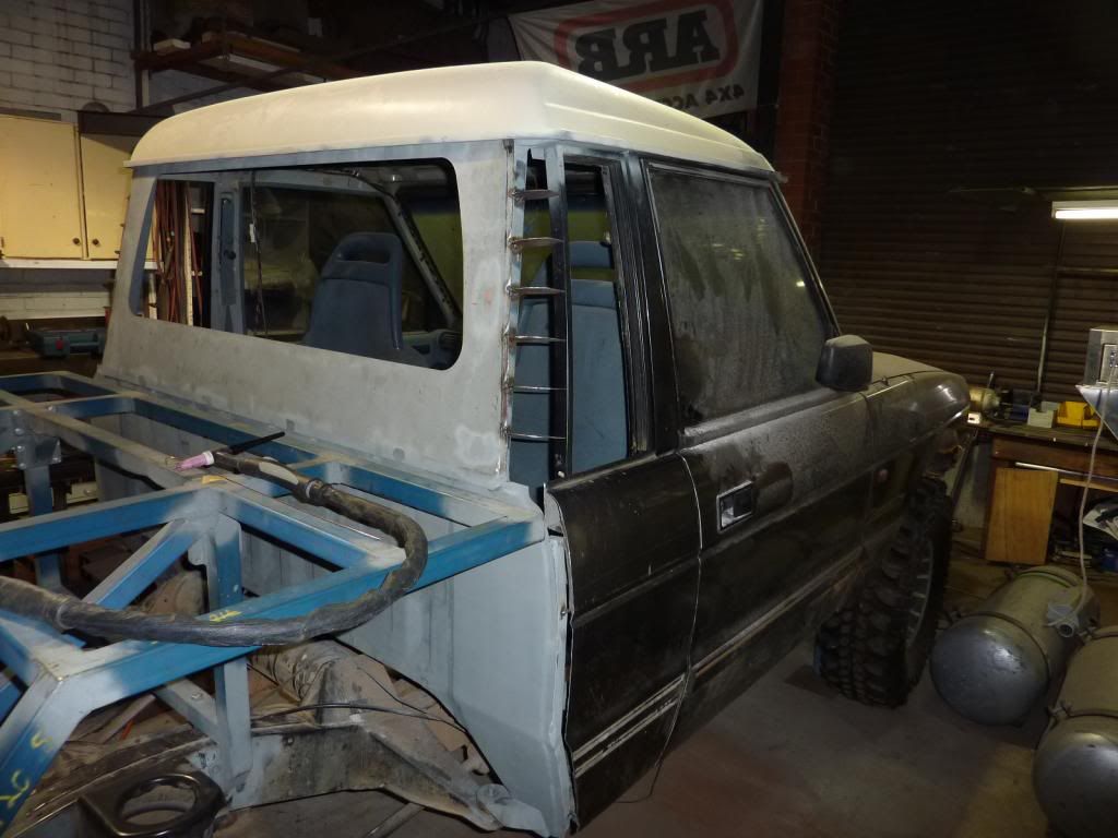

Another weekend down and some more progress. Again thanks goes out to Derrick for helping me out in the workshop. Below are the shots.
The engine was removed. As you can see no love was given to the engine sitting in the engine bay, I was stepping all over it while undoing bolts.
And it was finally out.
Then we moved on to getting the gearbox out, which proved to be a little trickier since the car was sitting so low (no springs). But I managed to get out out via the engine bay.
As I mentioned before, the automatic gearbox is ready for delivery, I just need to pull off the transfer case from the original gearbox so that I can send the transmission off as part of the exchange.
Also, the new engine is ready for delivery, I'm just sorting out purchasing some axles while I'm at it.
Next week will most likely be pressure washing the engine bay and underside of the car followed by modifying the front spring perches to raise them by 2". Then I guess I'll start putting the new engine together!

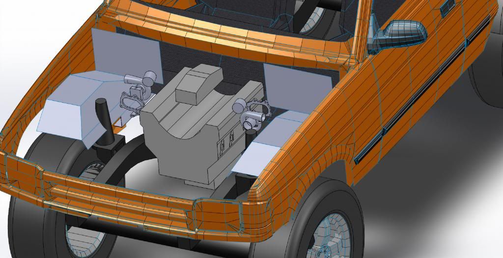

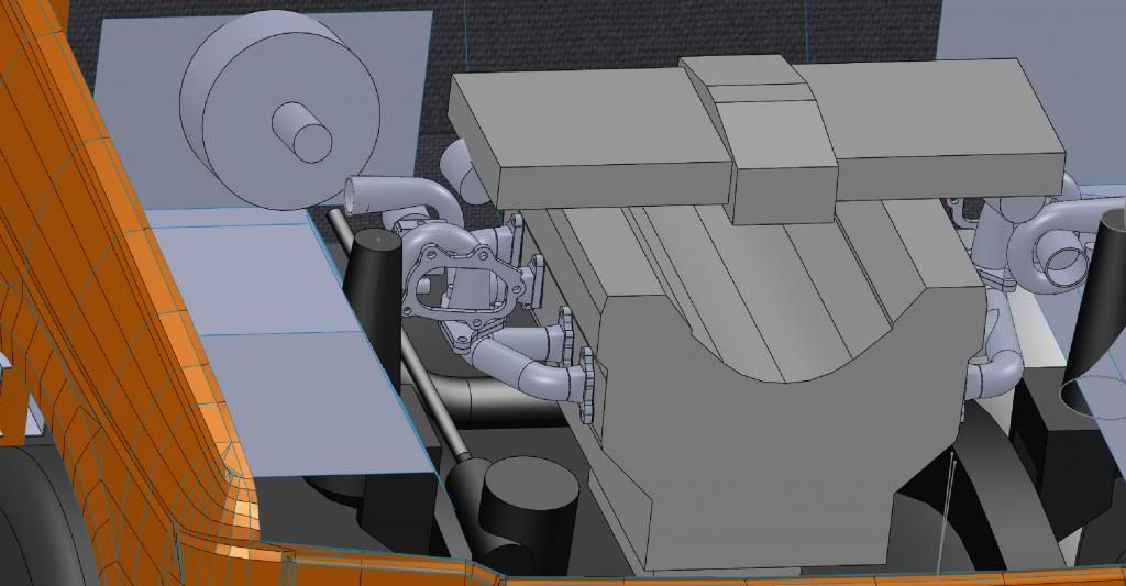

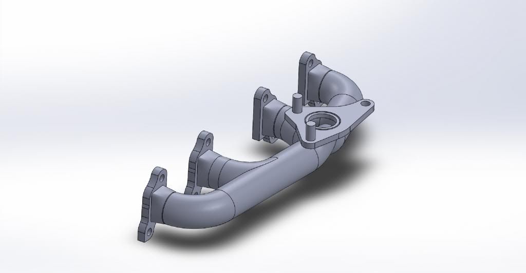

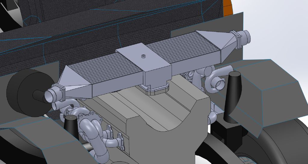

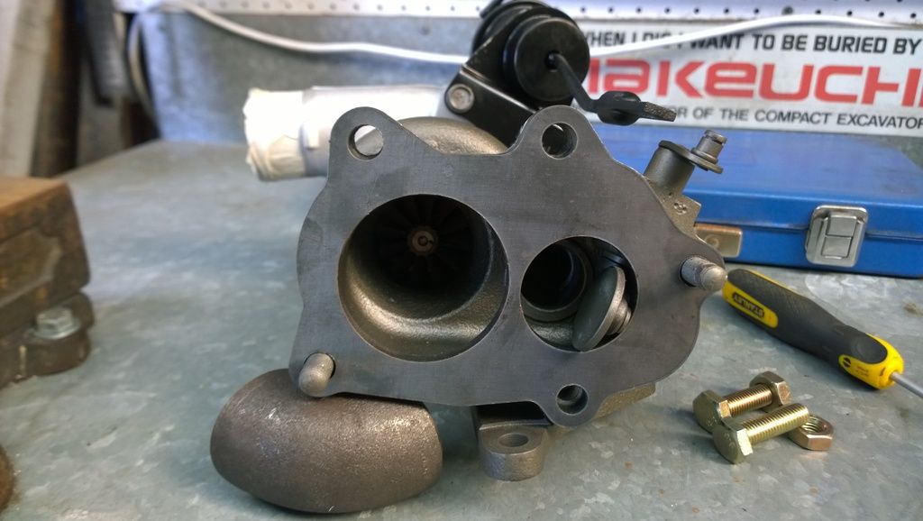

Spent some time tinkering in Solidworks. Plus putting in a lot of orders for things like:
Oil Coolers
Water proof enclosure & connectors for ECU
Pressure Transmitters
Temperature Senders
And so on...

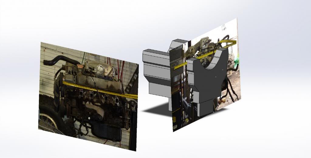

I've bought a pair of Derale 15800 oil coolers, one will be for the engine and the other for the transmission. Each controlled via the ECU by oil temperature senders. Below is what the unit looks like (It should arrive in the next week or so)
And below (in blue) is where I plan to mount them. According to my 3D model, they should JUST fit in. I'll find out soon if this is right!
I also did some quick exploring on how much modification I'm going to have to do to the bonnet to clear the intercoolers and the fans for them. The answer is... A lot... It's going to be quite a bulge! plus I need to blend in a scoop. Should end up looking pretty agressive I think.

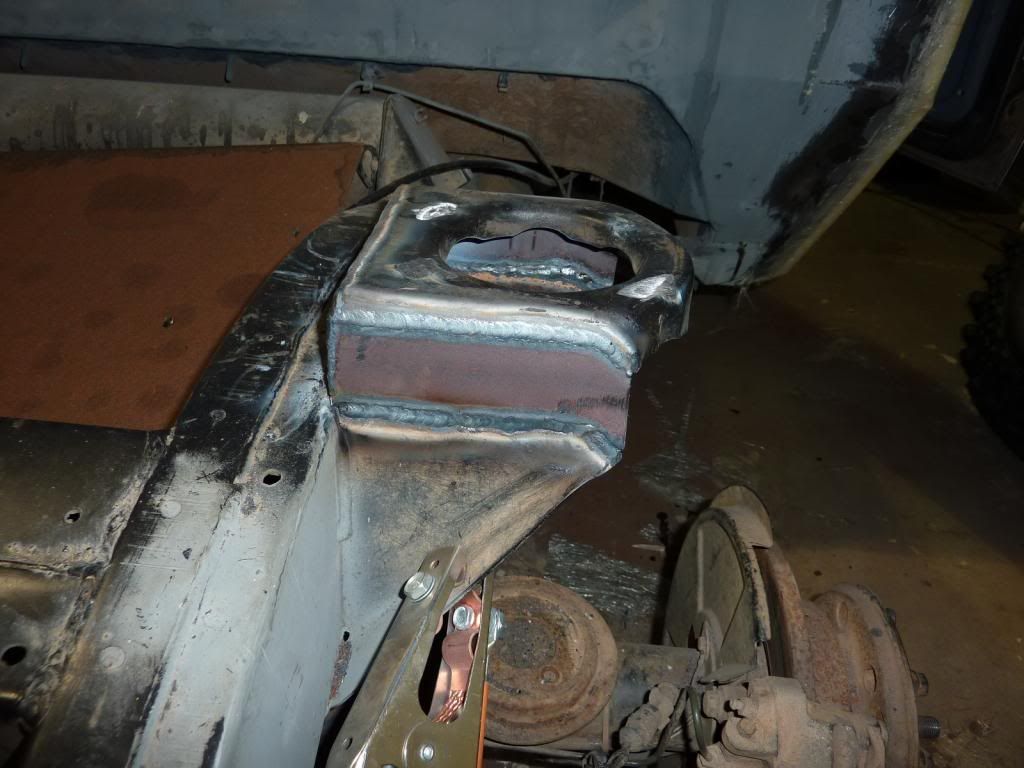

While the seam sealer on the righ hand guard cured and the primer paint on the left hand guard dried, we moved onto the spring perch modifications:
With all the cold weather going around, it was necessary for me to wrap the guard in an electric blanket which I modified to remove the auto off timer. This is so the primer paint would continue to cure over night.
Next day, the right hand guard was top coated in a light grey paint and I finished welding up the 50mm extensions to the spring perches.
