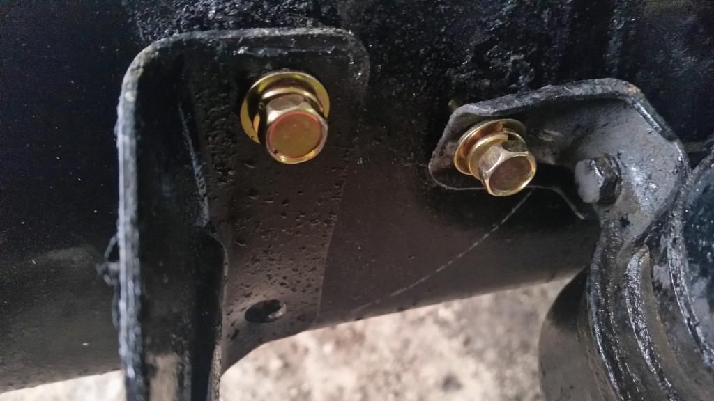

I bolted a few parts back onto the chassis and its starting to look good with the zinc plated bolts and the gloss black parts.

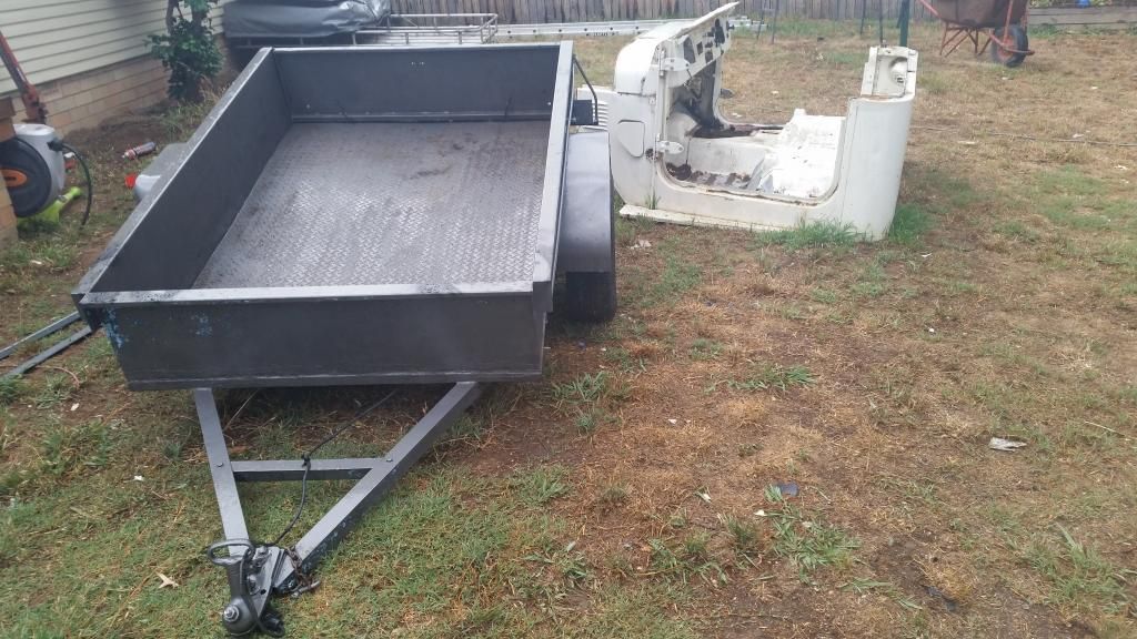

Body is going onto the traielr tomorrow so I can start to weld in some new steel for the footwells.

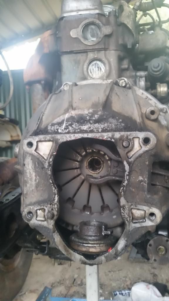

and I have lined up a new bell housing with a taco sender ! that was a bit of a score. so I got a new slave cylinder as well to prevent any problems appearing down the road.
This is the old with the new to come.

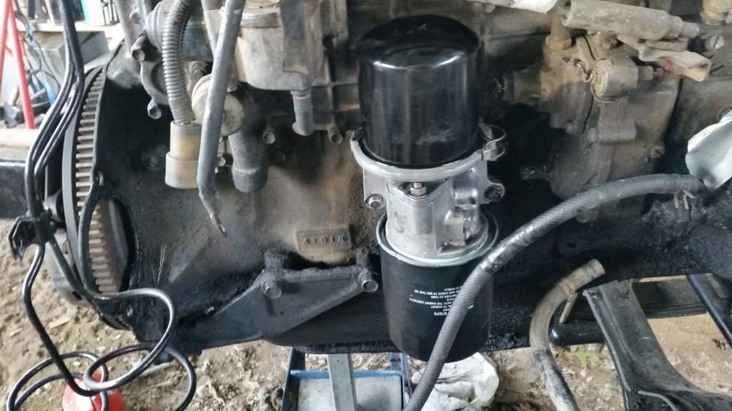

So this is just because I feel like I need to feed you updates. . . . . . . . . so heres the latest pics, can you guess what part I have cleaned.

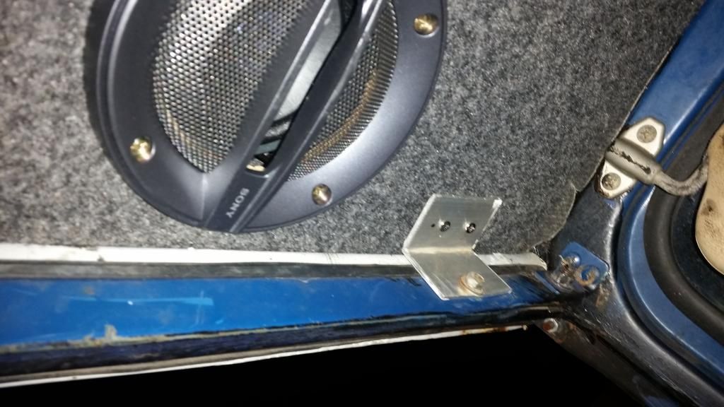

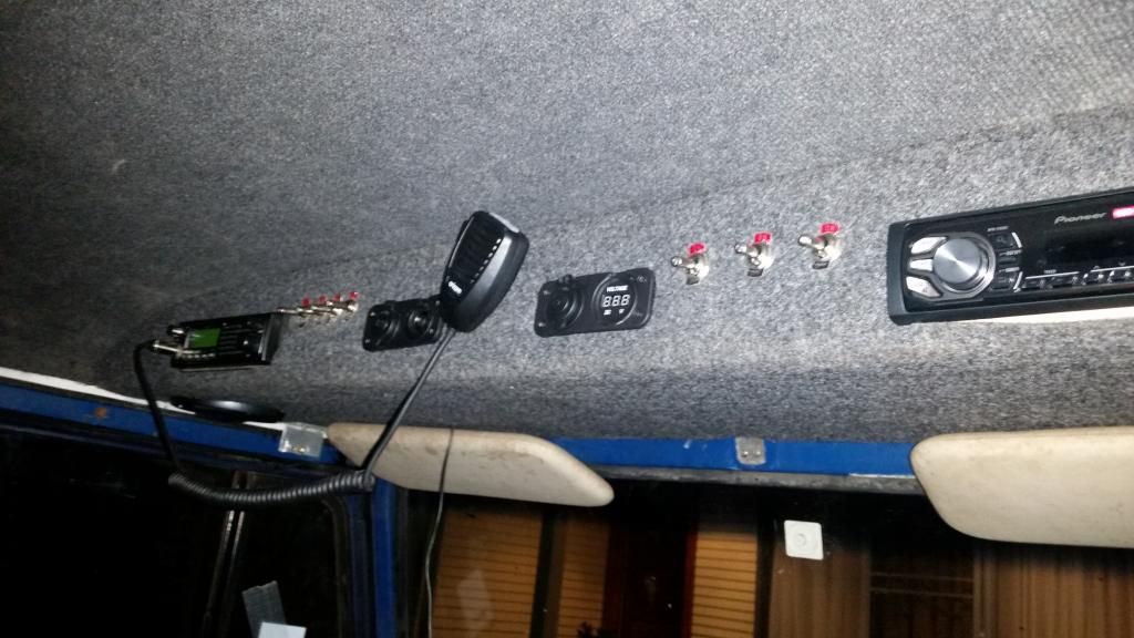

Roof console is done! Its in the troopy at the moment, but it will bolt right out and go into the ute when its done.
I also started a bracket that will hold my high lift on the foot rest passenger side, the same little mount will hold the UHF aerial.

Rogers Cruiser wrote:So this is just because I feel like I need to feed you updates. . . . . . . . . so heres the latest pics, can you guess what part I have cleaned.
Best oil filter ever! Cheesed that the 2H in my 60 didn't have one.

Huh what's so good about it? It's just an oil filter.. :confused:

Indy Hepburn wrote:Huh what's so good about it? It's just an oil filter.. :confused:
Thats not just an oil filter thats a double filter, the bottom one is a normal oil filter and the top one is a centripital (spelling?) oil filter, basically it spins the gunk out of the oil, and it gets cleaned out every now and then.

Ahh now I understand ;)

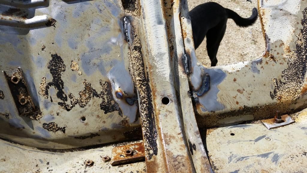

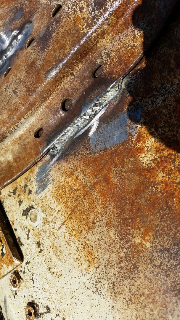

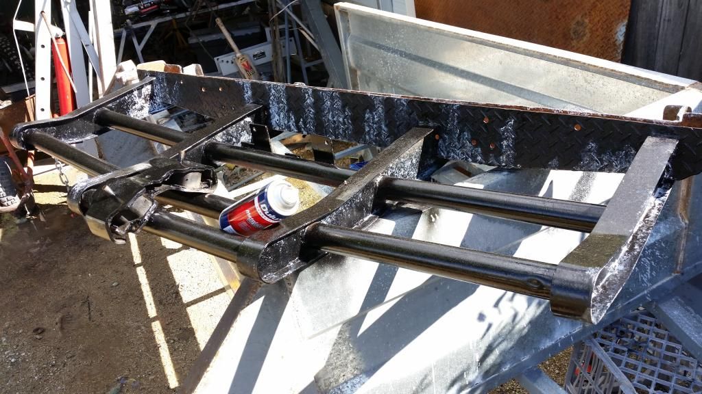

I got the itch to do some fabrication this week, and since I didnt have steel for the trailer I decided to weld up some mounts on the bullbar, and weld up the cracks in the passenger side wheel arch, the bullbar was rust converted before painting, and I forgot to wash it of, so I need to paint it again :redface:

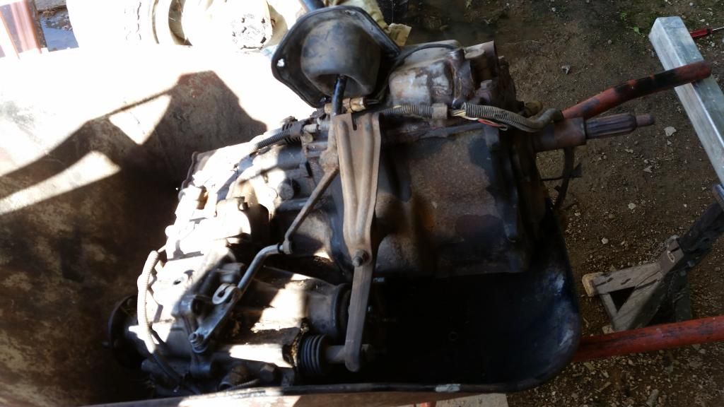

I picked up (or picked out - as I had to pull it from the truck myself) my 60 series 5 speed, however I still dont have a bellhousing, the 60 series had a marks adaptor LS1 bellhousing, which should fetch a few $$.
I will be using the 47 series crossmember and transmission mount, with the 60 series transmission so I cleaned up the old mount.
