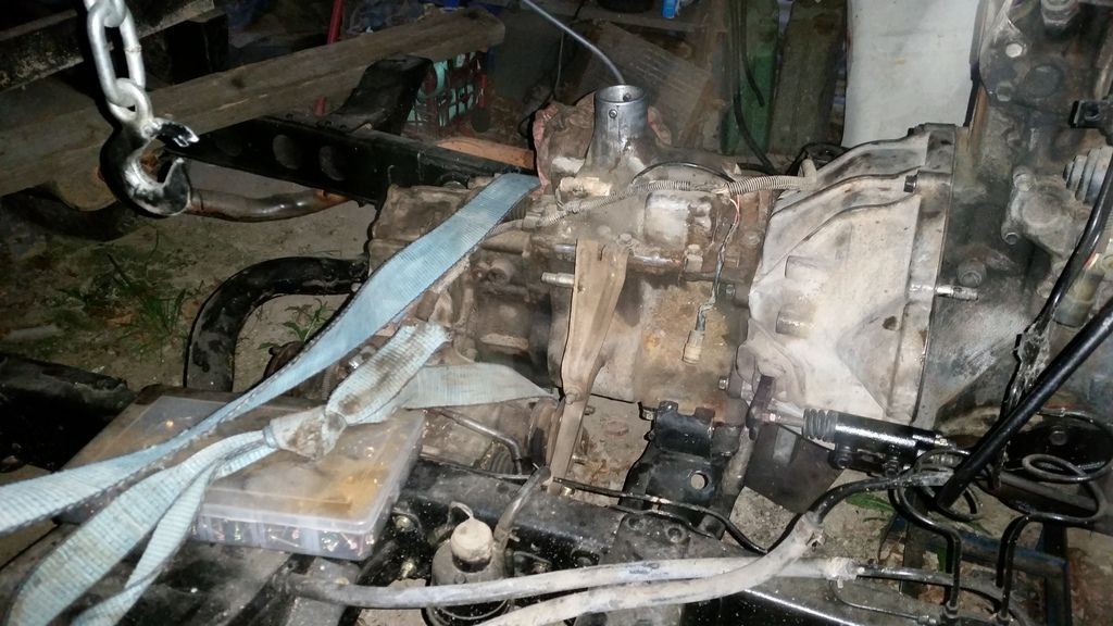

OK, so I had the old man up for a couple of days, and I suckered him into helping me align the Transmission and transfer case to the bellhousing. It was a pretty easy job considering, but Im glad I had a second set of hands.
I have to work out my PS pump and mount, before I can go any further. That might be interesting.

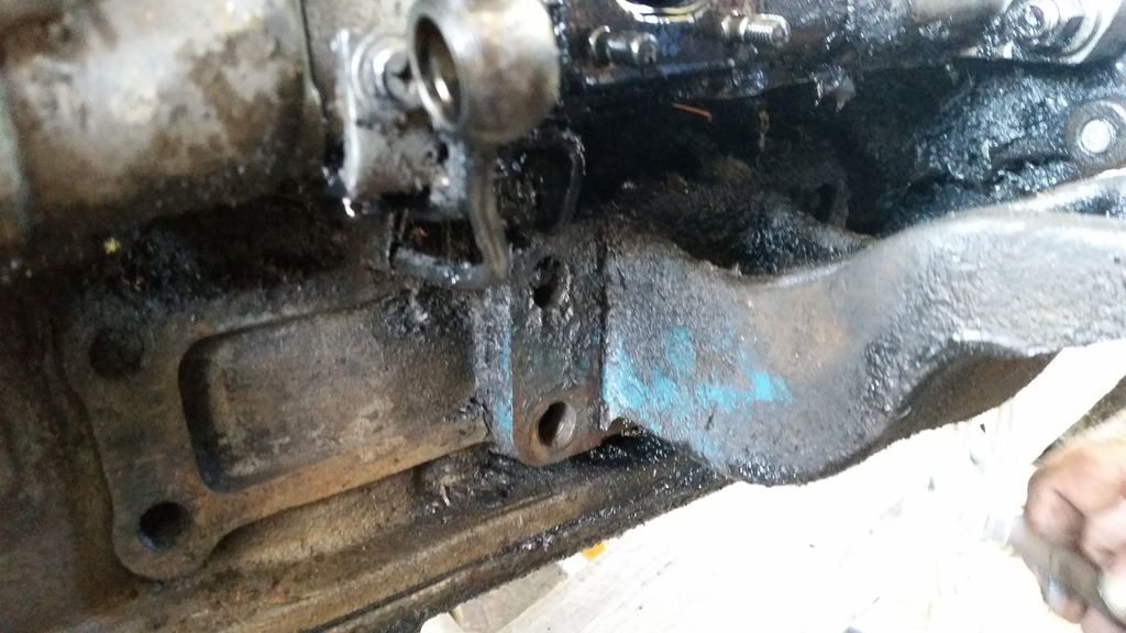

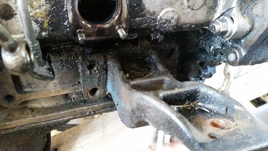

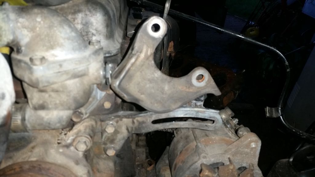

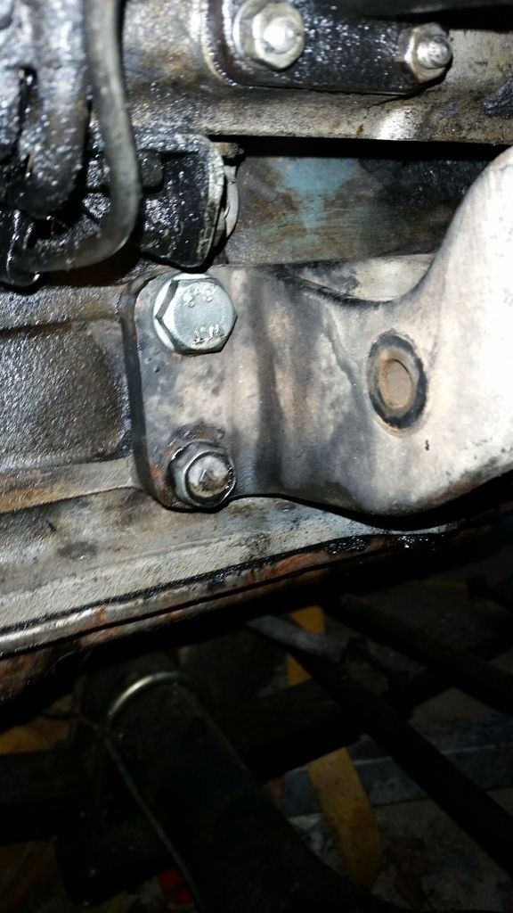

So here is the RHS engine mount before, Note the total lack of 1 bolt and that 2 of the others are totally snapped.
These needed replacing and I needed to change the mount so I could set up the Power steering pump.
So after setting myself up with easy outs, a drill, bits, and stud pullers ect I picked the old mount out and started to work.
I have never been happier in my life when they just wound out at finger tight. Both of them straight out and new ones in.

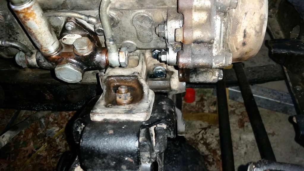

And heres the new mount.

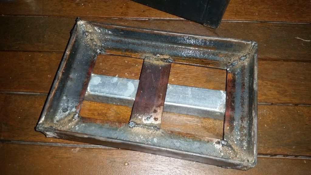

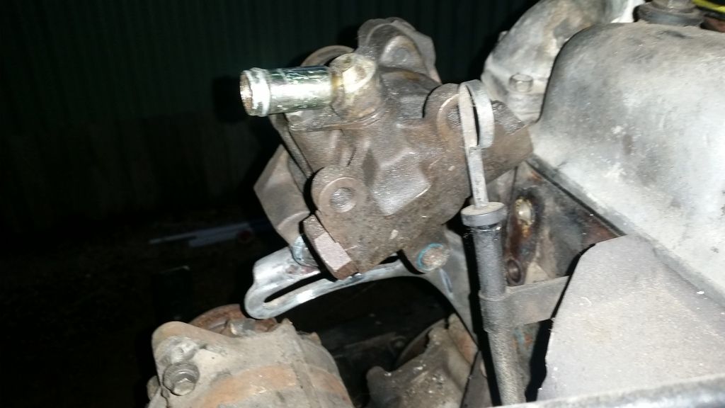

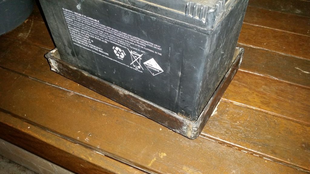

I welded a new battery tray. (the welds are terrible)
But the battery fits, and I have worked out how Im going to mount it to the chassis. not quite in the factory position but a little lower and underneath the brake booster. this leaves me some room in front of the battery and gives me some future options.

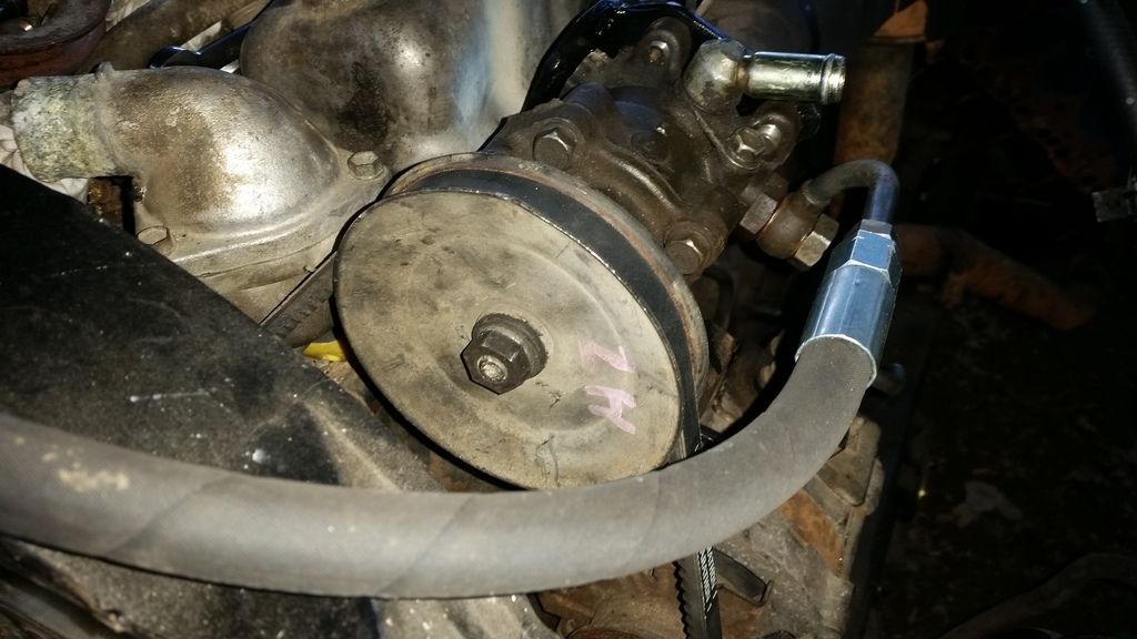

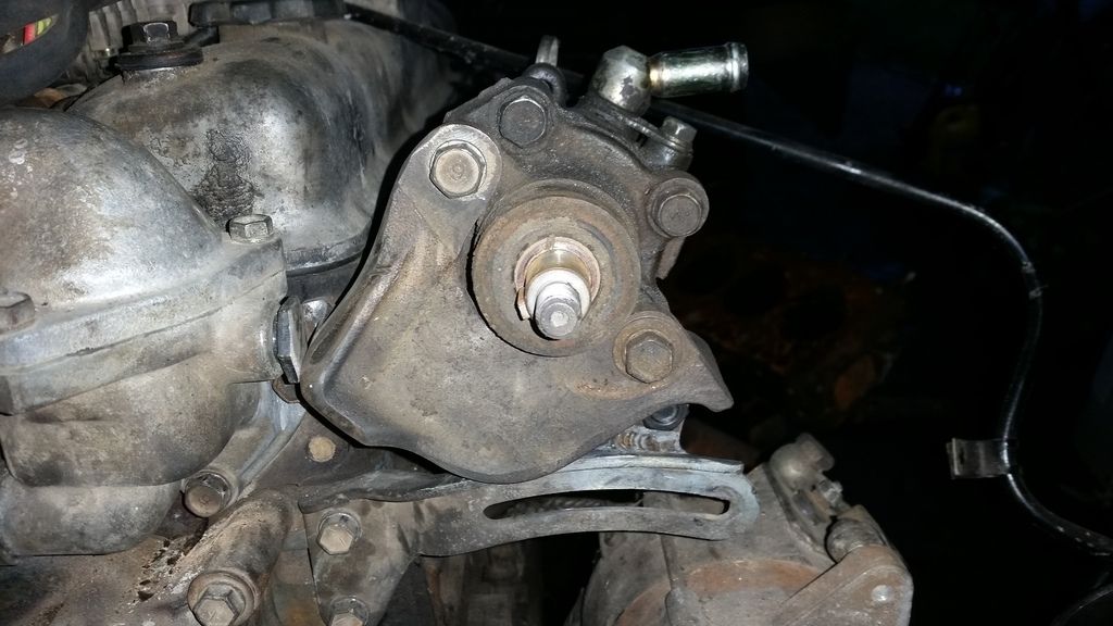

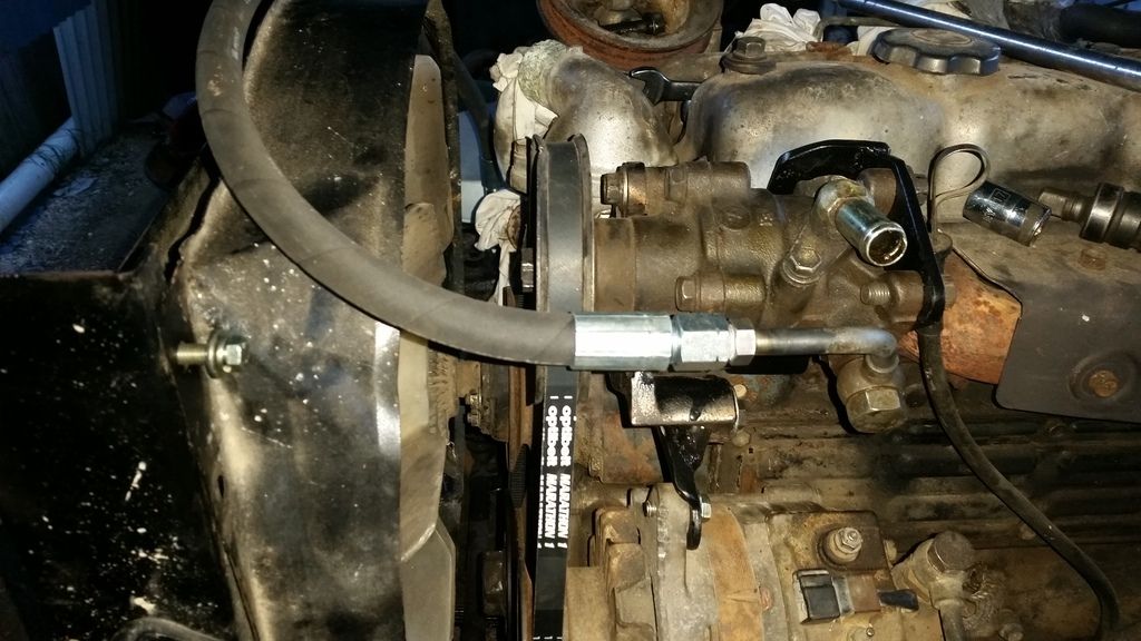

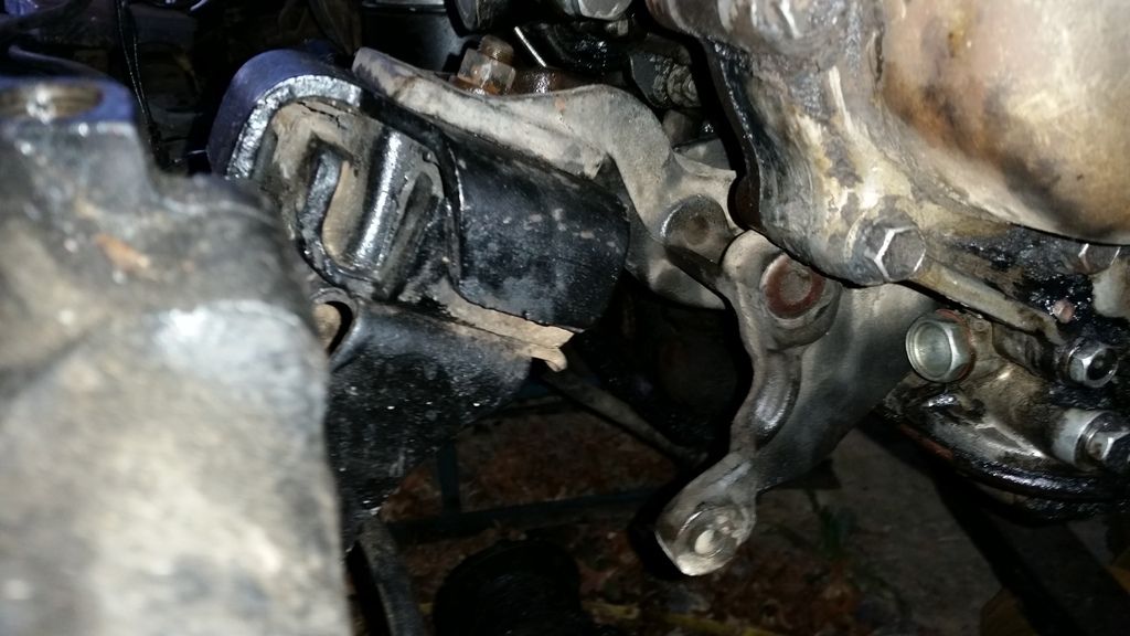

A new position for the PS pump
I still need to make a bracket to hold the rear of the pump to the block.
The pully lines up nicely and the mount is nice and strong. but I did have to remove the temp sensor from the thermostat housing and make a sump lug to fill the hole. I am going to put a more accurate temp sensor in the water pipes somewhere.

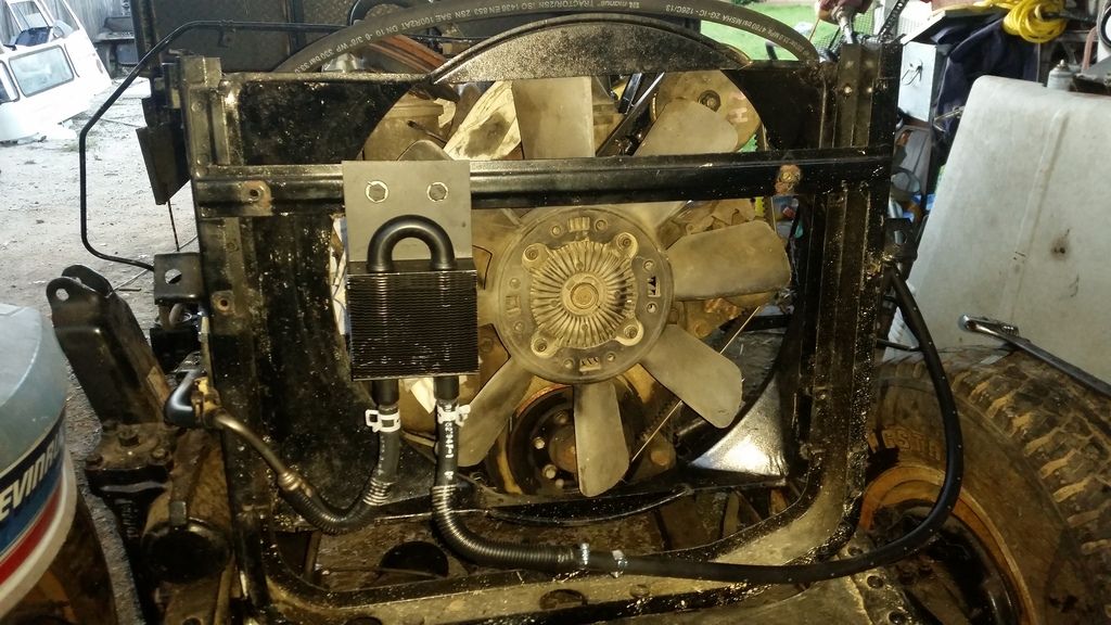

I finished the PS pump mount (which is way more complicated then it needed to be, but I made it out of scrap metel so Im not complaining.

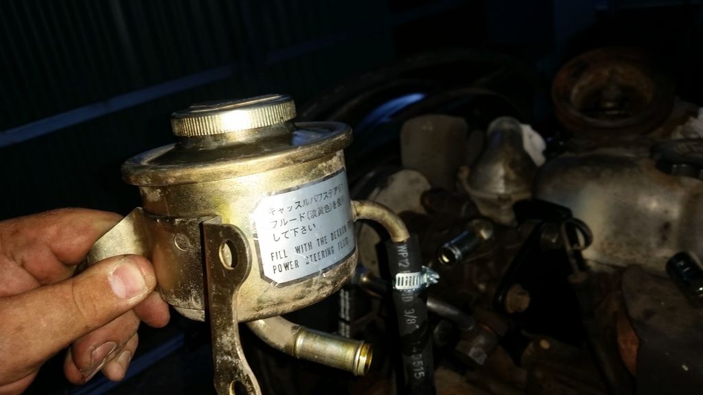

I have the radiator surround in and the PS lines all done. (The soft lines are way to long because I dont know where the res will end up) The cooler is of a ford something, but it looks like it should work

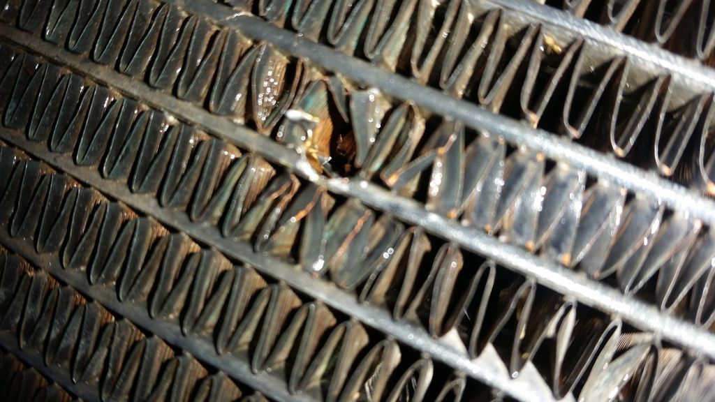

Slowing me down, some F-wit (yes me) drilled straight into the radiator. So this has to go to the radiator shop tomorrow then the entire front end can be setup.

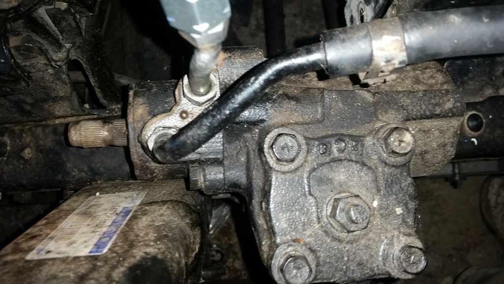

PS does anyone know If I got this arround the right way. (60 series box high pressure line @ top of image). Or do I ahve the lines backwards?
