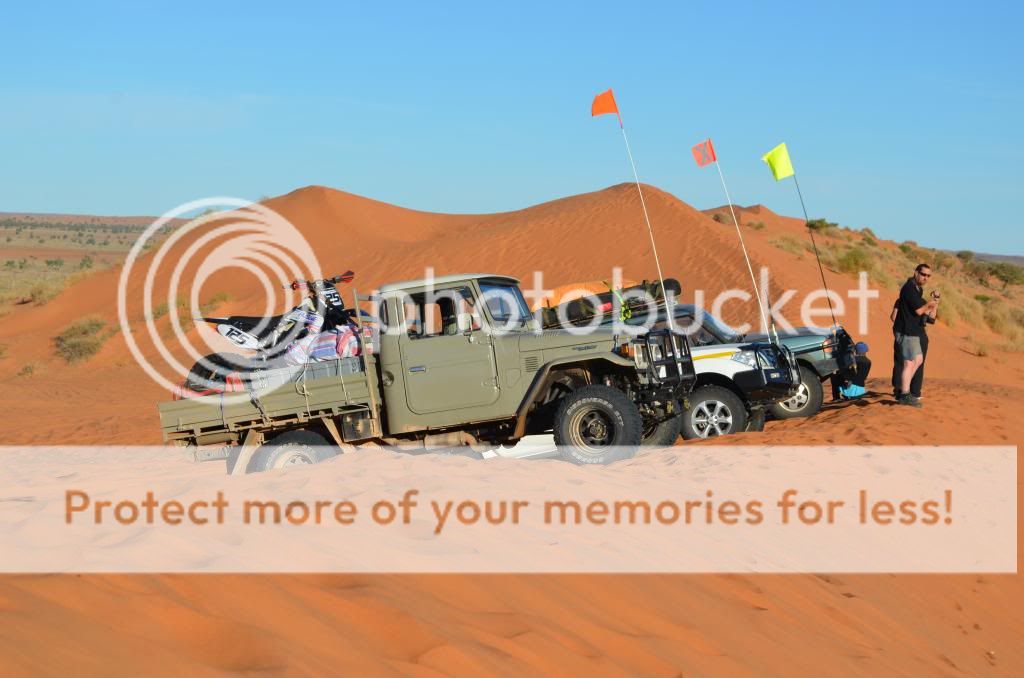

Well guys i am sorry for the late post on my Simpson trip but i have been flat out lately.
The trip went well. Considering i had 1100km on the dial after a ground up rebuild it was kinda insane to tackle the red desert but we managed to get through. With a few issues!!

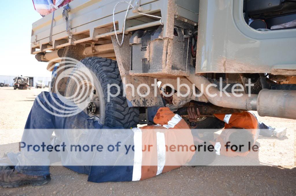

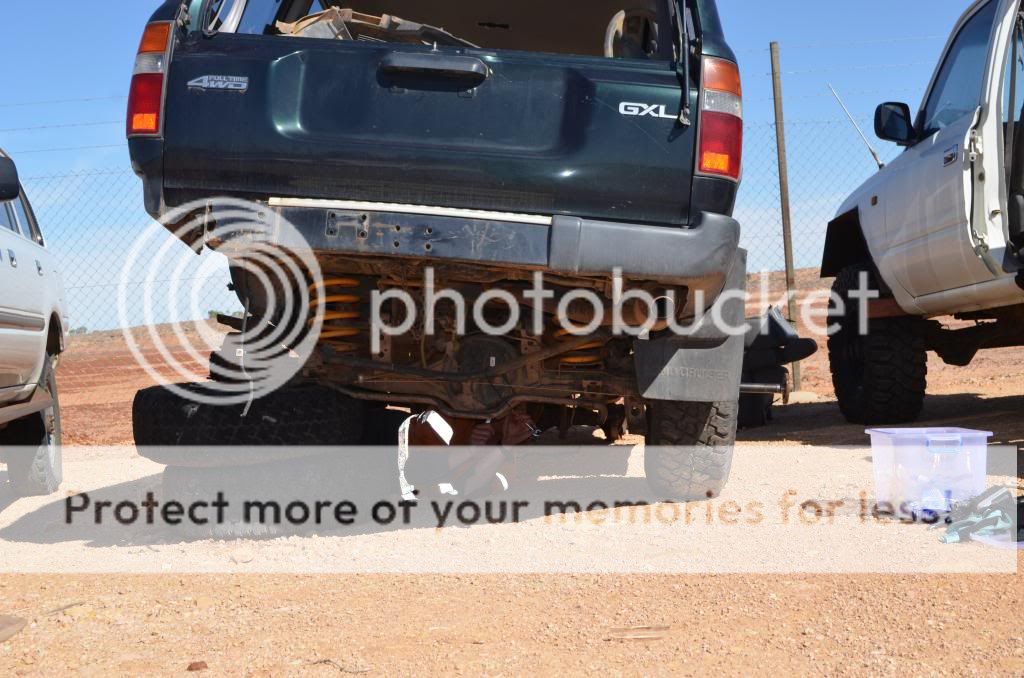

First off we left home and by time we got to Leigh Creek I noticed the rear diff was leaking. Closer inspection found the diff pinion bearing had gone and there was about 5-10mm up and down free play in it... No choice but to push on to Mungeranni for the night and see if we can find a new diff center on the way up. Speaking to the friendly publican Phil I managed to source a LSD 80 series center in Birdsville for a bargain at $1000 (fitted myself!)
A few beers and off we went again straight for big red! Needless to say up she went!!

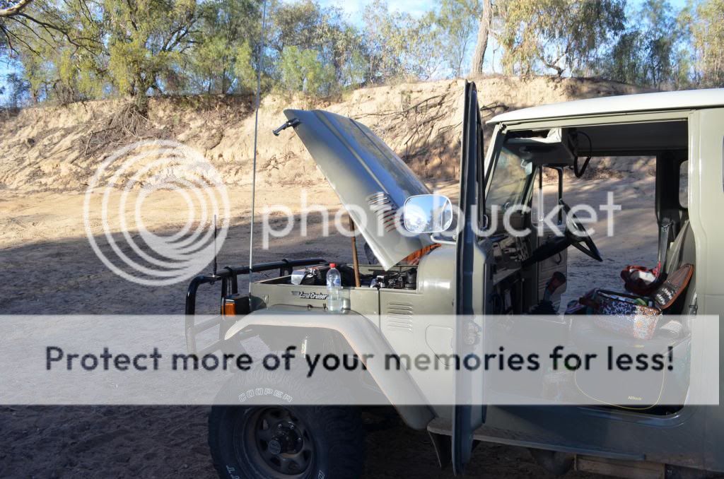

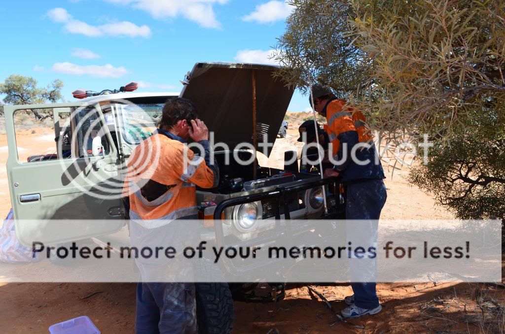

After a bit of a play we set off into the desert but..... were forced to set up camp early for the day. My electric thermo fan failed and it wasn't looking good! The coupling where the plastic fan bolts to the electric motor had sheared out of the fan itself so the fan blades weren't spinning at all. A few beers and a bit of bush engineering we had come up with a plan. We removed the fan and chocked the plastic blade assembly where we wanted it to sit using stubby caps. We then used Knead-It and Araldite to bond the coupling and the fan blades together again. The bod had set by morning after sitting near the fire so we bolted it all back up and off we set.
It wasn't long and the car looked like this again! Bonnet up!
