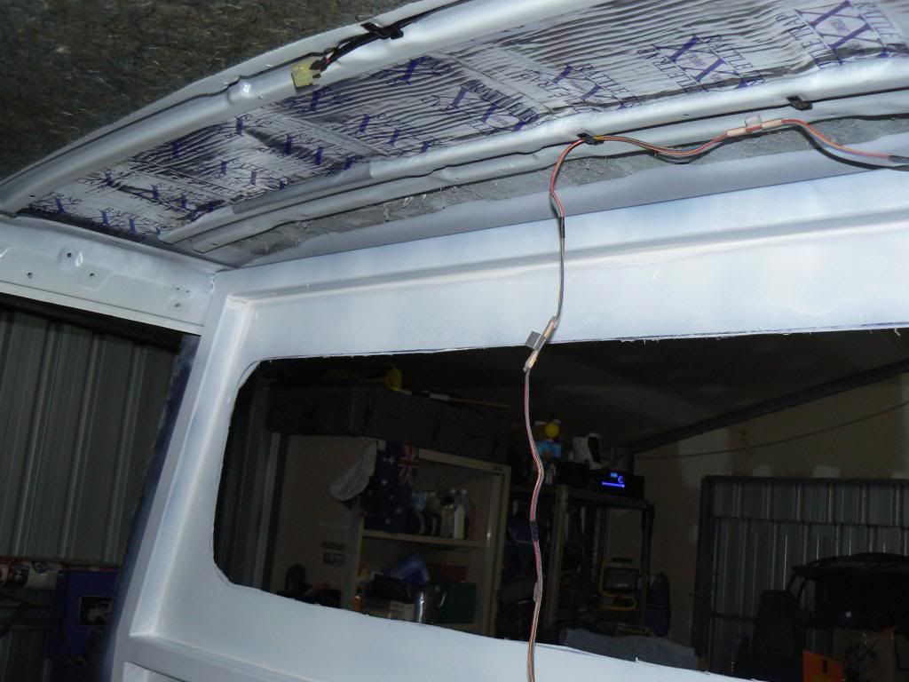

Horrible gap in front of the rear doors. Welded a plate in there, worked out ok. Going to seal in behind with expanding foam, i can't think of another way and there is a big gap where the old door seal used to run. i don't want water etc in there as there will be no way for it to get out.

Unread post by patroler » June 10th, 2014, 12:26 pm
From the rear.
Plate where rear window used to live
