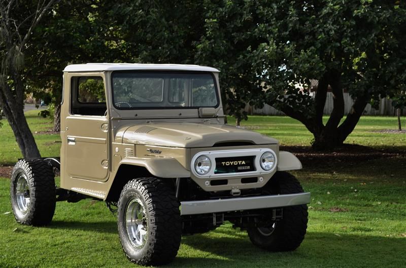

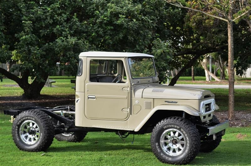

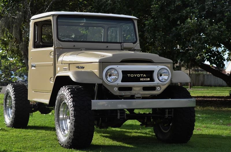

Cheers guys. I got some better video of it today and will get it uploaded tomorrow. For not here is some pics with all the front panels fitted up. Pretty stoked with how its looking.

Rogers Cruiser
Posts: 1327
Re: Twistys 1977 HJ45 Ute
Unread post by Rogers Cruiser » May 3rd, 2015, 10:51 pm
looks like crap mate, you should swap it for my half done build and do it better this time :).
Any problems putting all the panels back together?

Rogers Cruiser wrote:looks like crap mate, you should swap it for my half done build and do it better this time :).
LOL....I'm really starting to look forward to having a break from working on trucks hey. So thanks for the offer, but I'll pass for now. :D
I still need to line them up a bit better, but other than that, no dramas at all.

Unread post by Gojeep » May 4th, 2015, 11:11 am
Love the clean uncluttered look. :)

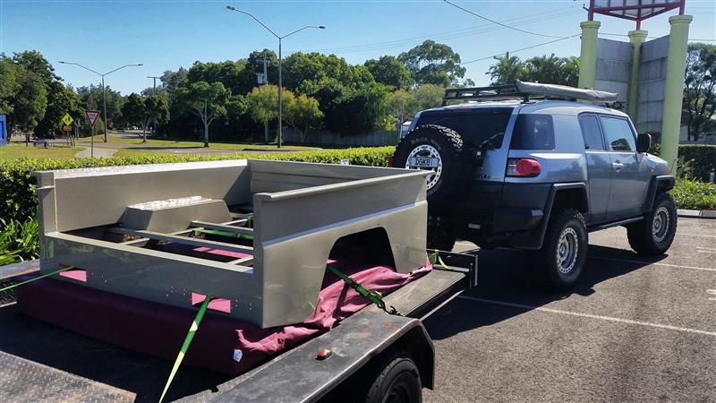

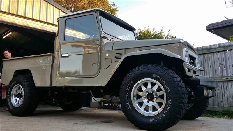

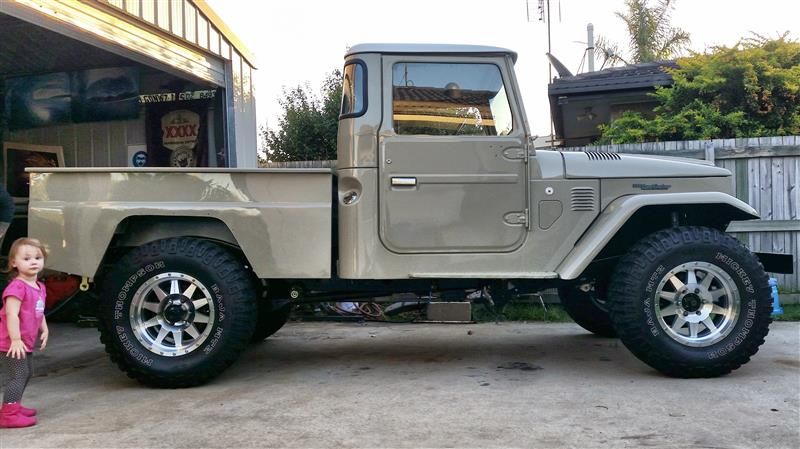

Unread post by Twisty » May 10th, 2015, 7:29 am
Cheers guys. And Big Dutch, GoJeeps build is a whole other class of skills compared to me, but thanks for the comments.
I pIcked up the styleside from the painters yesterday, really happy with it. It just needs the flares on to look the part. Also need to spend some time getting everything lined up properly too.

Unread post by Gojeep » May 10th, 2015, 6:28 pm
I like how the bed matches the bottom of the cab and lines up with the joint in the cab at the top. Don't think the original ever did as think it was first designed for something else? This is the way Toyota should have done it in the first place. :)
