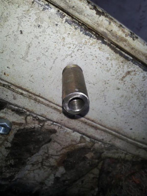

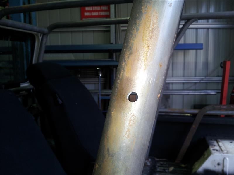

Bit more cage progress. Just needs welding out now for the Engineer to approve on Friday.

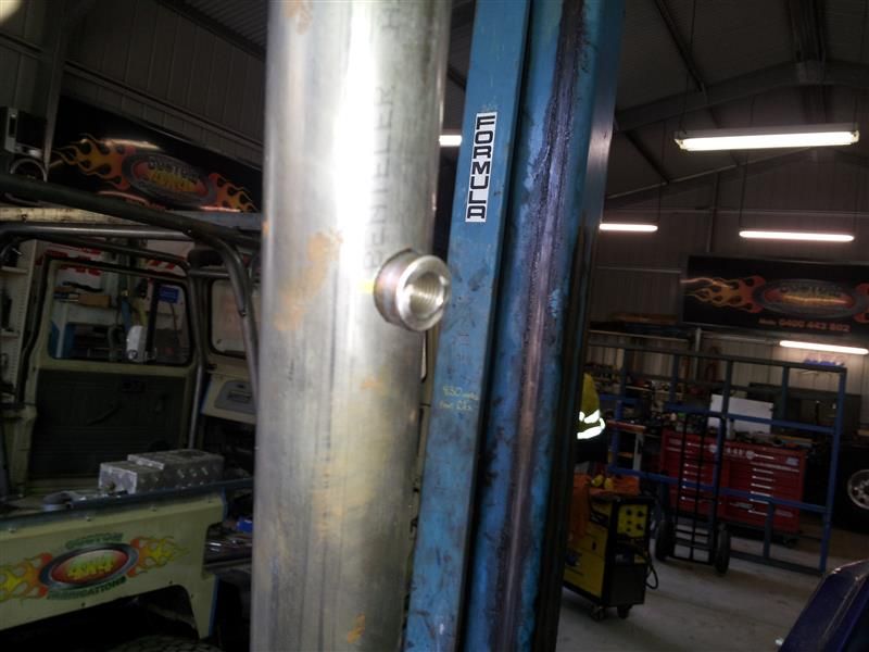

Seatbelt mount slugs. High tensile bolt cut down, drilled out, then tapped to suit. There are two of these per side (top/bottom)
8mm hole on the outside to plug weld to slug.
19mm hole on the inside.

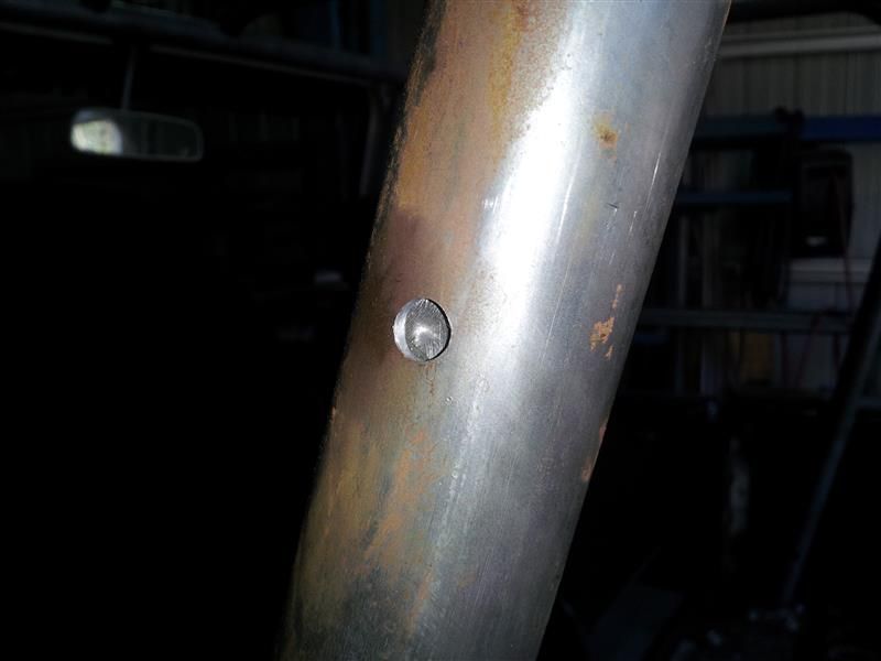

Slug inserted (not yet welded in)

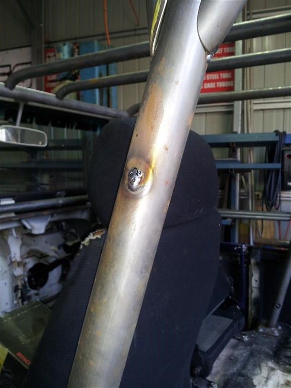

Area to be plug welded
Done

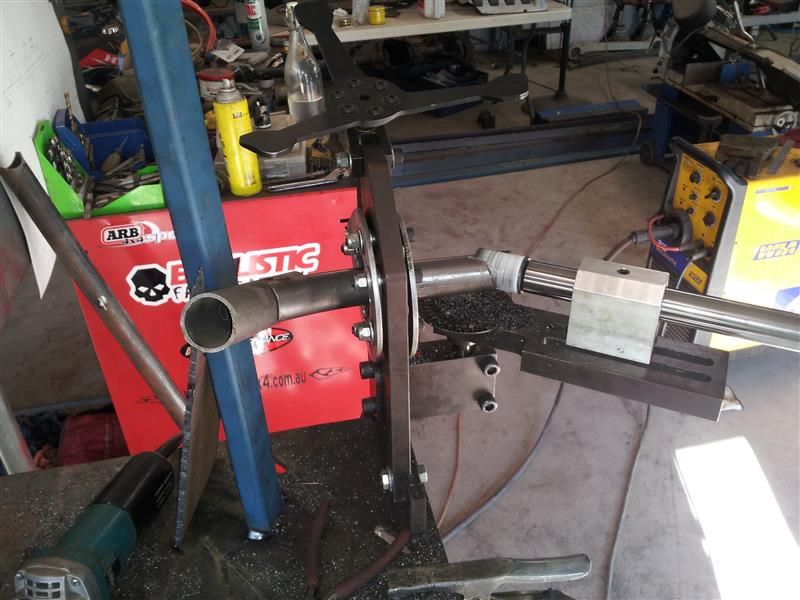

Some more tricky notching by brooksy. He cut the first notch by hand, then set up the baileigh notcher (thanks Criddy!) to suit. He then welded a temp jig to the table to make 3 more the same. Worked perfectly! Next was to mirror image the setup and do 4 more.

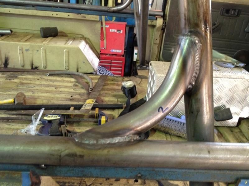

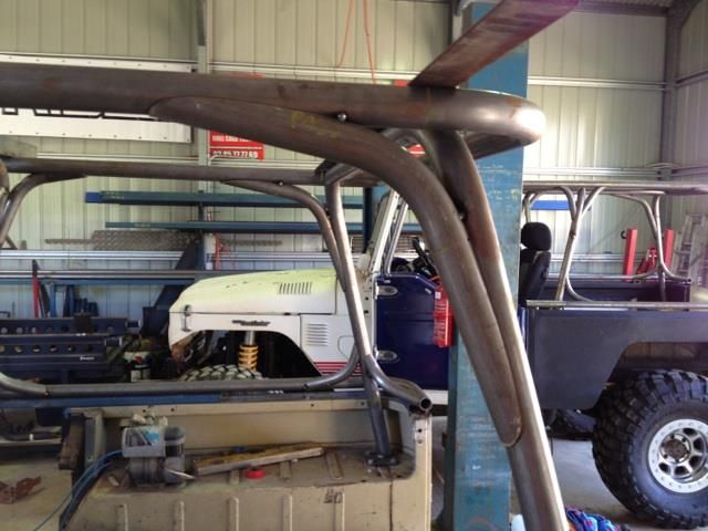

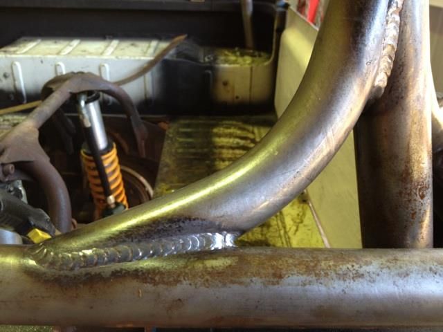

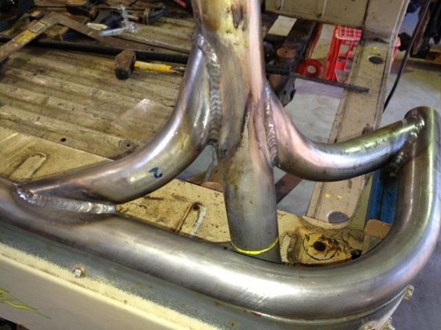

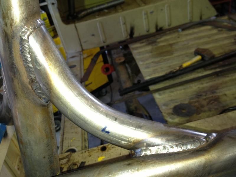

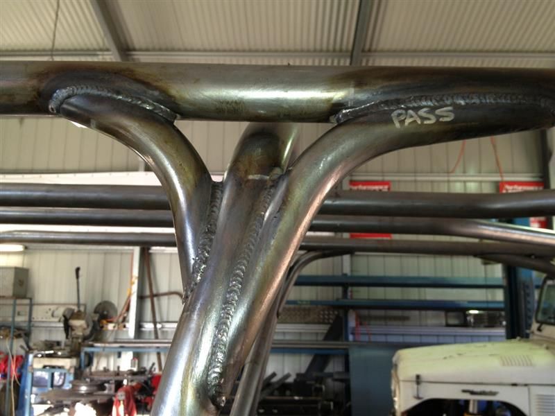

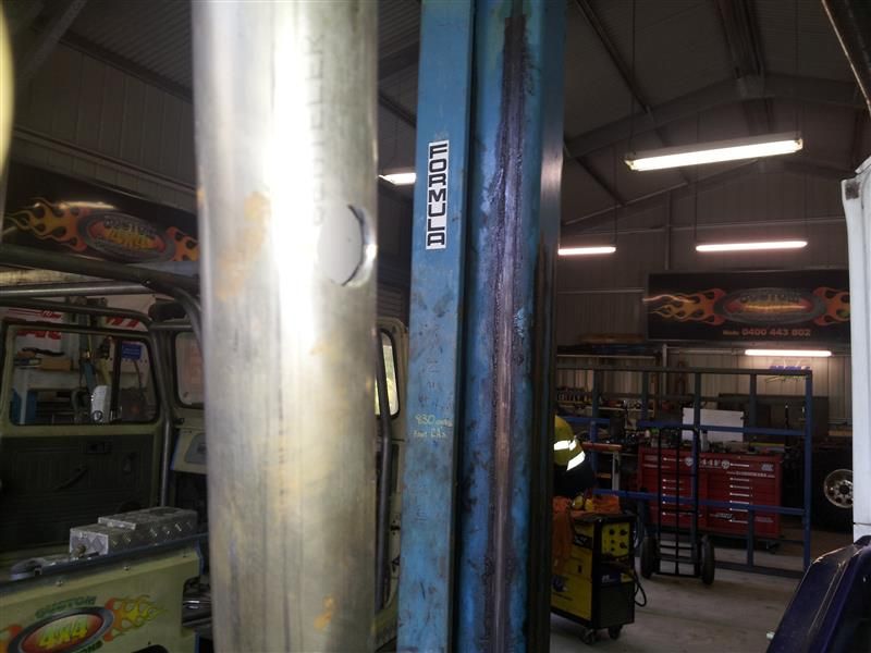

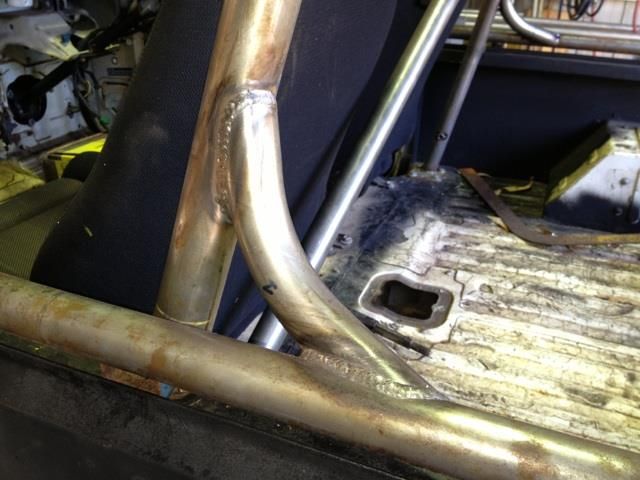

Unread post by Twisty » April 24th, 2013, 5:56 pm
Few more pics now Brooksy has done most of the welding. (Some pics are of Brooksys 40 which has basically the same cage)
