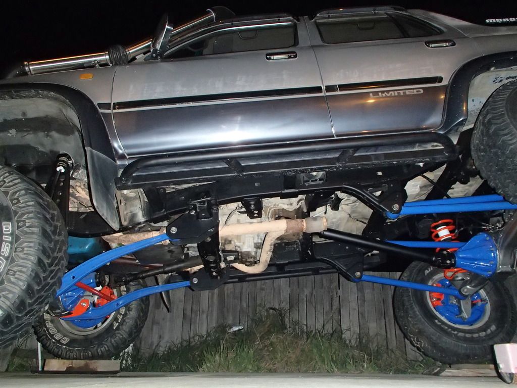

OK so i got around to chopping the othe chassis link bracket & modified it a tad so now both are in position...
The arms are basically in factory geometry they are approx 10mm higher set at the link bracket then they were before so im going with them as they sit..
the driver side i have already cleaned up the chassis rail & pretty much ready to do a few stitches ready for test run once uppers are finnito
there's a bit of a camels hump there as the link brackets are set so low to keep arms at good angle so i get antisquat figures somewhere near 100% dont wanna be doing wheelies or fitting limiting straps so trying to stick with the figured the 4-link calculator suggests works for all my truck specs... Also the humpi plan to fill in with a brace i cut that will extend forward to just before middle slider bracket that will allow it to nicely slide over stuff rather then get caught up on that hump my hump my hump my hump... check it out!
so once i clean up the passenger side chassis rail i'l set measure dopuble measure then likely tripple measure them zap down a few small beads to handle a test drive before i weld them right off cause it's a major butt pain to cut them off if i find the figures weren't working & had to reposition so just a few short stitch welds then onto uppers... whats peoples thoughts on this one should i triangulate the uppers at about 40-45degrees separation or just go with the surf lowers as uppers with 80series bushes pushed in as the bush sleave & links will all be 18mm not 16mm like the surf ones are & set them straight ???? :confused:

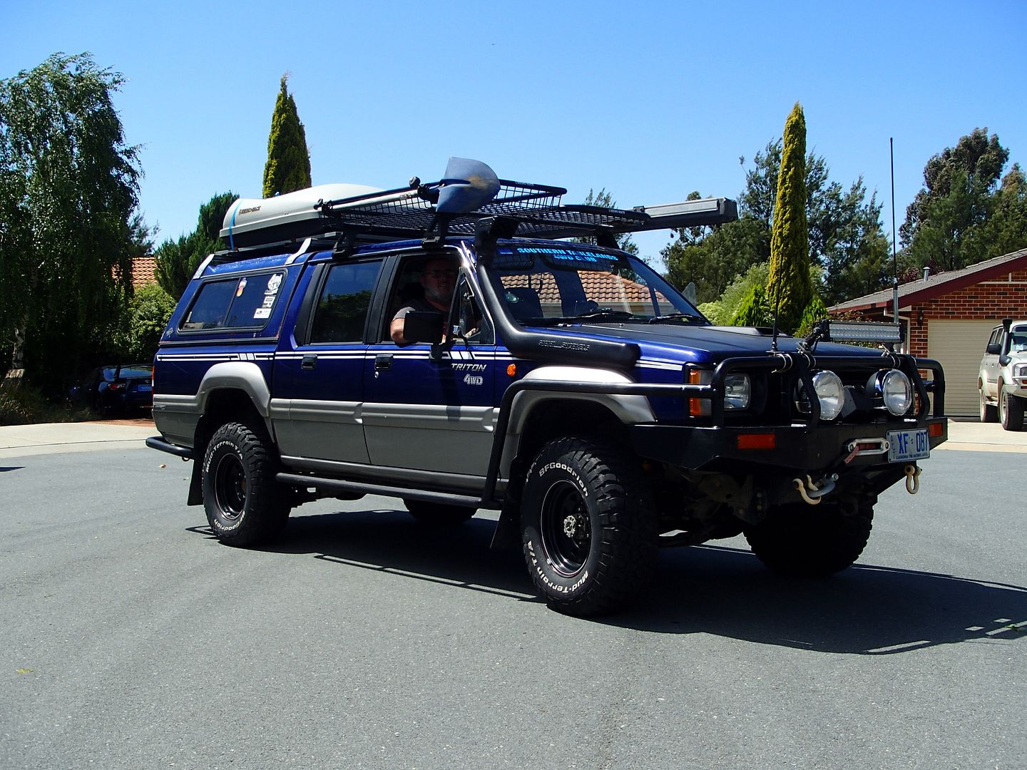

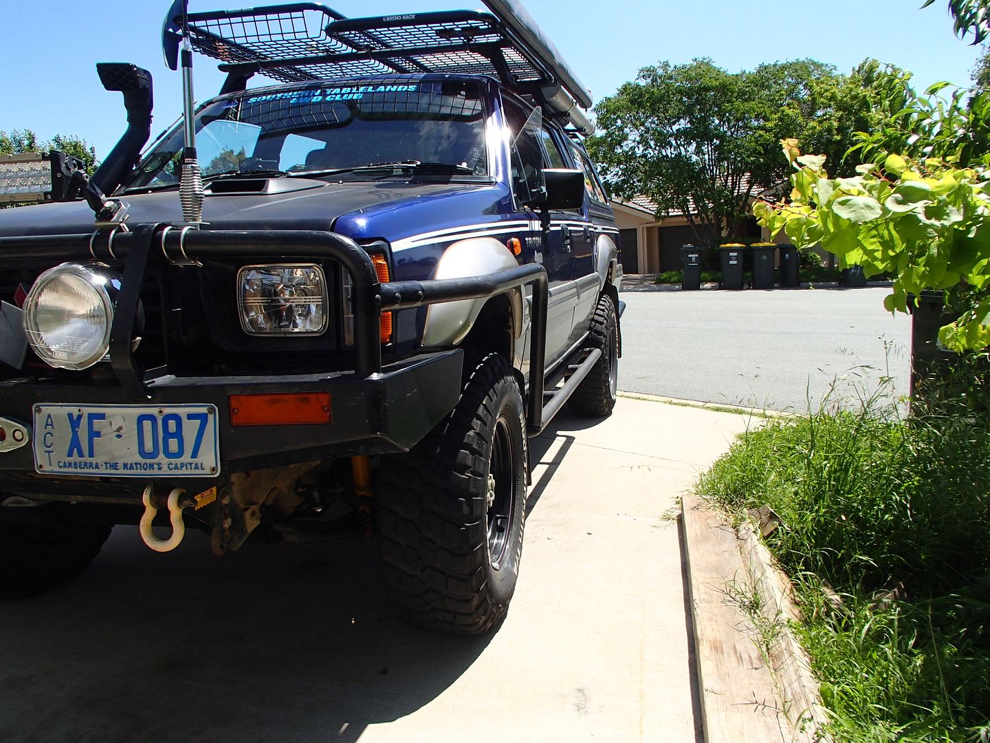

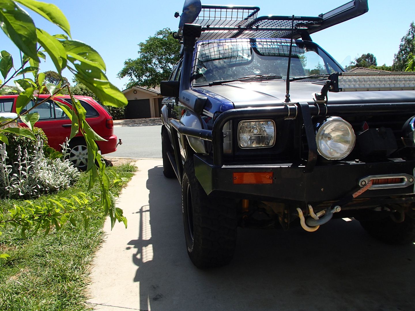

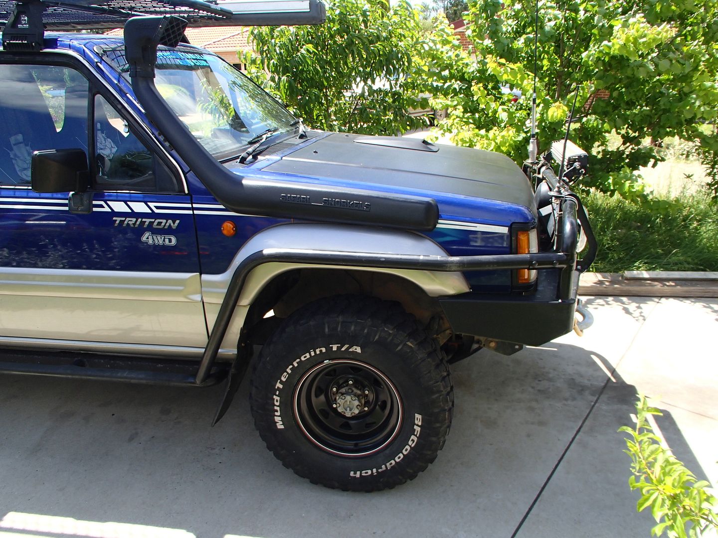

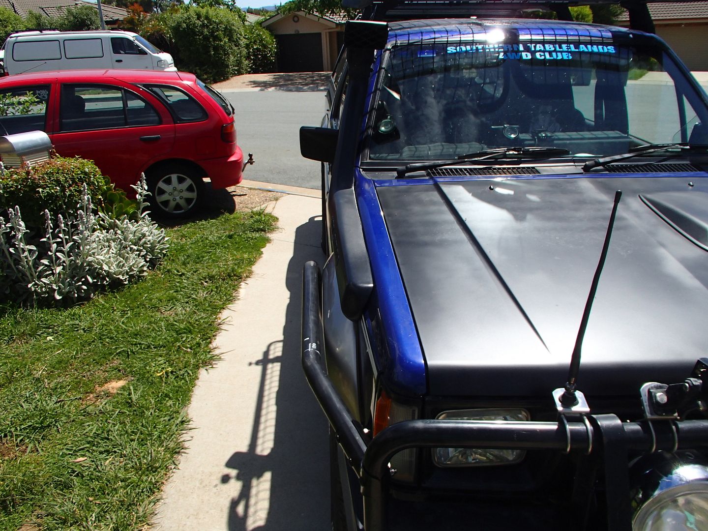

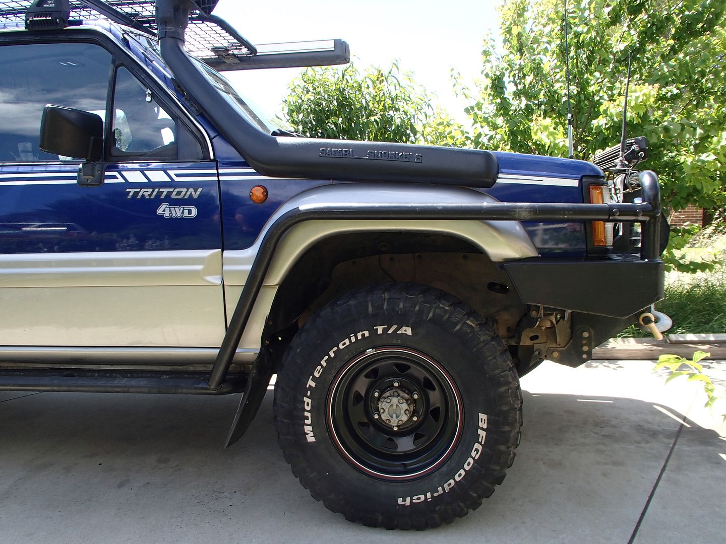

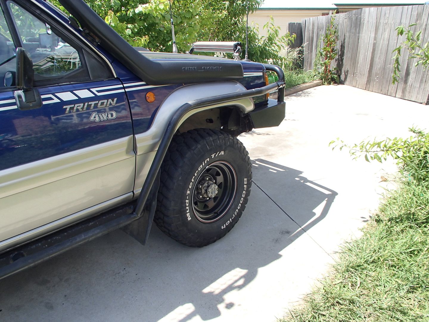

I made some (Brushies) brush rails for this Triton Yesterday in 35degrees heat out in the open PMSL! :drink:
They come up bloody good very happy with how they turned out as was the customer for his new F4x4F custom brushies!
Cant believe how sturdy they are :waycool:
Anyway some pics
Im a Holden man but dig that number plate :twisted:
Another custom creation by moire :D

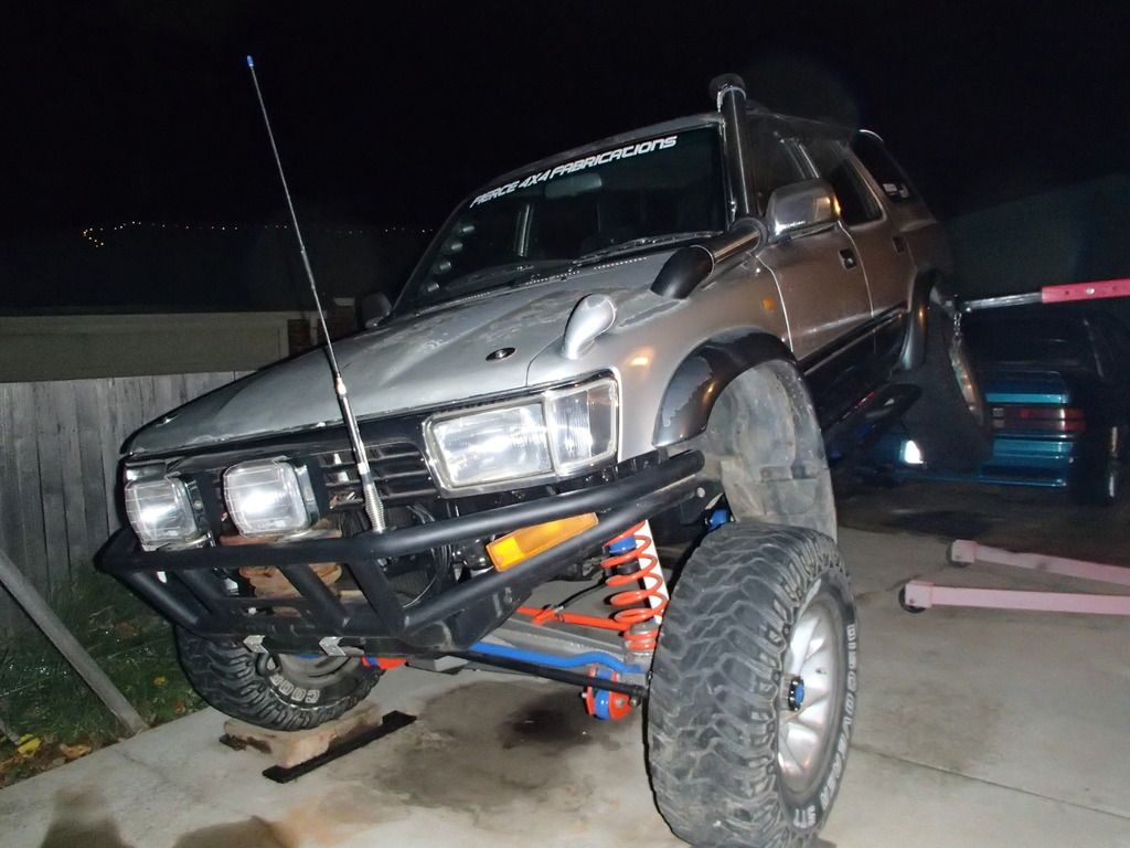

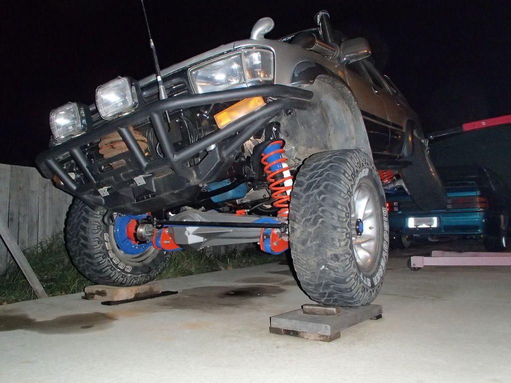

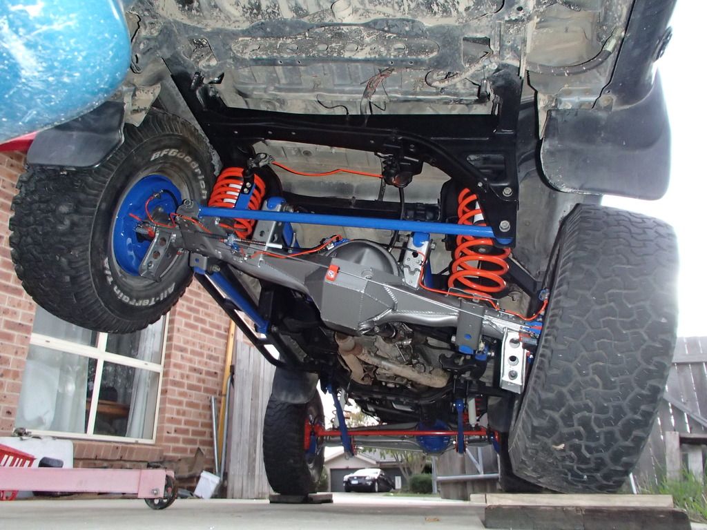

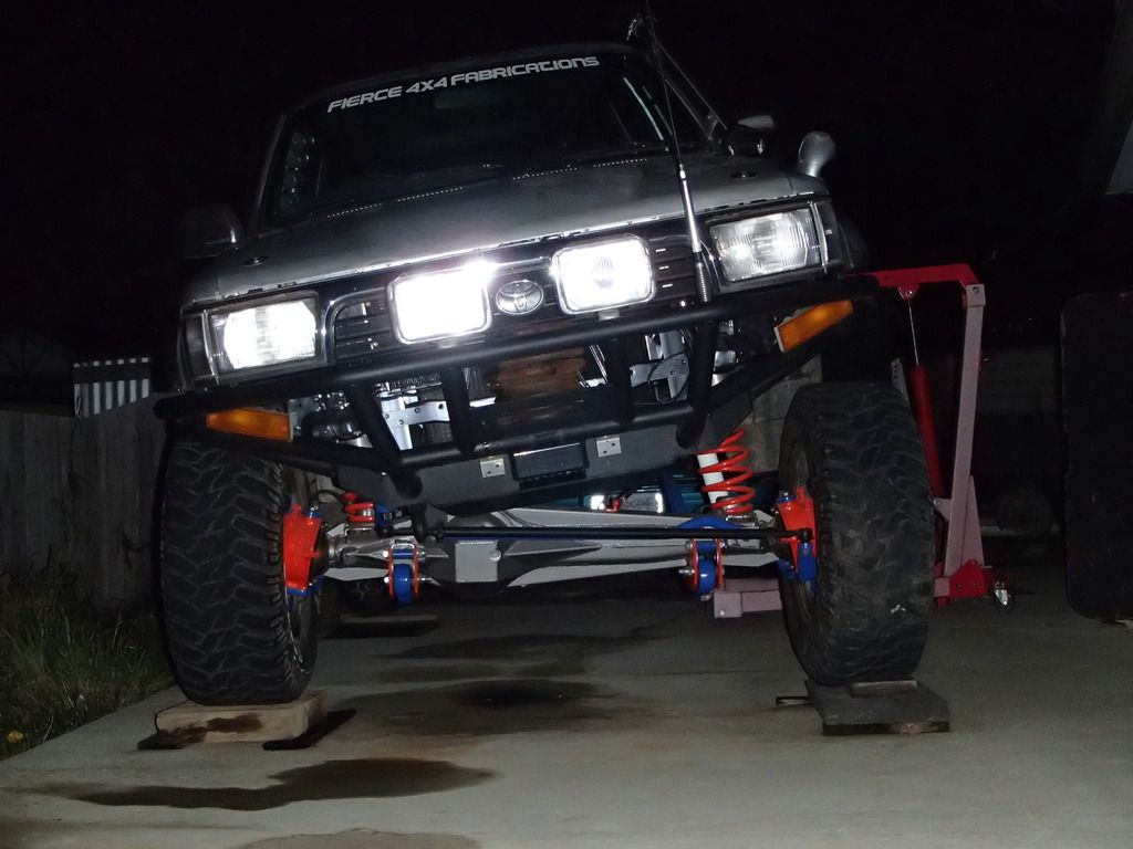

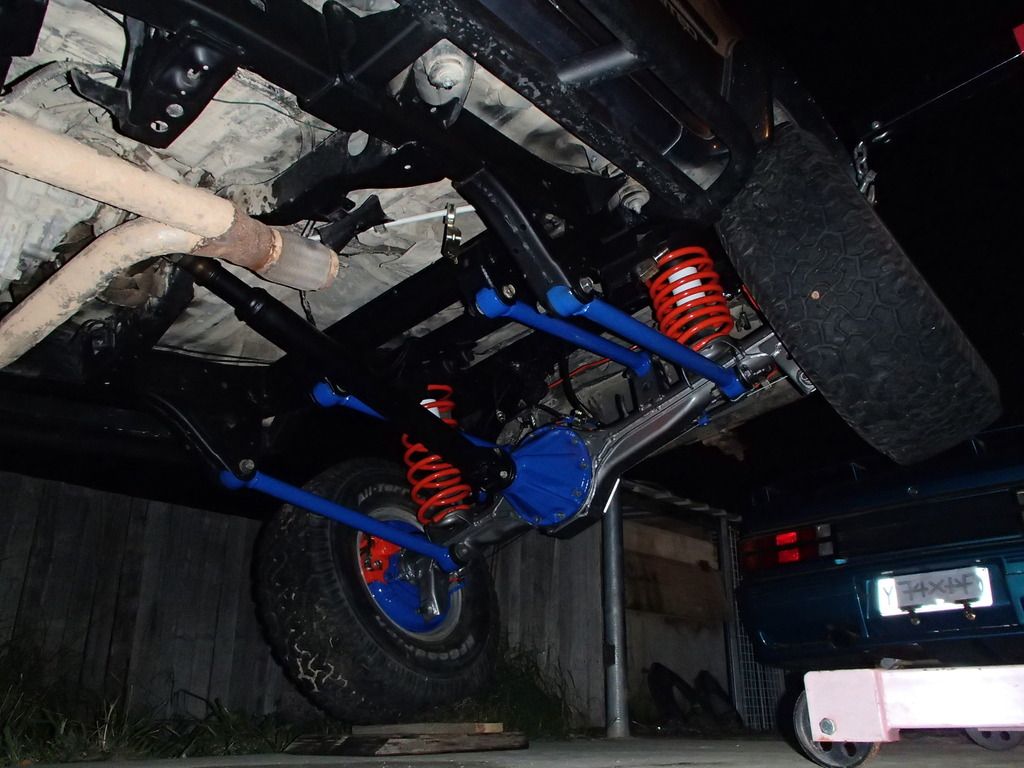

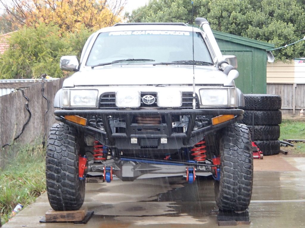

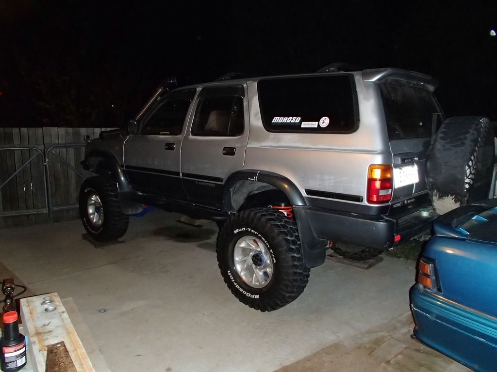

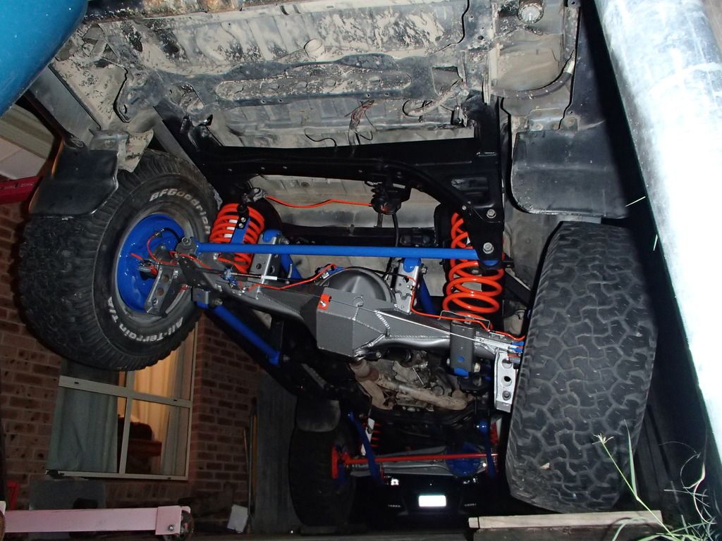

Been busy as building stuff for people but still have made good progress.
all the new rear trailing arm chassis links are tacked in place i'v cycled the diff & all is sweet so will weld off some time this week, will need 10" hilux shocks in the rear & 12"s in the front but still saving for them $1200 ouch.. At the moment i'm finishing the rear diff pumpkin armor & painting bits :lol: all the new kits for it have arrived so will be busy putting that together then install time.. since last time i was on here i managed to fix & extend the steering shaft & fire wall gromit also sorted out front brake lines too & fixed the tie rod clearance so it doesnt touch the radius arms now so cheering the SAS is officially finished & the rear 80series diff graft not far off now either. It will all be finished before new shocks arrive :waycool:
still yet to shave a corner off the high volume transmission oil pan for front shaft clearance as the driveshaft just touches when fully flexed easy fix tho, then need to either fit a 80mm spacer to front shaft or make a new one, reroute the exhaust & she's ready for some testing prior to engineers final inspection...
Happy days :)
