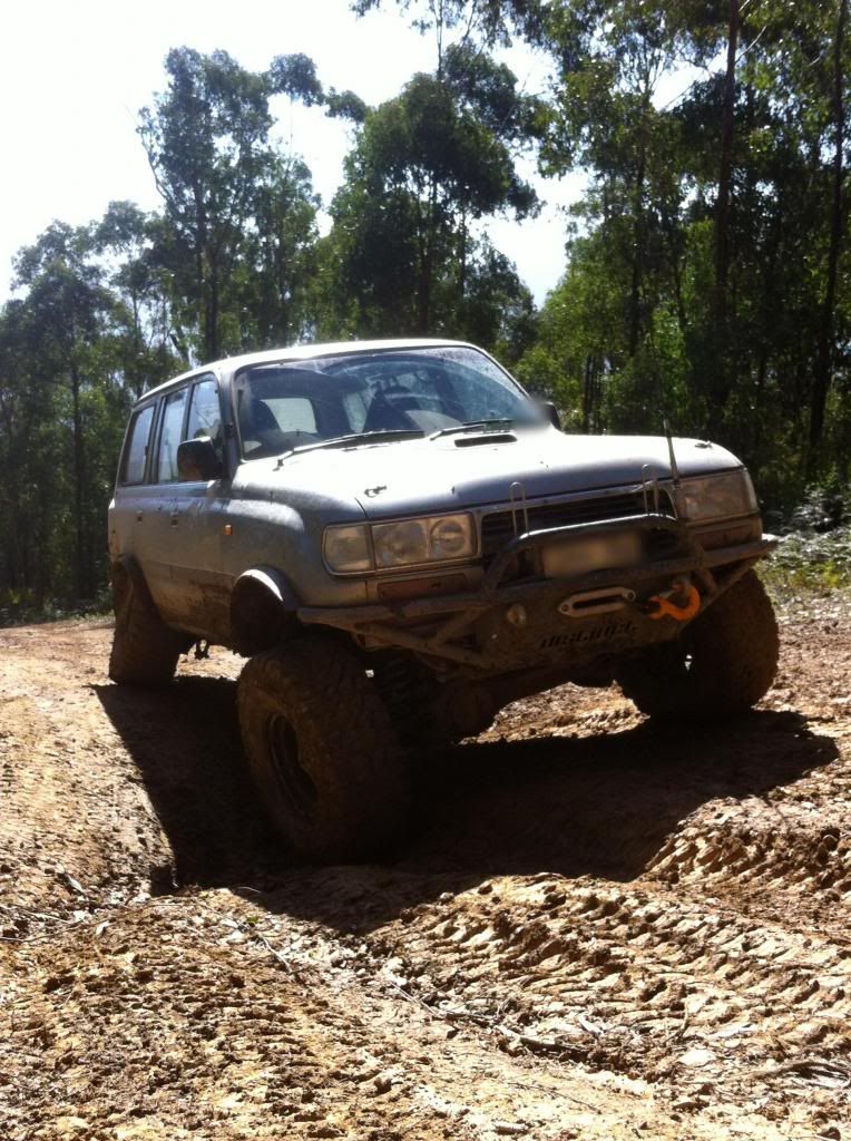

Hey, I have been lurking around for a while, posting every now and then on a few forums and I have finally decided to get involved and really get into the sport I love!!
I've had my Landcruiser for about 3 1/2 years now and mods have happened in spurts...

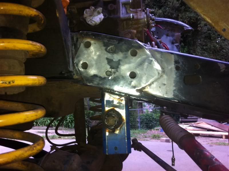

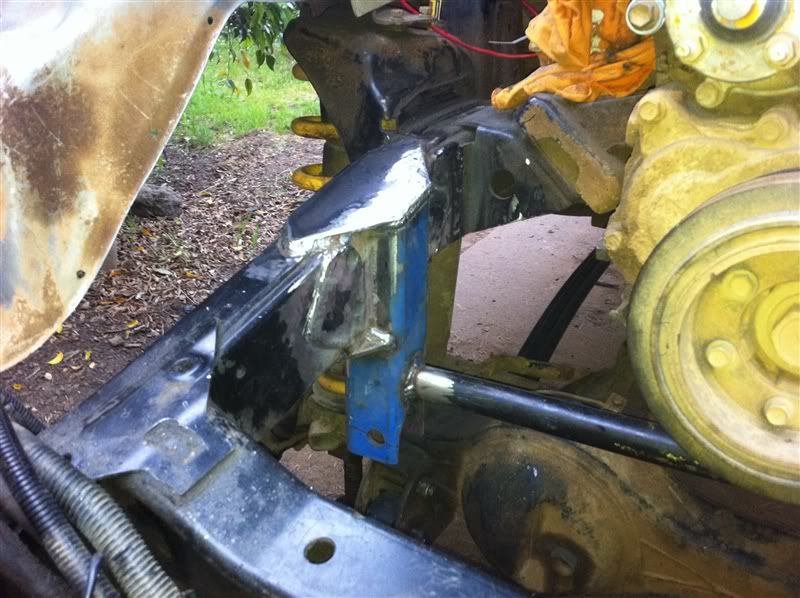

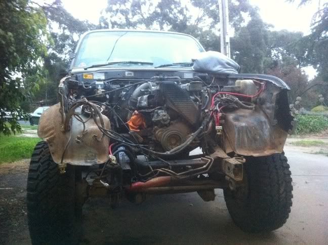

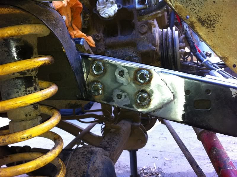

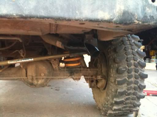

This was where sammy was until I found this, around the panhard and the steering box was pretty badly cracked! So started pulling apart the front of the car, going to do a few other bits and pieces at the same time :P

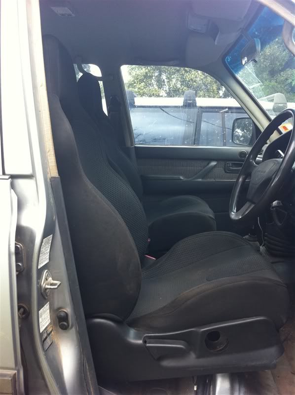

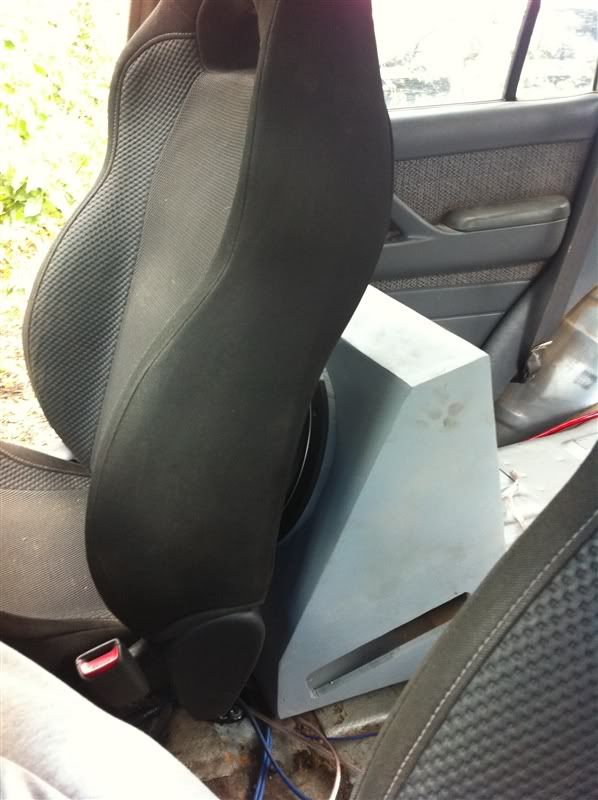

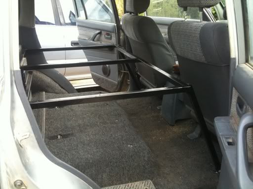

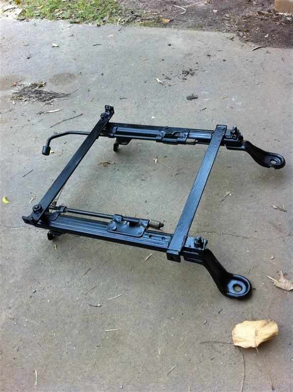

MATE!!! I would recommend NOT doing a wrx seat swap!!!!!!!!! They are 05 seats it was a massive PITA, I had to make up a sub frame for them to fit the landcruiser rails. One of my mates has put in racing seats (cant remember what brand but they werent cheapies) and he said they were basically bolt up!
I about 6'1 and 80 kilos so probs around the same build. They are amazing!!! Would be one of the first things i would do. I used to be uncomfortable for drives longer than 45 mins now i can drive for 2.5 hrs without a problem :D :D Yeah there is plenty of headroom.
Ill put some pics up of how i did the sub frame, definitely look into alternatives though!!

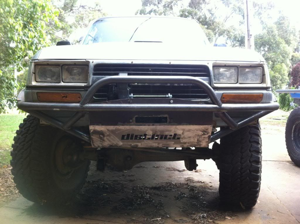

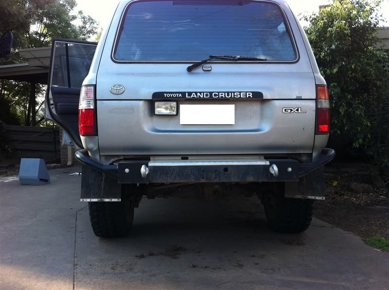

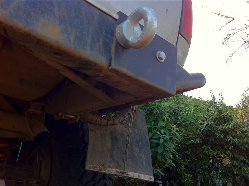

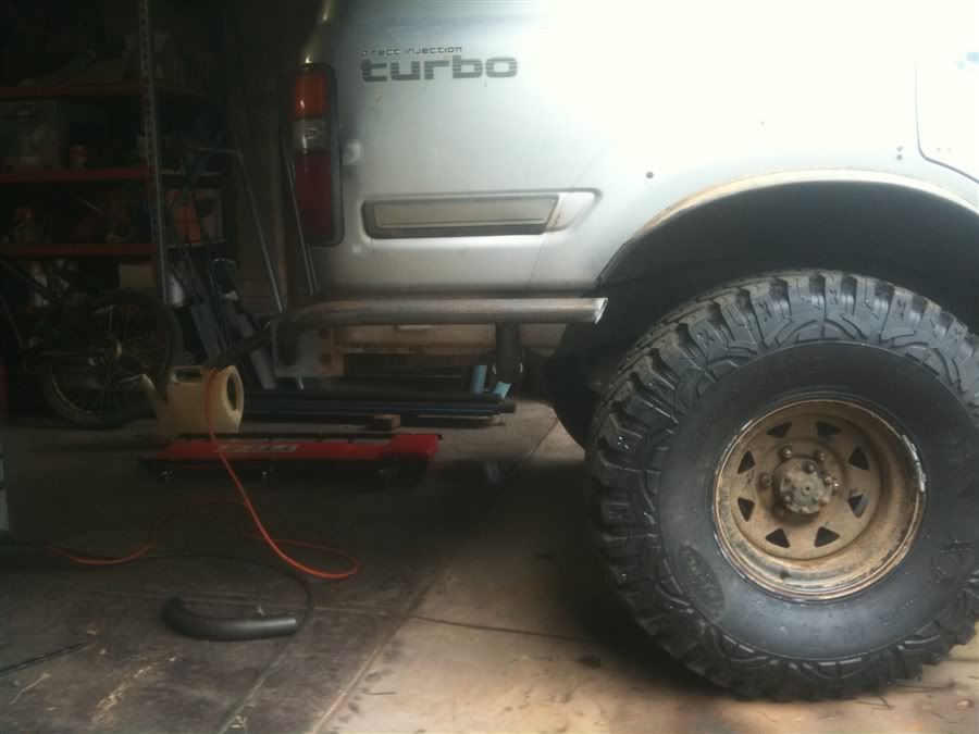

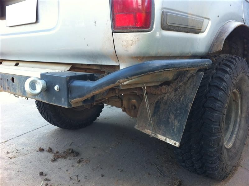

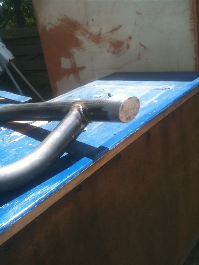

Here are some pictures of the rear bar i have built.
Just want to let you know it is not the finished product, I don't have any pictures on my computer yet :D
Very happy with it considering it was the first time I have used my jd bender :D
Oh and also have larger rated eyes than that on it now!!

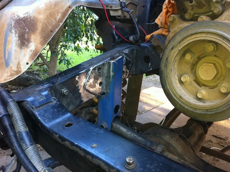

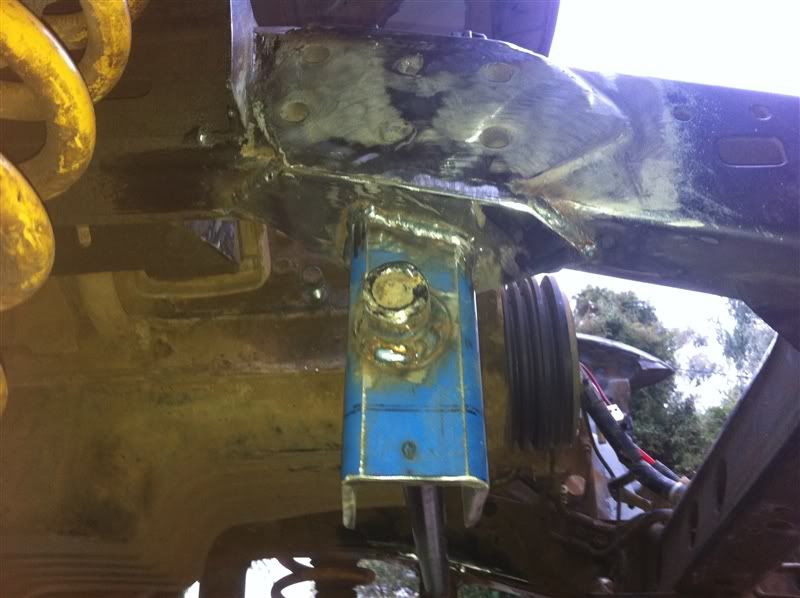

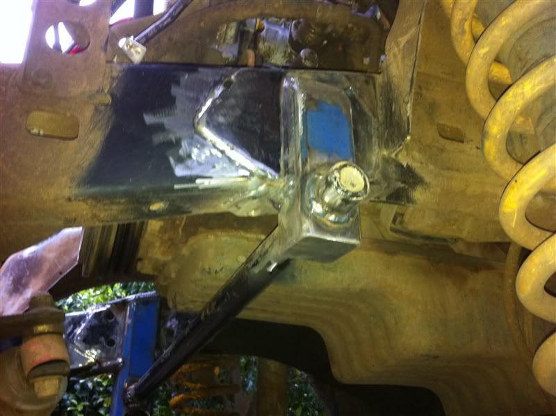

Ok I have been putting a few hours here and there into getting the cruiser ready for the long weekend and I am now at the stage of working out the length of the control arm mount and cutting the RHS for it.
So I have question what length should I make it? Standard length of the mount from the chassis to the panhard bolt is approximately 120mm. The angle of the panahard is...
Now i know that the straighter a control arm is the more flex you get, and I also know that the limitation in front flex is through the binding of the bushes on the control arm, so is it worth dropping it much further than standard to get a flatter panhard?? Something like this ...
which makes the length of the mount approx. 200mm
Help would be greatly appreciated :D
Thanks!!
Dave

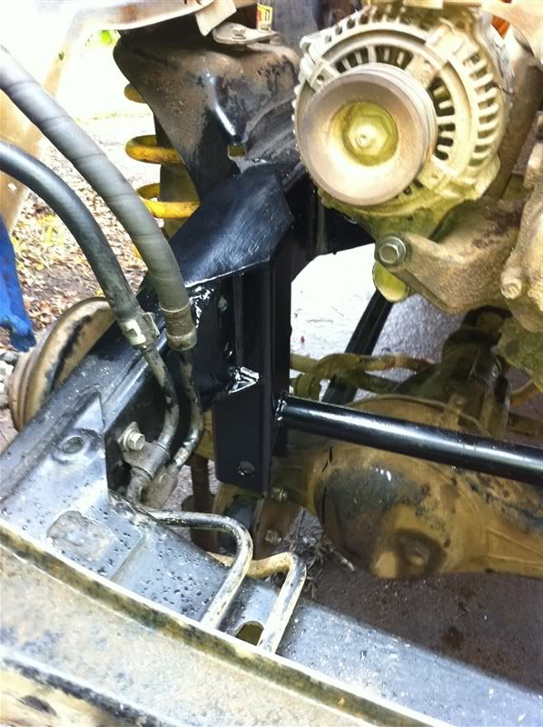

I am going to make the panhard mount so that it is parallel with where the steering arm is at the moment. I have taken all of the measurements, just need to make time to do it! Been working too much overtime lately :roll:

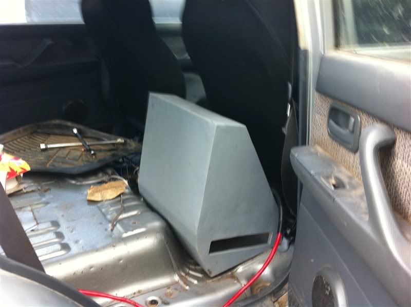

Then the plan is to do a flip arm and hi-steer and readjust the panhard mount then :D I have a fair bit to do before the long weekend so my priority now is to get it on the road!!
So in the past couple weeks.

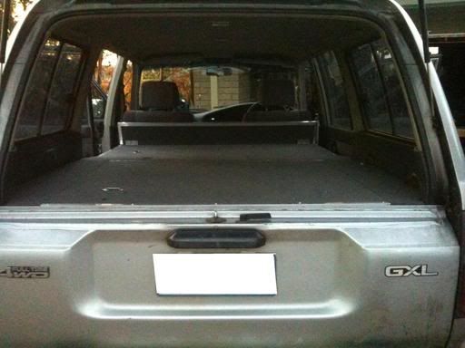

I have finally put the wrx seats in properly!!
picture of the modified landcruiser rails

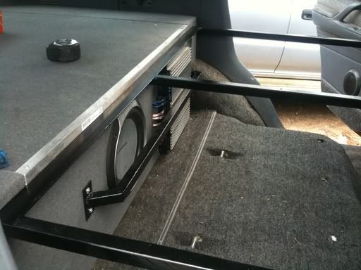

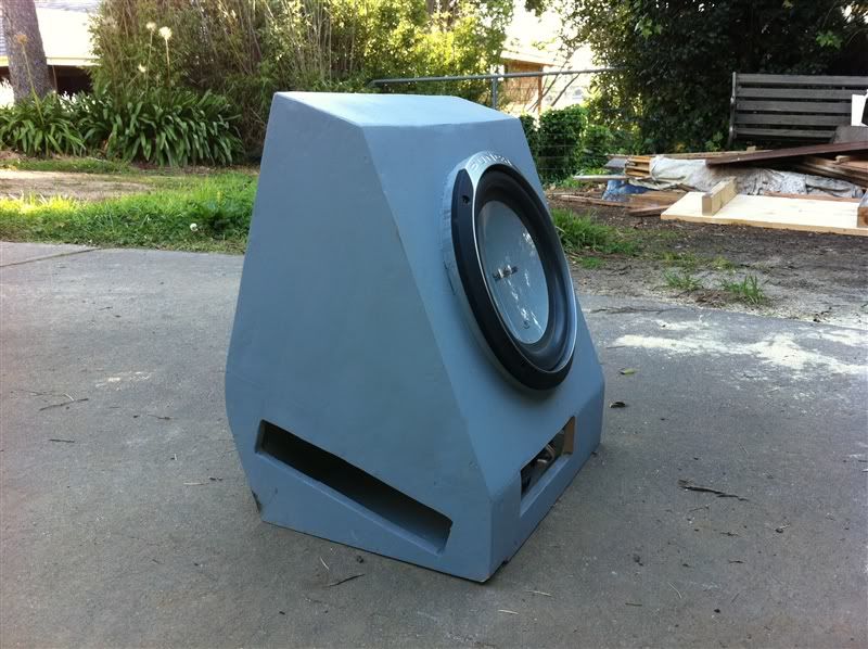

I have finished up the sub box

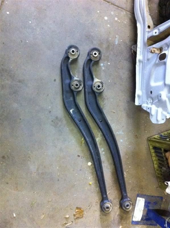

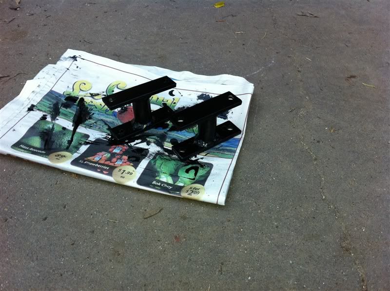

A mate gave me his old set of control arms with rubber bushes. This will help with my flex :D or lack of :P
Made up some decent sway bar spacers

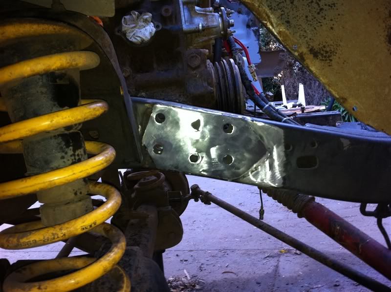

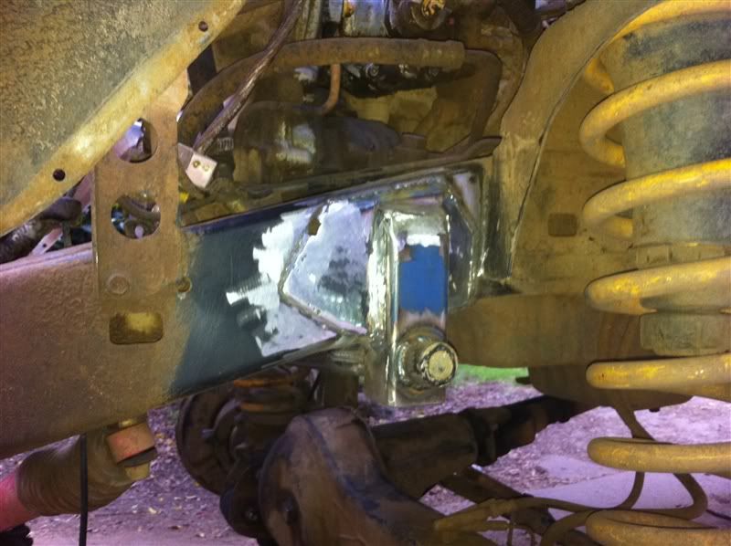

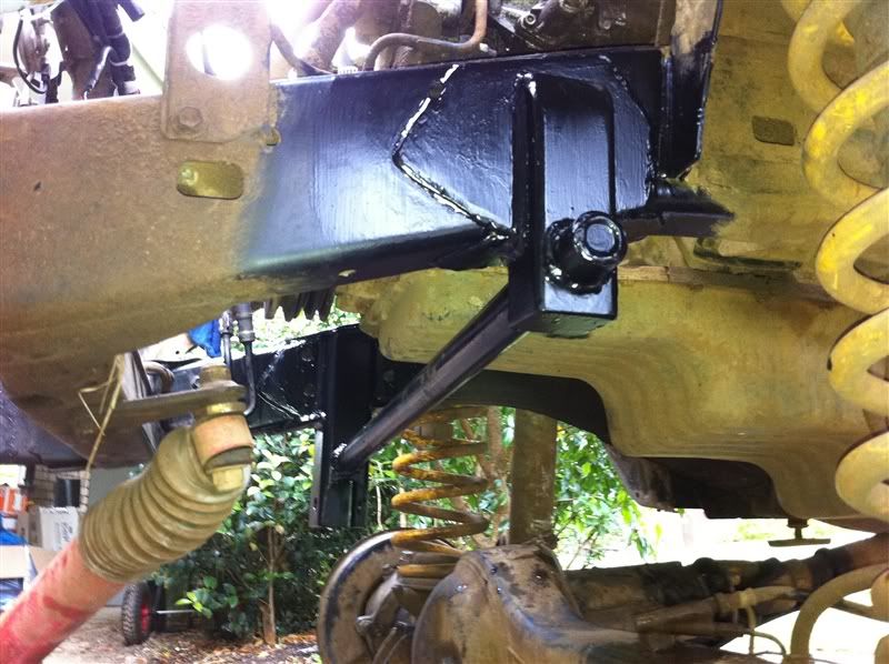

Welded up all of the cracks in the chassis fitted new crush tubes and weld on a fish plate to the outside of the chassis rail

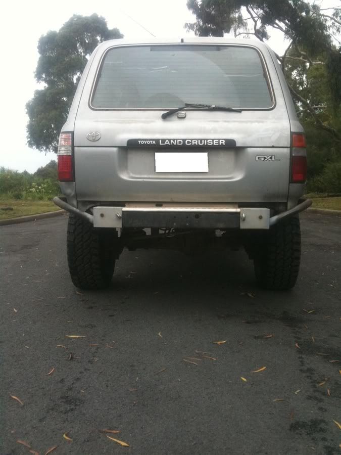

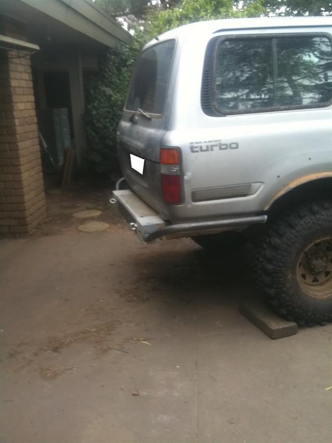

Also have taken some finished pictures of my rear bar :D The light is mounted yet. Going to mount one on the other side as well hopefully will have it done before the long weekend :D

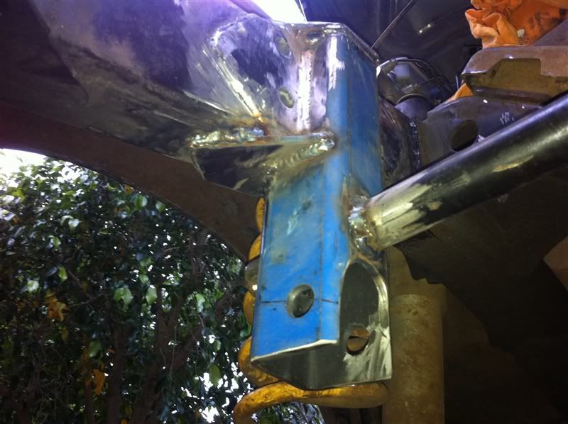

well it was a busy 2 weeks leading up to the long weekend!! had it finished thursday night so luckily i could give it a test drive to work :D AND......
Everything was perfect :D it handles exactly as it used to :D Very VERY happy with it considering it was my first attempt at a control arm and plating the chassis :D
And wow i can now see what the more experienced mean when they say welding on the floor or on a bench is nothing, the real pro's can still lay a perfect bead up side down and out of position!!
It was such a massive learning curve!! measure twice cut once LOL! I was a bit nervous because i didnt do this before i cut out the old mount, i had to do my best finding 80 series at parking lots and measuring there panhard mounts to get the right measurement :P
Anyway enough talking here are some pictures let me know what you think!

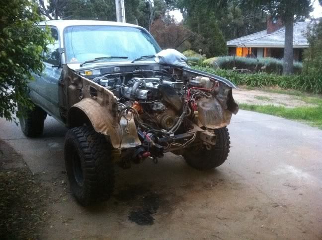

I have spoken to the engineer in regards to chopping this into a styleside ute!!! I chopped the roof off last saturday!!
Anyway car has progressed a bit since the last update.
