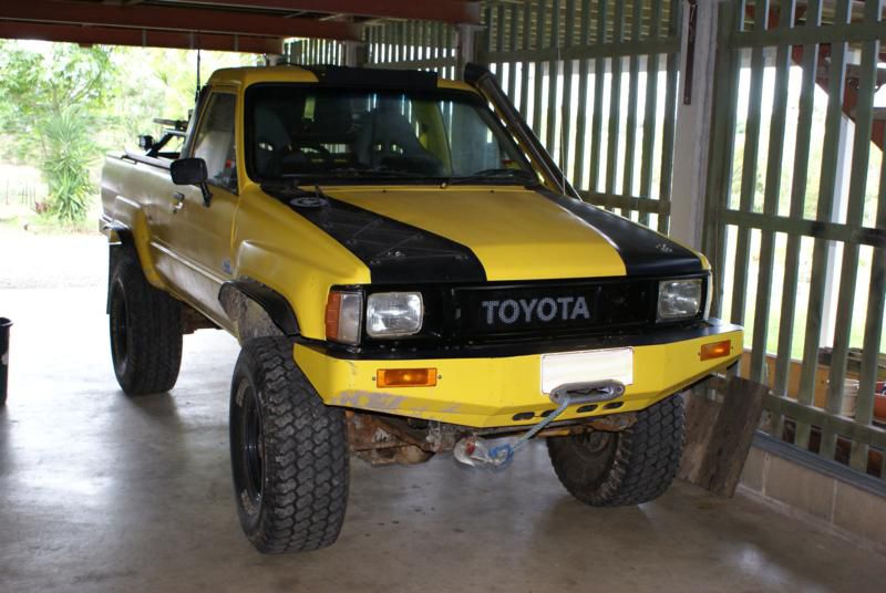

Dammit you've seen right through me! But seriously the math seems to add up.... I just doubt it will have any real world effect...
Yeah, I am liking the badge less look at the min but will see how it looks on the day light!

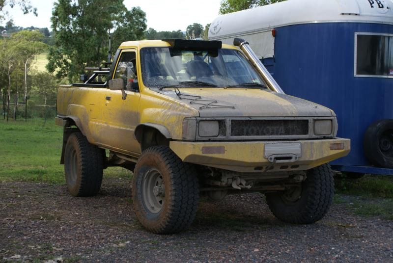

few more pics in daylight

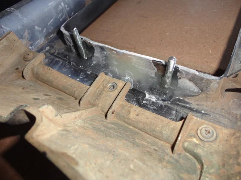

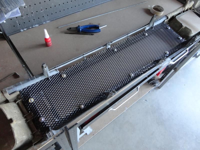

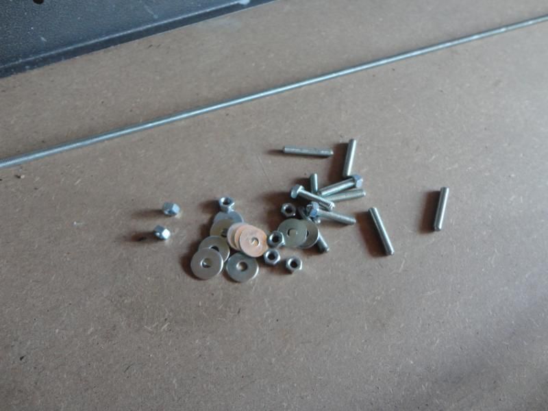

Finished of attaching the Grille today, just a case of cutting some 5mm threaded rod down to 10x3cmm lengths
Epoxy the rods around the inside edges
And bolt it on..

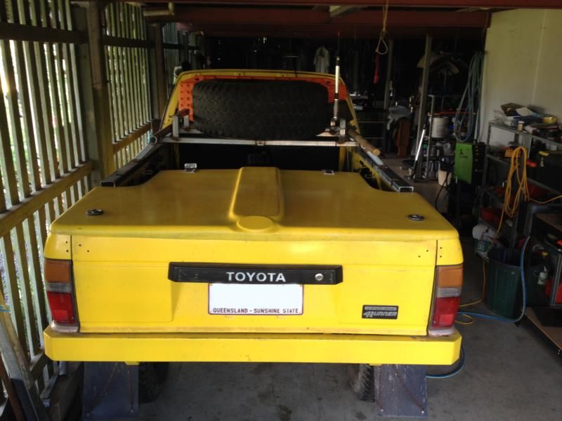

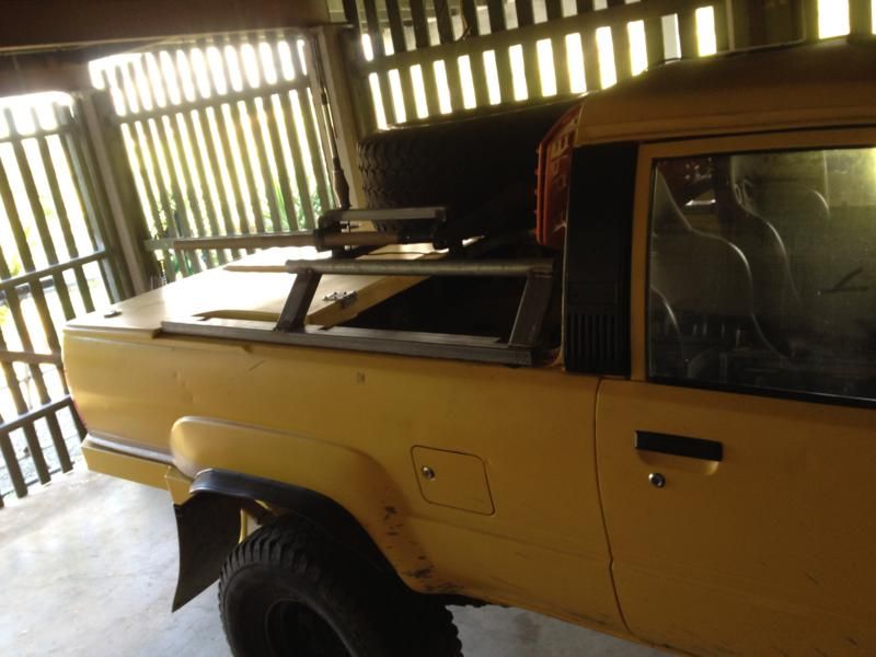

Had a go at the rear rack today, its been bugging me as just not quite right. Don't get me wrong I like'd it full length but it seemed a bit over kill for a play/trails 4b. Plus we have started taking our daily GU Patrol out more when we go with the dogs etc so Piggy is really becoming just a toy.....so.....
I chopped it down so I could put the hard lid back on, which I recon look alot better!

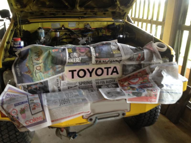

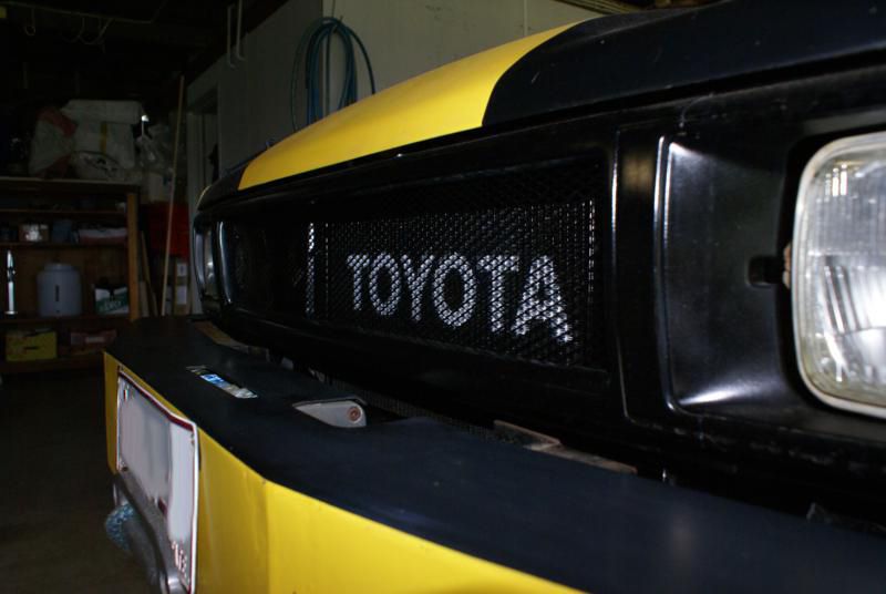

Decided to put a badge of sorts on the front grille...well behind it..
So this is what I went with for the letters....

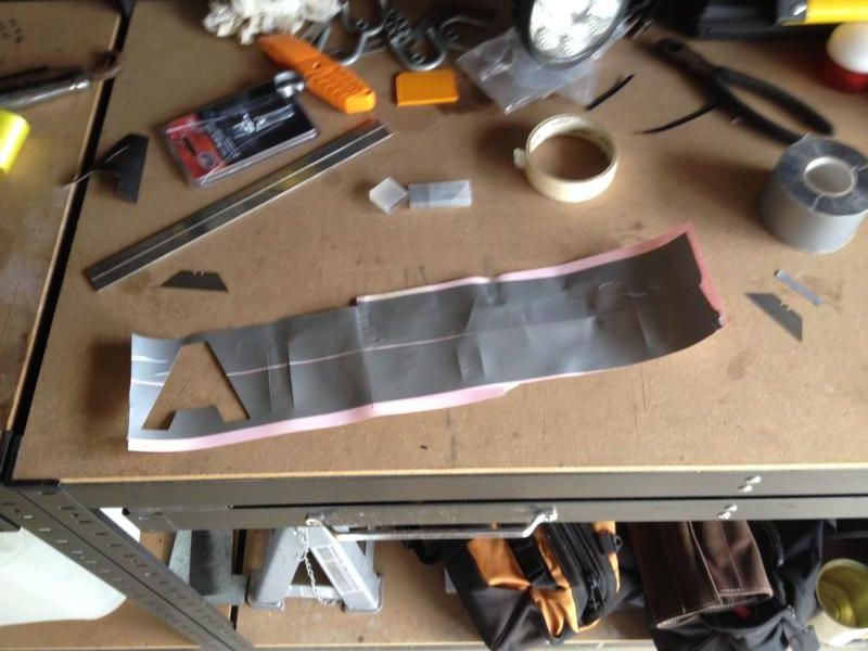

Printed out TOYOTA on two bts of A4 and joined them together.
Taped the back to give it a bit of strength and then cut out the letters with a razor blade
Light bit of spray mount on the template to hold it in place on the radiator and then tape and paper everything else
Spray over with Heat proof white paint (Lightly so not to fill in the fins) and pull off all the tape/paper
Grille back on and looks pretty ok I reckon!

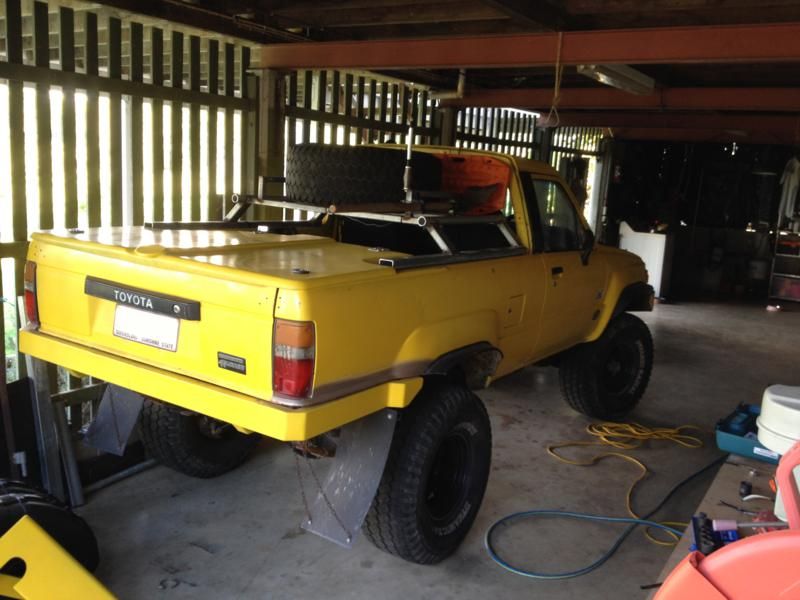

Got the back rack painted up as well as a decent cross bar to attach the rear lid to welded in

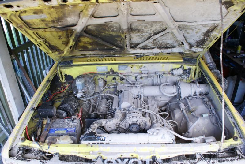

Be interested to see how the K&N filter held up, will open up later and see if theres any mud in there!
