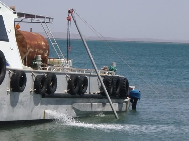

I have constructed a 'gin pole' out of heavy walled (6mm) 100 mm dia pipe.
You can see that it's braced with stainless wire rope backstays.
Image :cry:
It was able to lift this almost 2 tonne Perkins 4cyl diesel and 45KVA genset, with a endless chain out of the vessel and down onto the winching trolley!
But it was set into concrete 2 feet down into the plate coral seafloor base as its pivot/stay point.
The trees supporting your big hammock have no such engineered back stays to support the side strain load. Typically their root system probably only extends to the leaf drip zone of the canopy.
