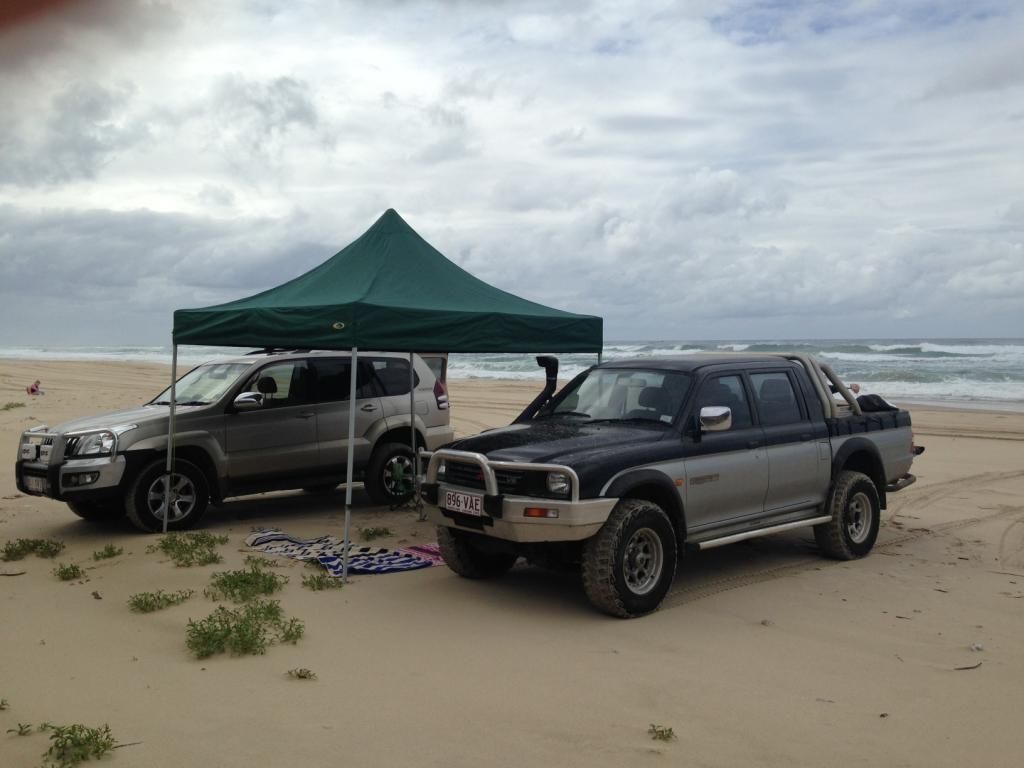

Unread post by jsroberts8 » August 19th, 2014, 7:49 am

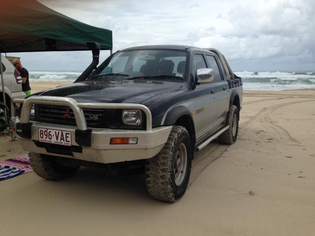

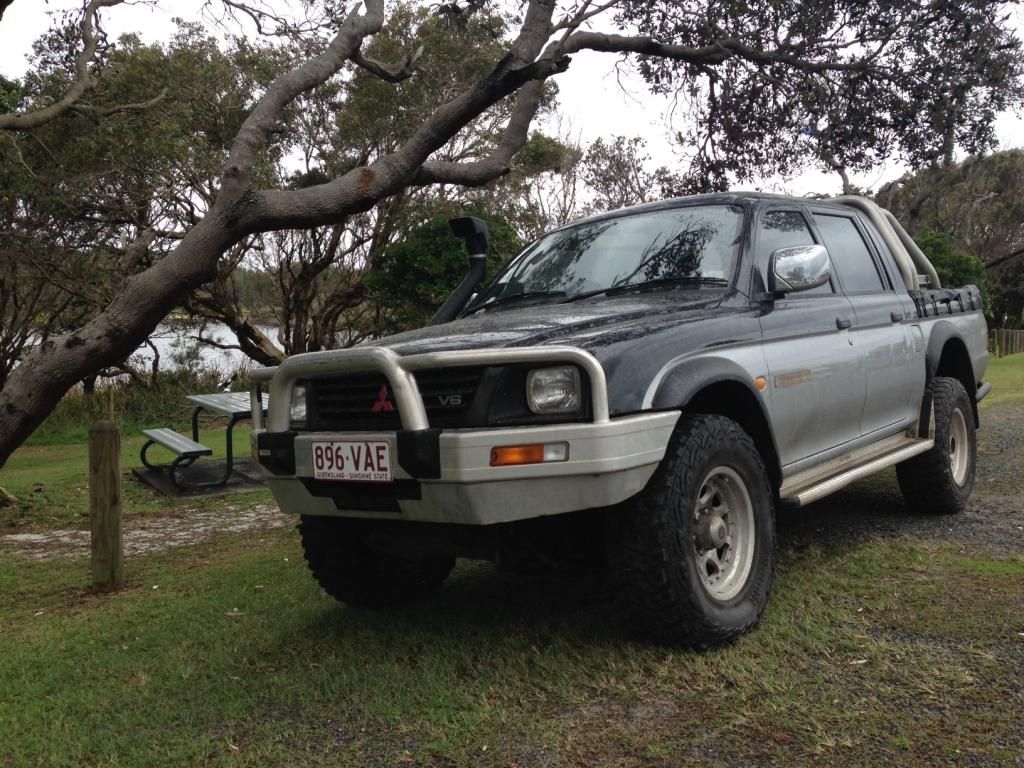

It was time to get the car off road again - this time along the beach. Unfortunately when we woke up it was the wettest day we have had on the gold coast in a month. Kids were packed in and the tires were let down, ready for a good day. Thankfully, we had a dry day and then it poured on the way home, cleaning the underside of our cars! Perfect! Here are a few (boring) pics
Im still wondering about painting the alloy bullbar and sports bar black...or i could polish it up to shiny again - thoughts???

Unread post by Boof mk triton » August 23rd, 2014, 3:11 pm
Said it once and will say it again - polish it!!!!
Looking good man, credit to your persistance when many would have given it away as a bad joke. Kudos to ya mate!!

Unread post by jsroberts8 » August 23rd, 2014, 7:38 pm
haha, yea you do like polished dont you....i was thinking i might try polish, then if i dont like it i can paint it. Much harder to go from black to polished!

Unread post by Boof mk triton » August 23rd, 2014, 9:49 pm
From the pics it don't look too bad. Go to bunnings get some really fine steel wool, like the finest stuf there, and just give it a gentle rub all over (bad jokes inserted here lol), then hook in with the autosol aluminium polish (bout $9 from notsosupercheap) using a fairly coarse but still soft rag ie a tea towel, until it get a sooty style residue. Then get yourself a much finer cloth ie a microfibre thingy then rub like buggery (more bad jokes inserted here :lol:) until it polishes out. It will take a while, but not as long as if you paint it and don't like it! Have a six pack handy - you will drink em all easily in the time it takes to get it done.
