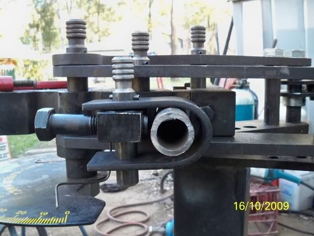

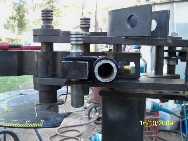

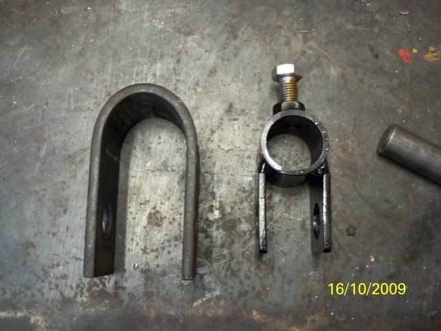

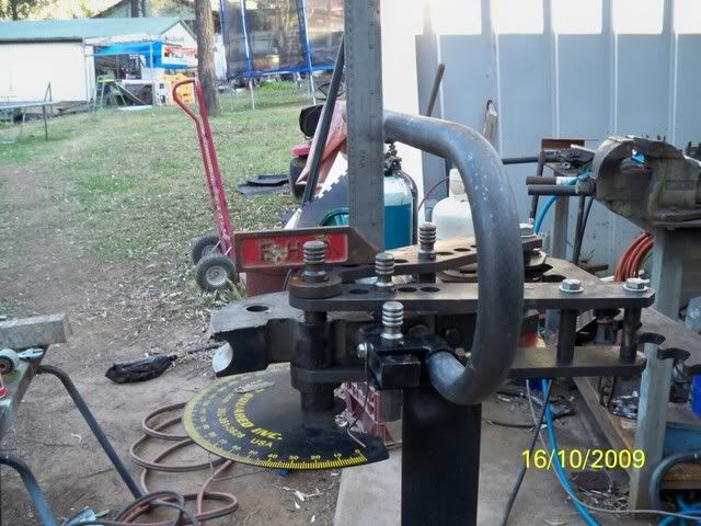

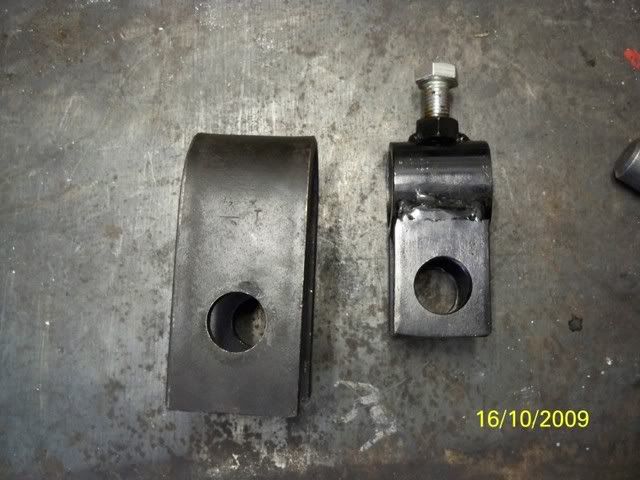

I've found a problem with the way the pipe clamp on the bender worked, it didn't hold the pipe in the die at a true zero degrees, and made doing repetitive angles almost impossible. You can see in this photo where the "strap" would retain the pipe
So I spent too much time making this (going to re-engineer it anyay later)
So now it actually keeps the pipe "true" to the die

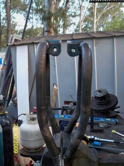

I've also discovered bending compound shapes with single pieces of short pipe is a royal pain in the arse :cry:

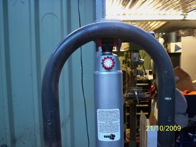

All done, clamped back to back so you can see the offset

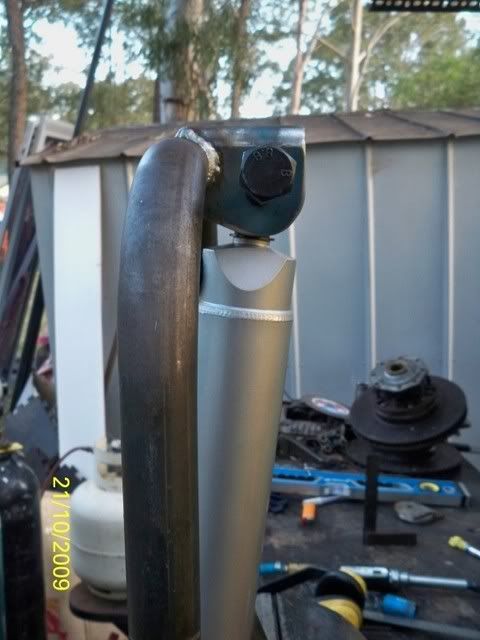

Closeups of the shock mount
I've done them in such a way I can add a brace or bracing and coilovers at a later time, that's why the mounts look a little bulky. should have them welded on tomorrow, then time for front tubs :crazy:

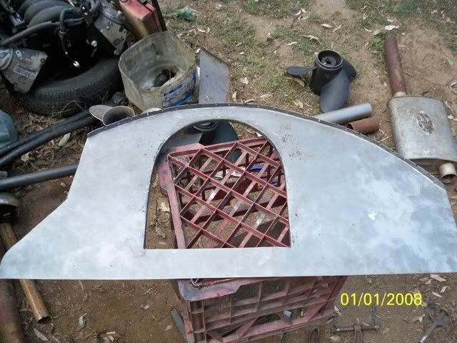

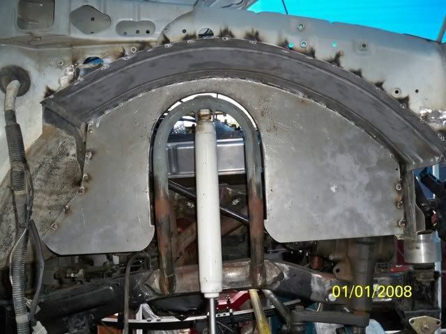

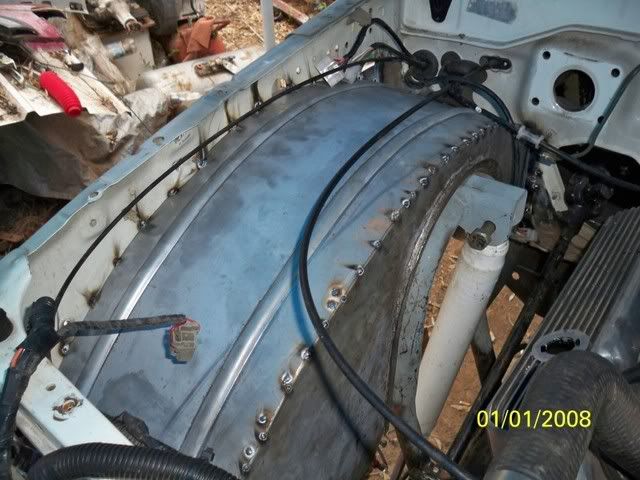

I've nearly finished one wheel tub, something I've been putting off as I REALLY hate hand forming panels.
I think that it's tuned out ok, still have to add a scallop for the booster, but the main part is done

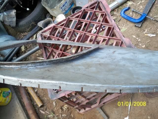

Started with some 0.9mm zinc coated plate
Hand formed the flange around the shock hoop, it'll have a sheet of rubber attached later over the back side of the hoop.
Also the flange where the top side will meet the inner
Pretty happy so far :)
