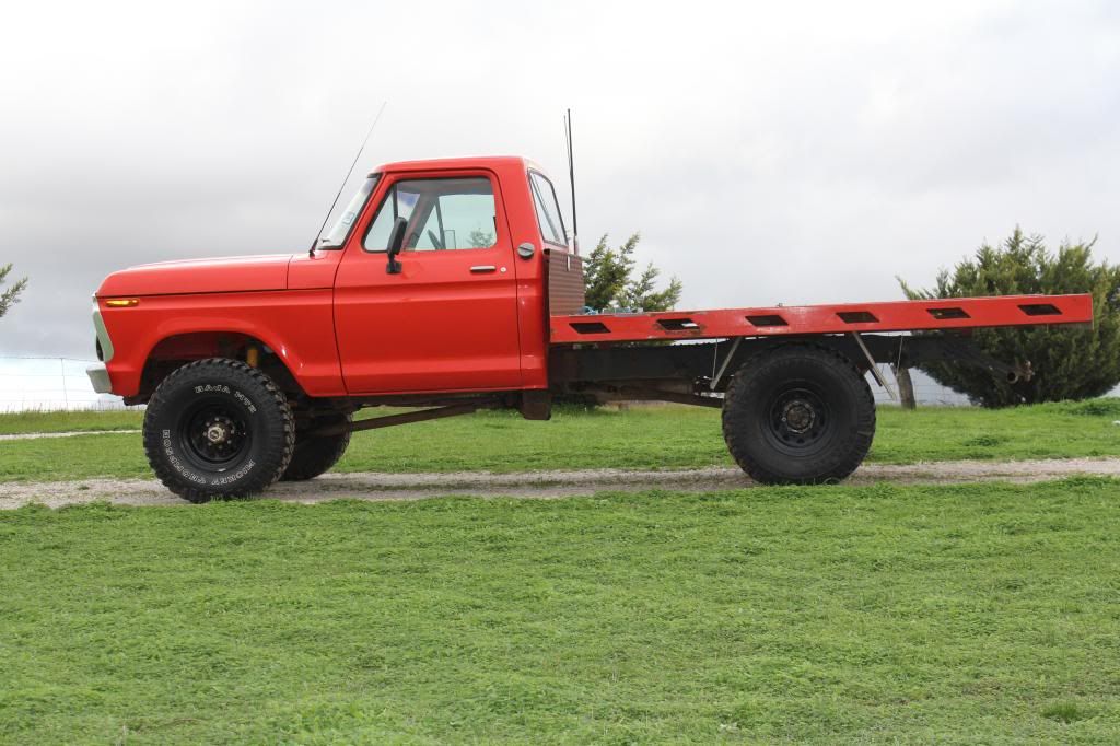

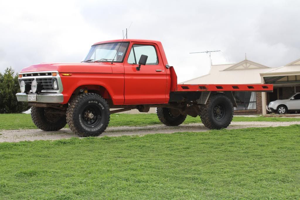

Hey all.
The new project is under way. I have a 74 F250 high boy (4x4). As it stands it has the old 300 ci Canadian six in New process 4 speed and un married transfer case with Dana 60 rear and dana 44 front diff. I have a written off (cab fire) 06 F250 4x4 that's running gear will be ending up in the high boy. The 06 is a 7.3 power stoke. 4R100 auto with sterling 10.25 rear and dana 60 front diff. Should be a good fun truck once finished. I have started cleaning up the cab. Its not in bad condition for its age. So far all I have done to it is a set of 315 75 16 Mickey T MTZ's. Which i love. Awesome in the mud. Just given the cab a good buff and polish and started ordering all the bits and piece's I will need. Won't be a 5 minute build, got alot of work ahead of me. But hoping to try and have it on the road by this time next yr. Fingers crossed.

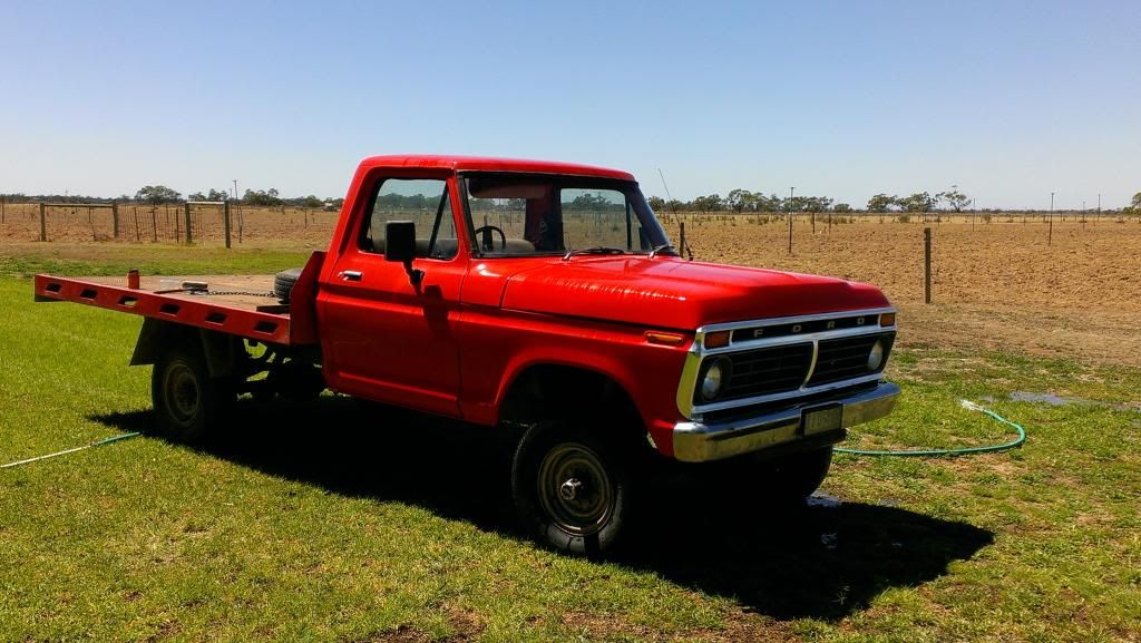

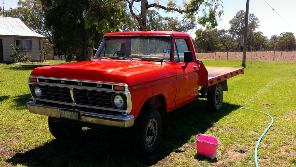

The day I picked the old girl up.

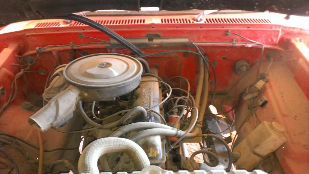

Rear diff
Front diff
Trans
Engine.
Excuse the mess in the shed. I need more room. One good thing is the boss has given me the go ahead for a bigger shed. :):)

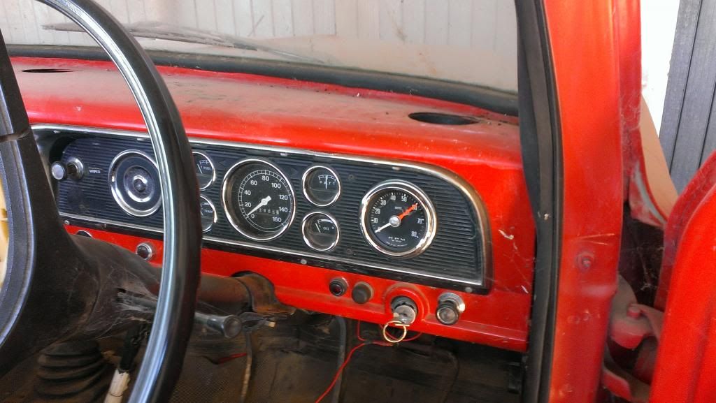

Now that will be a great conversion! Should be pretty straight forward as far as rego legalities go too.
The hardest part will be grafting in the new instrument cluster and keeping it looking like old. There's a lot of electrics to deal with but it'll all be worth while and you'll have a great capable rig that's easy to live with. Worth restoring the cab with all new rubber seals and under-felt etc to make it like new again. Good luck with it.
