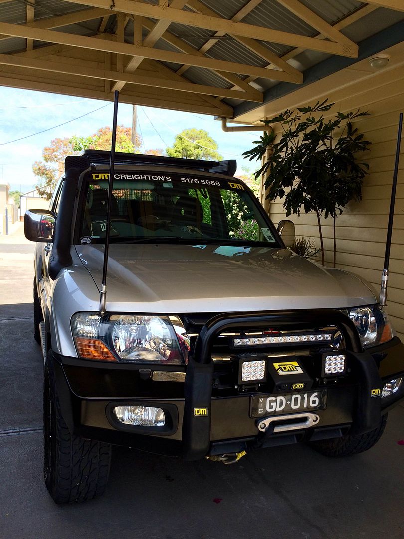

...one more: those skinz protector plates do look like a worth while addition and not too expensive also, but surely after use dirt is gonna get packed up in there.
Does that mean I need to take them off after each trip for a clean out?

Bushskins bashplates are great mud doesn't seem to get caught up & the little that may is easily hosed out as you can see from wheel arch.
Guss. ;)

Also, am I right in saying that the Bushskinz are easy to remove should I need to for cleaning? Looks like they would be to me from looking at the pic. The front plate is designed for intercooler protection but would you still recommend for use on a petrol engine? Pretty small $$s either way so why not...

Yes easy to remove bash plates, just make sure they don't use a rattle gun to do them up!
