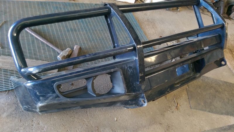

Fter a lot of stuffing about I decided to recycle the bullbar that was on it when i got it. Figured the best way to remove the dent was belt it with a FBH and then cut out the offending dent and fill it with ARBs fog light inserts
